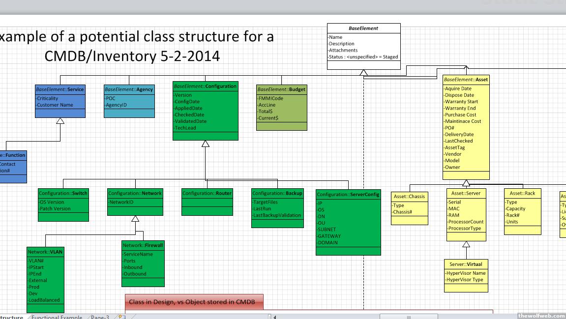

Question about DB design myself.
I'm basically making a poor mans CMDB, yes i should use an open source one, yes this is not a sensible project.
Go ahead and forget reasonable things for a bit, lets just assume that none of those things are options, and that I beleive that using a COTS or Opensource solution would be vastly superior than trying to build one in cost, time money, energy and everything else.
Right now i'm using 2 tables CI and Attribute, I might extend another table called Relationship, but right now those are stored in the CI table.
Is this sensible? It needs to be easily extendable, I.E. tomorrow we might need to add a new configuration for example Mobile device, that may not fit in the other classes.
Class struture shown here

I would create a CI called Location, which would have a parent of the base/root element.
I would then add attributes that describe a location for example State, City Zip.
So the CI has a 1 to many relationship with the attribute table.
CI
Type:Class
Attribute Table:
Value:
Owner:1
Value:
Owner:1
Value:
Owner:1
Template CIs for example the 1 above would be marked as a "Class" in the database
So for example, I define a Class in CI called Location and mark 3 attributes as belonging to that class.
Now that the Location "Class" is defined in the database, you as a user can create a new "Location"
I.E. you have a drop down that populates all the CIs that are marked as class (ex Server, Location, Agency) and you chose "Location" then create new.
It then adds a new record to the CI database and 3 new attributes that relate to it
CI
Type:Location
Attribute Table:
Value:NC
Owner:2
Value:Raleigh
Owner:2
Value:27606
Owner:2
I need to be able to create these "Classes" on the fly, without creating 20 different tables, and within a given class, expand out the attributes that I track.
EX, tomorrow i find out that we need to have a new attribute for locations, lets say "Is Large"
I go into the database and do the following in the attribute table
Attribute
Value:
Owner:1
Now Location has 4 attributes, State, City, Zip, and Large
Now Raleigh doesn't currently have a "Large" attribute, but once i update the "Location" class i've got a process that goes though all the records of type "Location" and copies the newly added attribute to them. Values are usually blank, but for example if I wanted a default value of "No" then I would set that attribute value at the parent.

^Why not use MongoDB for this? Seems like you're explicitly going to have a dynamic schema, which is going to become a fucking nightmare to manage as soon as you turn this on if you're using SQL Server.

Why is it going to be a nightmare to manage in SQL?

Also is his DB setup any better than just using normal relational DB tables...eg: computers, places, projects, etc?
