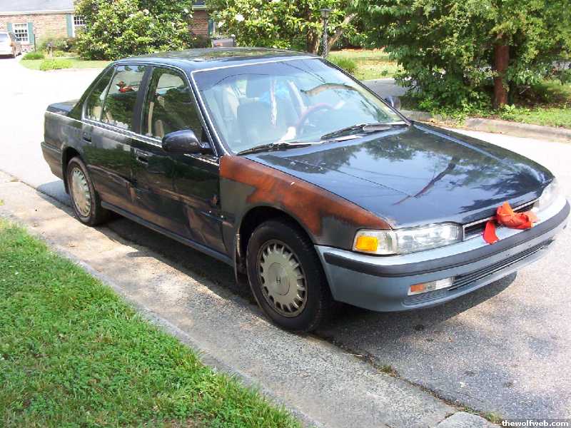

My car (4-door 91 Accord) shakes whenever I drive. The steering wheel vibrates, as well as the seat, pedals, and floor. It's been like that for almost a year now. A couple months ago I got the tires aligned & balanced and the shaking stopped for a bit, but it soon returned to its old ways.
Recently the shaking seemed more severe and I could feel a rhythmic "bump bump bump" under the floor in addition to the usual. It made me pretty nervous and I haven't driven since. The car was in a minor accident before I bought it (bent fender/door), so maybe there was some frame damage?
I'm worried that this problem will be very costly to fix Also I'm worried that if I drive anymore the car will shake itself apart. Any estimates on what is wrong / how much to fix / how dangerous it is to continue driving?

does it happen only under acceleration? when you're moving? at idle?
Is there something you can point your finger at and say "its worse when I do <this>"

The wheel vibrates faster when I'm going fast, and slower when I'm going slow. The wheel doesn't move when I'm stopped. Acceleration and going up big hills usually makes the whole car shake worse, but not always. Changing gears has no effect.

usually a thumping is gonna be a tire problem, a fast vibration is gonna be a wheel bearing, and a violent shaking is a bent rim

I've had the same tires for 2 years, but I don't drive much so they have about 15k miles on them, would that be enough to cause uneven wear? they haven't been rotated
"are there any particular speeds at which it is markedly more or less pronounced (in amplitude, not frequency)?"
Sometimes on the highway the car will stop shaking or will shake less violently. Doesn't seem to be speed related though, it sometimes happens at 55, sometimes at 75, or in between.
"alignment."
yeah I tried that, but the problem came back in a week or so. Also the steering wheel tends to pull to the left, I don't know if that has anything to do with it.

k so I took it in, turns out my rims are bent
they're going to charge $100 apiece to replace them, not sure if that is just parts or if labor is included

Also, are they telling you they're all bent? Though I guess x could have been bent before (when it was shaking before you got alignment/balance), and y were bent in a different incident, causing your recent worsened shake and bump-bump-bump...
