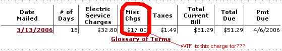

The lights in my new apt got turned on in my name on 02/21, and the billing cycle ended on 03/10, and I have a $51.29 power bill, and I bearly have anything on here, eg. lights, furnace. I read somewhere that there was an unreasonable increase of power cost after the new power meters where installed in this area, so I was wondering if anyone else had this problem. I just cannot bring myself to believe that I created a power bill that high in 17 days.

Post your itemized bill. You probably just paid a fee for getting the power turned on.

Default
998 Posts
That is the point, I HARDLY have anything on. I live by myself, and I might turn the heat on for 20-30 minutes a day (some days I don't use it at all), and use one lamp with a 60 watt bulb. Other eletronics, TV, XBox, etc., maybe plugged in, but I am not playing or watching them 24/7. I lived in an apt with 4 people before and the bills was 80-100 a month, so this is absurd.

Default
998 Posts
I did not think of that, but I did pay a $128 deposit, and I do not recall them saying that I owe any connection/transfer fee, but that sounds logical.

Default
998 Posts
$32+ is still steep for 18 days, in my opinion. But what is that charge for?

Default
998 Posts
Yeah, but what is the $17 dollar charge for?

Noen
31346 Posts
connection fee.
and 38 bucks aint bad for a 4 person apartment.

Oskar
4822 Posts
i ran into this too! just moved into my new apt... 14 days of electic service = $47.04
not counting the $17.00 connection fee

hammster
2768 Posts
i dont think that sounds that bad. yeah everyone gets charged that 17 connection fee

Patman
5873 Posts
Yea, most people's bill has gone up with the new meters, including mine. They say that the new meters are more accurate than the old ones, but who knows...

Spike
2249 Posts
yeah the $17 is the connection fee in NC. $32 being high really depends on alot of things. Where you live, the heat system, water heater, insulation, etc. It's hard to compare one apartment to the other because it depends on a number of things. How big is your apartment? square ft? bedrooms? how old?
The deposit is supposed to be in theory double the average bill at that location over the past 12 months, but that could also be lower than that depending on whether anyone has lived there in a while or if it has been on in the apartment's name.
The meter could be increasing the bill, but that's not always the case. Since you just connected in February it's hard to say if that is what did it or not. Some bills have gone up because some of the older meters were older and running slower than they were supposed to be, or that's the argument. The rates went up just a bit a couple months ago but not a whole lot. You can also call and get an average and high and low bill over the past year.
