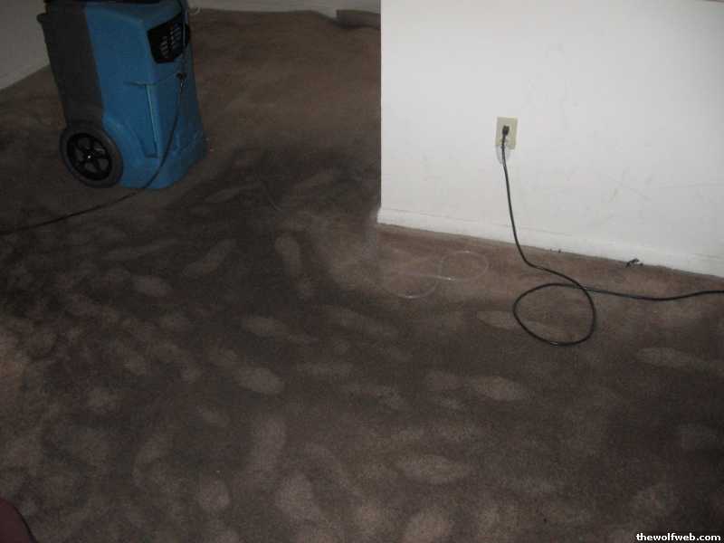

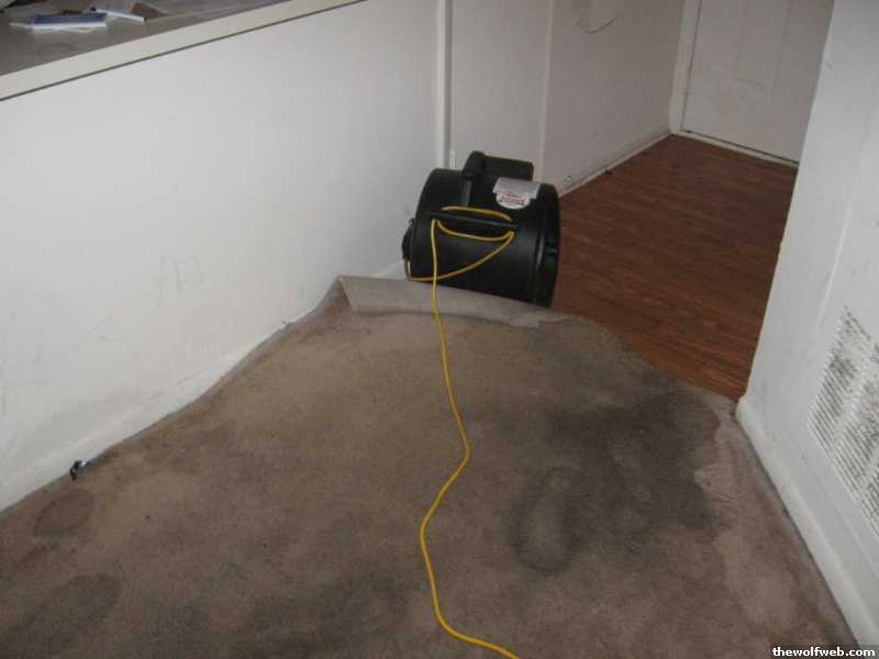

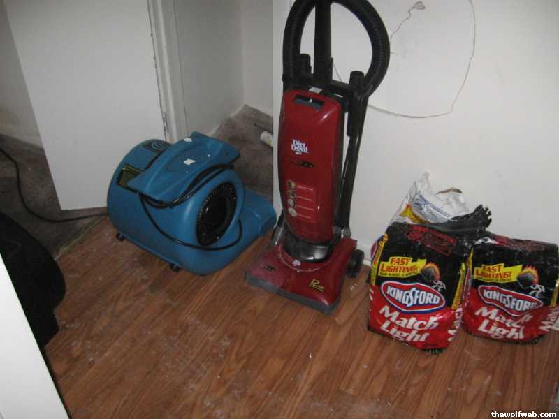

I awoke this morning to a fucking flood in my apartment. Apparently a pipe had busted last night. So i tell my apartment office about it and all they do is bring in the blowers.
So I guess thats all they are going to do. Aren't they suppose to replace the carpet? can I get out of my lease now? this is rediculous.

That looks pretty fucked up right there. And it's ridiculous too.

"Aren't they suppose to replace the carpet?"
no. they are required to dry it like they have done unless it is permanantly stained or continues to smell like mildew. then they must have it professionally cleaned.
"can I get out of my lease now?"
why would you think you could get out of your lease? shit happens. i hope your not one of those dumbfucks who is too cheap to pay for renter's insurance since it's only like $12/month. you do understand that if any of your personal property was damaged, the apt. complex has no legal duty to cover any costs of replacement, right? get renter's insurance if you don't already.

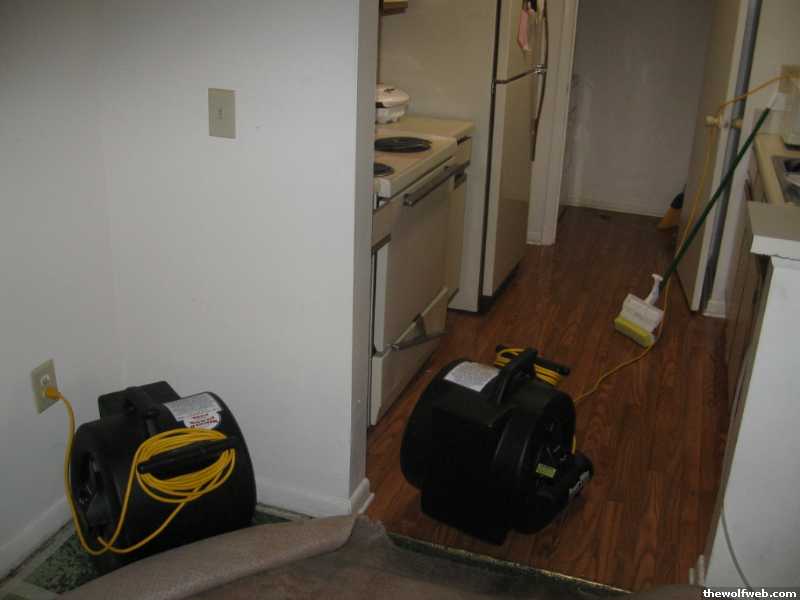

Day 2:
Water is still leaking from the ceiling.
Fans are still blowing.
Im curious as to what about our power bill?

did they plug in the fans to your outlet?
2/28/2006 11:15:40 AM
Novicane
15432 Posts
^ yeah. Like all 4 fans ran all day, all night, and now all day today.

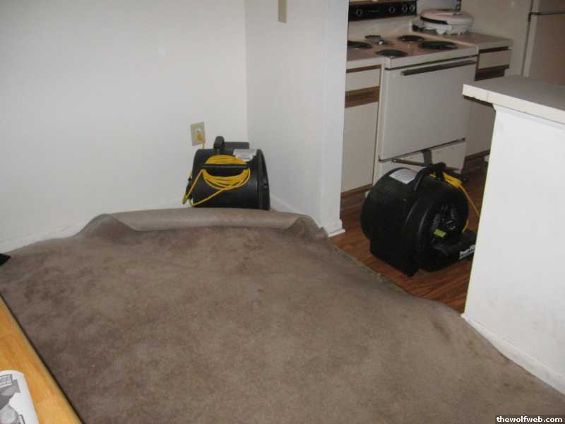

1st or 2nd? If you are on the second floor, you might need the subfloor replaced. The carpet may be salvagable, but that can only be determined after it is dry.
Fans and dehumidifiers can work wonders in places such as that. There should be at least two fans and a dehumidifier in each room that has damage though.
Watch out for mold and mildew, as well as drywall damage due to the water. I bet your drywall has water at least a foot high.

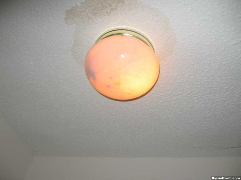

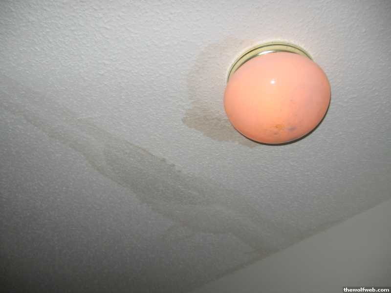

Update:
They came back and finally cut a hole in the ceiling. Water wasn't coming from a pipe, but instead from the apartment above us. The guys above kept using their dish washer that leaked even after the fact they knew it leaked.
They are still blow drying the carpet and have brought in a humidifier.
Oh, that light fixture in the pics above, was filled with water.

Second. From the pictures, I see the dehumidifier. IF that is what they are using, you probably want 1 in the center in each room, and two or three fans circulating air. The fans are not used to dry the carpets.
If you are running the Heater or AC, stop. Keep the doors closed as much as possible.
That place is going to need a lot of work.
If the dehus are working, your place should be very very hot. When it is nearly dry, it will be like a sauna.

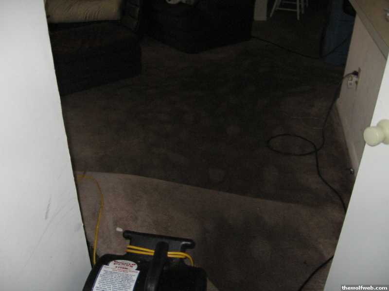

Day 4 Cont.
Making head way now. Three mant guys came over this morning.
Water was coming from two places: 1. The guy's above us washing machine. They kept using it even after the apt complex told them not to. 2. There is a cold water line (that always has pressure) inside our bar wall where it runs into the conrete and runs under the apartment. They sawed a hole in our counter and saw the leakage.
They wet vacced and now have tore up the carpet. They have finally given up on drying it.
We are getting new carpet, new dishwasher, new fridge, and possibly new oven. 4 days of solid bitching has paid off.
