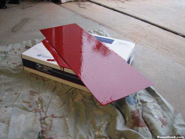

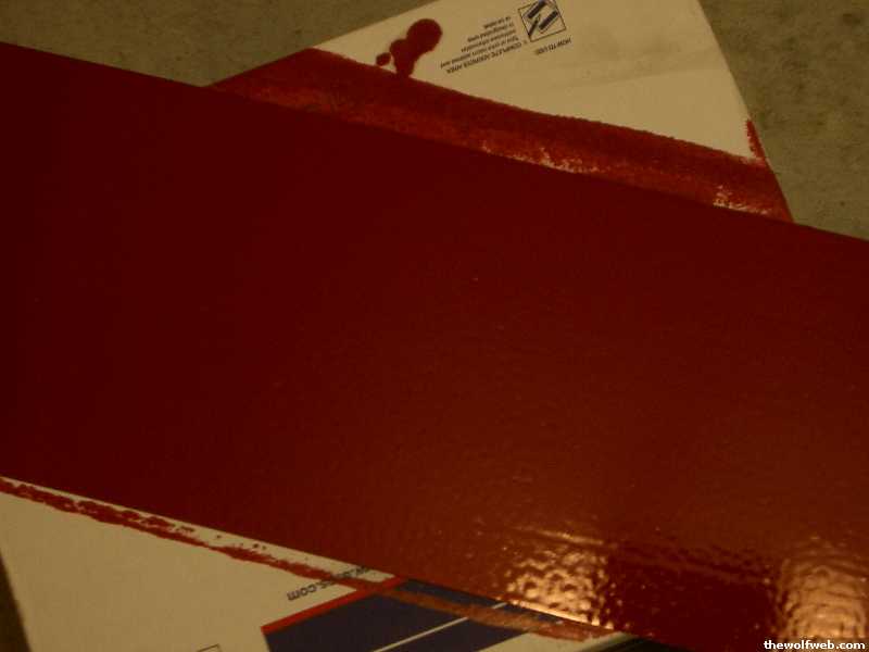

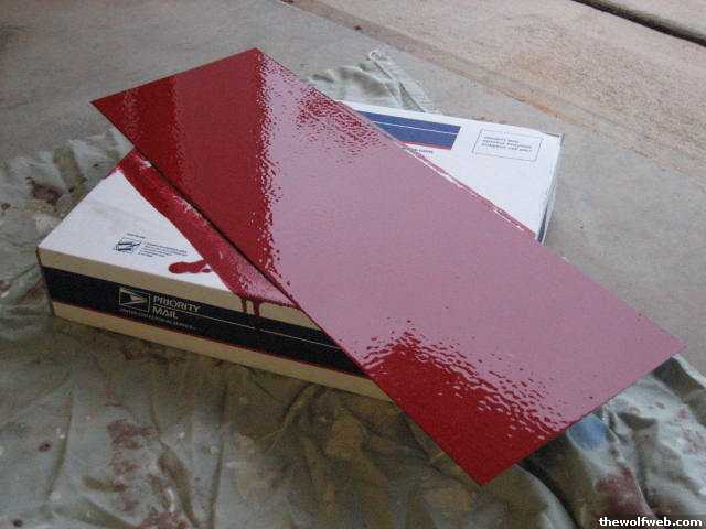

here's the pics of the mess:
I thought I used plenty of mineral spirits, it was pretty thin, but it came out pretty bumpy looking. When I try again later on the other side, I'll thin it more.

2/25/2006 6:32:01 PM

^^did you even sand it?

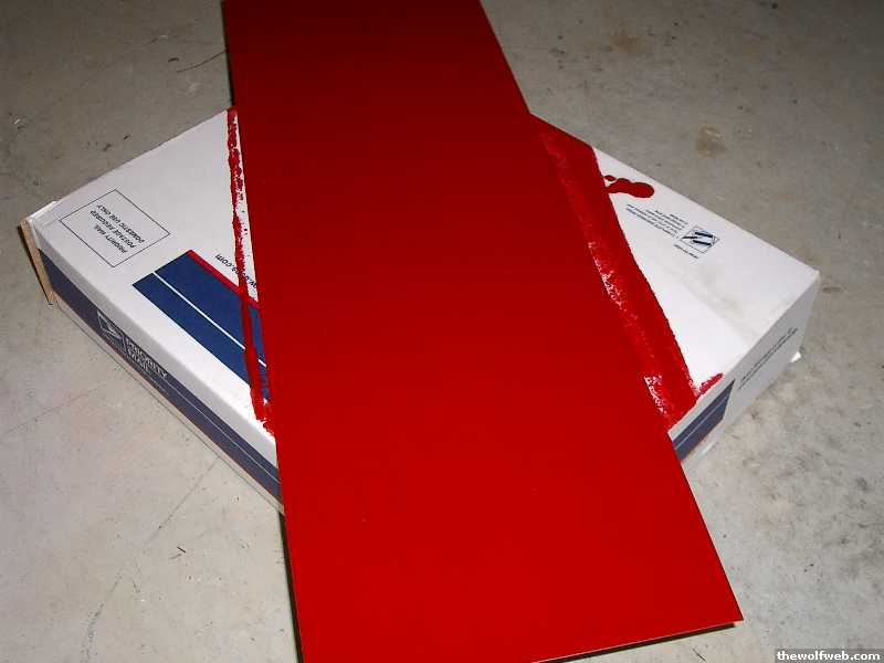

You'll probably need to mix it at least 50/50 with possibly even more mineral spirits.

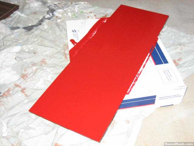

^^I've only put on the first coat, when it's drier, I'll sand and do the next.
ok, well, it looks better, less bumpy, this pic my gf took doesn't show it very well....

yeah, I used rustoleum royal red. gorgeous color, somewhere between a light cranberry and the blood red BMW used to put on the M roadster, but I definitely needed more mineral spirits, and I also want to see how much sanding it can help. I didn't get a chance to try that before I skipped town. I thought I poured a lot of mineral spirits in, but come to think of it, it probably wasn't anywhere near 50%. It definitely did lay down more evenly from the bumpy first appearance a ton after a night's drying, and everything I used is in raleigh right now, so I probably won't take another crack at it for another week at least (I'm working in VA), but it definitely needed more mineral spirits, it was still too bumpy by far...
