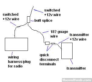

arghx
Deucefest '04
7584 Posts
Correct me if I'm wrong on this...
There's going to be an ignition switched power wire that goes into the stereo wiring harness. So you could splice the switched +12v source with another wire. At the end of that wire you could use an insulated quick-disconnect terminal, male or female, which you could then mate to a wire cut from your transmitter.
All you need is a wiring diagram (or some guess-work) to locate a switched +12v wire, a wire cutter/crimper, and some connectors from radio shack or auto zone.
Repeat that setup for the ground wire.
