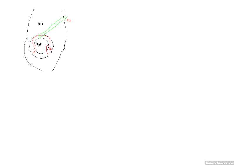

does it have a clip on the shaft? most do.
2/4/2006 9:43:57 PM
69
15861 Posts
theres a u shaped cilp on there, push the door panel in a bit to see it. take a pick and hook the closed end and yank it off. then pop in in place on the door handle before you put it back on, and press the door handle on

jatncstate
724 Posts
2/6/2006 9:55:19 AM
beatsunc
10885 Posts
^ the guy in that pic is going at wrong, should rotate the tool 90 degrees
