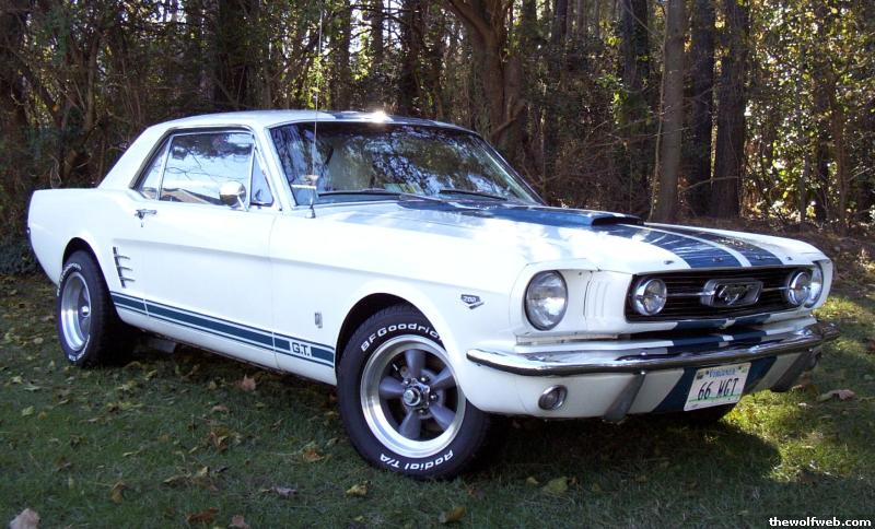

15861 Posts
still doesnt address the fact that that much water shouldnt be getting in there in the first place. a little water on the floorboard of my 66 stang turned into 2 weeks of cuttting and welding new sheetmetal in the cowl, along with rocker panels, floorboards, rear quarters, and front inner fenders. looked good when i bought it, but it took less than a year for cancer pinholes to rear their ugly head. pissed me off, it was solid all over besides a few problem spots i ignored while i was building up the drivetrain, and it went to hell in a handbasket quick, it was worth it in the end though, god i miss that car, all those hundreds of hours of my life gone now.
