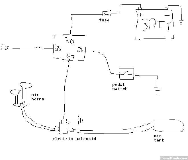

drewt
86 Posts
it may be shorted out wiring. A lot of cars (esp. Jap cars) switch some things (like headlights) off the ground instead of the positive. I think there is a reason, but can't rember why.
Can anyone confirm/deny this? I'm not positive, but I think so.
11/9/2005 4:55:59 PM
zxappeal
26832 Posts
Yep. All Datsuns are like this. I'm not really sure about the newer Nissans though.
11/9/2005 6:52:48 PM
underPSI
tillerman
14088 Posts
^^it prolongs the life of the switch if you break the ground instead of the common.
11/9/2005 6:55:03 PM

^ I don't see how it would be any different than switching the positive side of the circuit.
Most things these days use relays to take the load off of the switches...
11/9/2005 11:24:35 PM

drewt
86 Posts
if it switched ground and the wire shorted aginast something metal it would be connecting to ground....can't think right now so i don't know how that would affect it, but it may. just something to check
11/10/2005 3:10:02 PM
underPSI
tillerman
14088 Posts
"I don't see how it would be any different than switching the positive side of the circuit.
Most things these days use relays to take the load off of the switches..."
because there isn't any electrical current sitting at the switch. it is breaking the ground.
that's why it is advised to disconnect the negative first or connect the negative last when doing any electrical work with DC voltage.
example. here is a quick schematic drawing i just did to show how i wired up the electric air valve for the air horns on my truck. i used the pedal switch on the floorboard to break the ground off of the relay so there isn't any current sitting at the pedal switch which will keep it from burning up.
11/10/2005 6:41:18 PM

Poe87
1639 Posts
^^ you used a relay to take the load off the switch. The same current flows through both the positive and negative of the powered circuit. Thus, if you switch the wire directly to the powered thing, the switch will see the same current whether it is on the positive or the negative wire. A relay is the only way to lessen the load on the switch, which is what you've done and what you are talking about. And, it doesn't matter if you switch the positive or negative on the relay turn on coil either, it's the same low current either place. The reason they say to take off the negative battery cable first is to prevent arcing the wrench to ground when loosening the positive cable.
