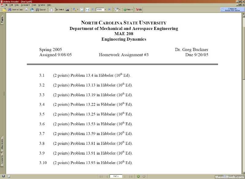

here ya go
9/18/2005 1:23:16 PM
Toby_dog
165 Posts
Thank you so much!! is the site back up?
