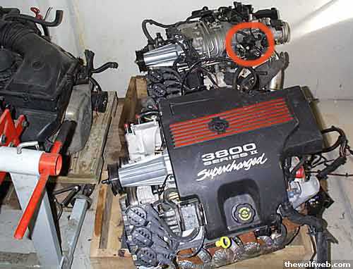

there is this black plastic vacuum pot that has one vac line going to it
i desperately need to know what this is called
and no, its not a NGR valve.
it appears to possibly control a flap in the inlet to the SC downstream of the MAF

directly in the center of the orange circle

black thing in top left of photo

is it the pressure switch similar to a wastegate on a turbo setup? (guess)

OK! its the "boost bypass valve"
now if i plug the vac line to eliminate any leak will my car be driveable? this would only be temporary untill monday when i can hopefully get a new one.
i broke off the connection for the vac line

should be ok to drive easily. it's just a valve to bleed off excessive boost when you're on it and to relieve pressure when you lift the throttle quickly. very similar to a bov/bpv on a turbo car.

well i superglued the lil bitch and it seems to drive ok so far

$52!

the $35 valve was actually the solenoid, the actuator itself is $192 god damn dollars
thats half the price of a rebuilt SC !
