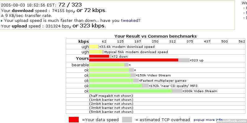

Our roadrunner however has still been shitty as hell. I regulary ping about 4300ms on World of Warcraft. not to mention the disconnects every 30-45 minutes. I also get kicked of AIM every couple of hours. Webpages load horribly slow, and downloads from any number of servers go at like 5-15kb/s
I just ran a speedtest on DSLreports.com and got 72k down and 323k up Compare that to your standard 56k modem... ugh. So much for "70 times faster than dial-up." What the fuck?
Here are some facts about the setup, I dont know if they make any difference but:
1. I am running about a 20ft coaxial cable from the wall to the modem, since it is across a room. The plug also has a splitter running a coaxial to a television that is getting standard cable. I did this same setup at Centennial Villiage apts and my internet ran fine there, so I dont know.
2. I am using a Linksys Broadband router, could the throughput of this router be horribly shitty? I will try directly hooking the modem to my computer and see.
3. My girlfriend's computer is also hooked up, but she isn't using any bandwidth at all, and she also has disconnect and latency issues.
Anyway, I am having a tech from timewarner come out tomorrow, hopefully we can get this figured out. Any ideas would help though, thanks.

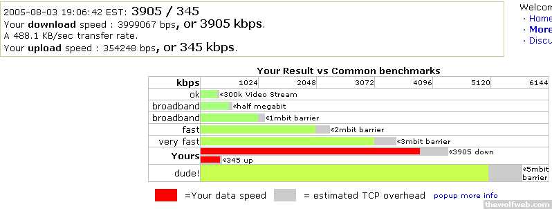

So, I removed the splitter, and:
... what the hell? I guess I didn't realize how much splitters impacted the speed of the service. Is there anyway I can get a quality splitter that won't do this? I would really like the television working in this room and we only have one coaxial outlet.
