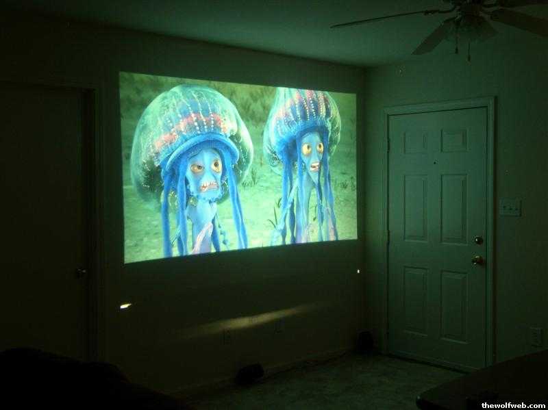

Quinn and Stein's projector will take the motherfuckin Pepsi challenge with any HDTV you kids could wish to buy: Plasma, DLP, LCD, CRT or LCDP and win in nightime movie viewing.
Consider that our small PIP screen equates to a 28 inch TV before coming up with a retort.
Furthermore, the movie quality is excellent, especially with 1080p...er wait, you can't compare 1080p can you. No HDTV you could possibly afford plays that format (or downconverts it). Regular TV viewing is also fairly spectacular, especially on any of the HD channels that matter. I personally can't wait to catch some football games in HD.
As for "ugly furniture", our projector which was built by Quinn is actually suspended from the ceiling in a custom made box. The box is fairly large because we didn't want to do the mirror reflection math for a more effecient design, but its definitely not an eyesore.

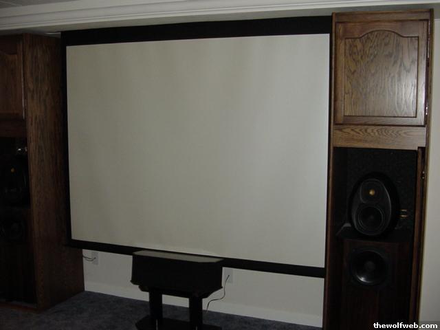

SandSanta
22435 Posts
Projector is the black thing in the top left.
Partially completed Cinema screen.
Old picture without screen or any image quality adjustments.

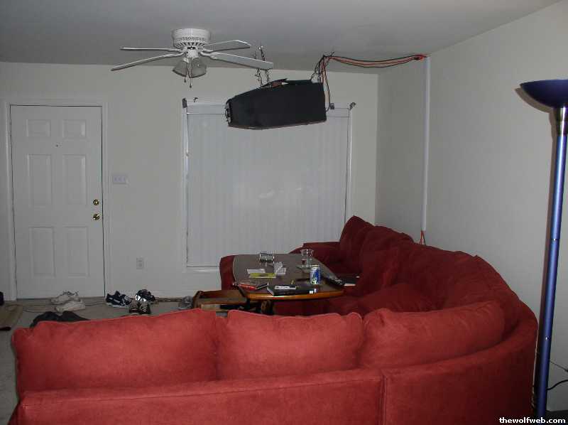

Shot of my dads projector room.

Stein
19842 Posts
The projector hanging from the ceiling. We should probably do a little more masking for the wires.

TypeA
3327 Posts
How heavy is it?
8/4/2005 1:10:49 PM
Quinn
16417 Posts
30 lbs maybe?
