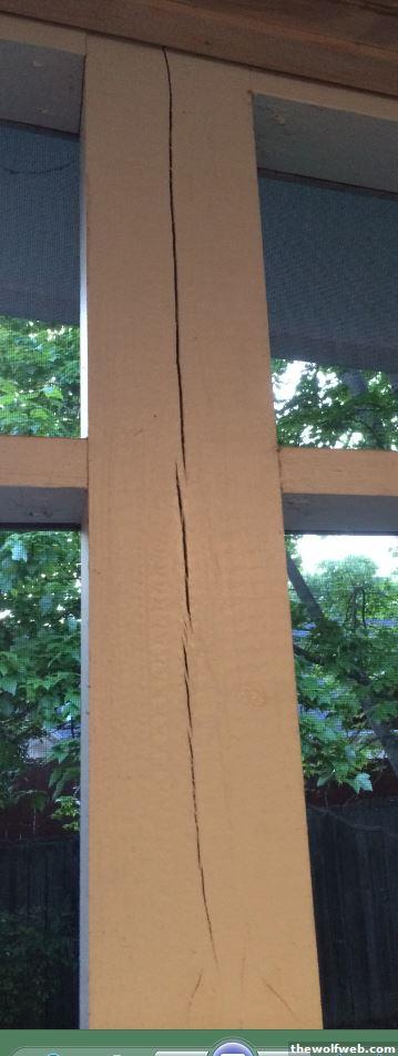

Now I have a question about outdoor wooden columns. I had a screen porch installed ~3 years ago. I've noticed some surface cracking on some of the wood and hadn't really thought about it. Now that we're getting into warmer weather, I noticed this on one of the 4x6 posts.
Something to be concerned about? I don't think it's all the way through, but I actually can't tell because we have strips installed in the middle on the outside.

35761 Posts
no, i wouldn't worry about it
5/7/2014 9:14:41 PM
Nope, that's normal cracking from drying and stress. Fill and paint if it makes you feel better

Drovkin
8438 Posts
Whew, thanks!
