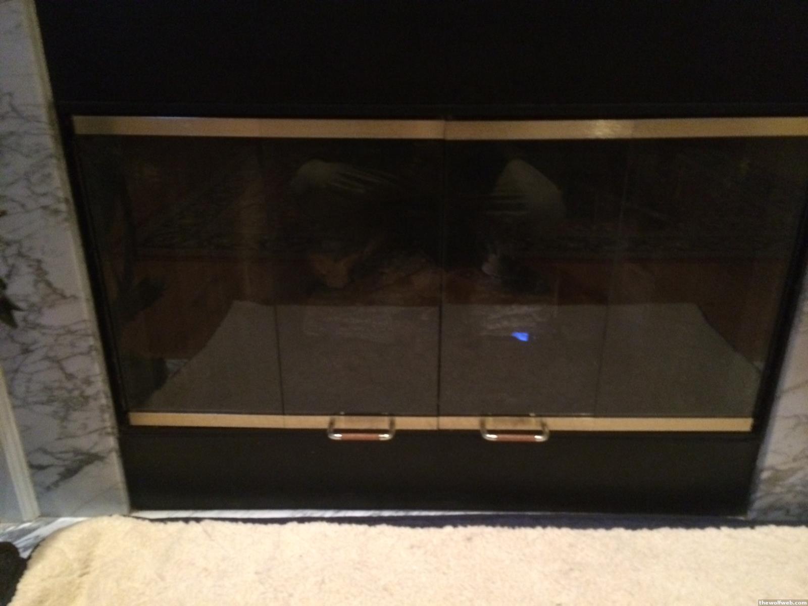

I have a couple of questions regarding gas logs.
If I have a vented system (flue must remain open), can the flue be closed when the fireplace is off?
I was also considering getting a blower because you basically have to sit 6 inches from the fire to feel any heat. Is that a hazard? I didn't know if only ventless could have a blower.
Also, how would you get this bottom panel off?
A lot of the instructions I've seen online say the panel should just pop off, but I see no way to get this thing off. I can't really get a screwdriver in there to pull it off, and I swear there is some type of grout or caulk around the edges.
1/28/2014 1:34:02 PM
Yes, you can close it, that's why it's there
Yes, you can have a blower on ventless, otherwise it's a useless fireplace.

Drovkin
8438 Posts
"Yes, you can close it, that's why it's there
Yes, you can have a blower on ventless, otherwise it's a useless fireplace."
I assumed it was there for the actual fireplace. The previous owner converted them to gas logs.
I also don't have ventless, I have vented. Which is why I asked about the blower.
1/28/2014 8:00:50 PM
35761 Posts
most vented gas logs are not suitable for a blower, but you can check the manual or contact a fireplace shop.
vented logs are really just decoration. they aren't even rated as a heating appliance. un-vented logs are an actual heating appliance.
1/28/2014 8:09:48 PM
