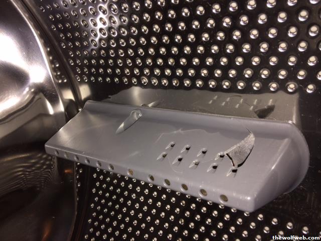

More like an appliance woe, but didn't want to start a new topic...
The inside (drum?) of my frontload washer has a small piece missing (maybe an inch wide). But it seems to be putting holes in our clothes (mainly my wife's). I'm going to assume that its an expensive fix (probably a new drum, plus having to pay someone to install it).
Just found the same washing machine on sale at Lowe's for $500 (originally $700). Should I just go ahead and buy it? I have a stackable washer and dryer...pretty much the only way I can fit a washer and dryer in my house. Wondering if I should start looking on craigslist or just replace this one with the one on sale at Lowe's. Only thing that's keeping me from doing it is the negative reviews it has. It averages three stars...but there are a ton of 1-star reviews. Its worked well for me for over three years...but seems like you get a piece of shit 2 out of 5 times.

How exactly does the drum get a piece missing from it?? Maybe its worth it to buy a better quality machine?

Eh...I didn't pick it out. The seller built the house and fitted it with the appliances. It wasn't a cheap set...price-wise at least, but I probably wouldn't go with Frigidaire when shopping for appliances. I feel like I'm stuck with this brand so that it will fit with the dryer that's already there. I guess I could sell them both and look for a new set...but that would still probably run me a couple hundred bucks more.
As far as a piece missing...the inside drum is a hard plastic material (I think?). Looks like a piece got "chipped" out.
11/25/2013 3:34:18 PM
Could you just fill it in with a plastic epoxy? Maybe you could add add a mesh screen patch to help cross the gap since it's such a large section and cover it all with gobs of epoxy. Then hit it with a sander to knock down any rough spots that might damage clothes.
[Edited on November 25, 2013 at 4:52 PM. Reason : l]
11/25/2013 4:50:31 PM
I would say shit like that is normally out of my wheel house...but I'll look it up. Something like that wouldn't wear down over time and many many wash cycles?
11/25/2013 5:31:59 PM
puck_it
15446 Posts
...as long as the gobs dont catch on clothes, that might work.
But why would replacing the washer with a different appliance require getting a new dryer? Unless you were getting some sort of package deal, or both were shot, why not replace one at a time? Its not like this is going in your living g room.
11/25/2013 8:16:21 PM

This is the piece that's "chipped out"/missing. I don't know why I thought the whole drum was plastic. Just these parts.

is there no way to replace it? Looks like it is attached in a way that would be removable.
11/26/2013 8:10:52 AM
Searching now. I didn't see the screw on the outside until I looked at the picture.
Always thought it was connected from the inside or with some adhesive.
11/26/2013 8:16:05 AM
those are replaceable and easily done... as long as WP doesn't do something funky with their fins.
plastic welding may work... I don't know though... it can be kind of brittle
11/26/2013 8:18:47 AM
Part ordered. Found diagram online and I'm still a little surprised that it only takes one screw for that entire vane. I have a feeling there will be a little more to it. Oh well...don't make a taking a crack at it for only $70 as opposed to a $500 new washing machine.

Firstly, let me say I don't know if stackable units have some common standards, but I would bet not, just so companies can retain more business.
However, there may be universal stacking kits that can handle two different manufacturers...
You are using a stacking kit, right?
That fin or agitator probably just has plastic clips that help hold it in place
11/26/2013 8:40:15 AM
I didn't stack it (builder had my appliances installed before I moved in)....so I have no idea. I'm going to assume so, because it's been stacked pretty well for the past 3.5 years.
11/26/2013 8:43:02 AM
haha. is there some type of metal bracket between the two? a stacking kit secures the dryer down onto the washer.
11/26/2013 8:45:36 AM
Yes...there is. Its just all white so it looks very uniform.
11/26/2013 8:55:48 AM

you don't even need to replace that part. most dries have 3 of them and 2 is plenty to properly work. hell, one is probably enough. my parents had one break off years and years ago and their dryer still works as normal
