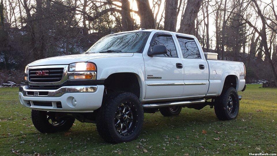

My dilemma....
Either drop a stage 4 transmission into my current whip (2005 Duramax) so I can boost up the EFI live tune higher.
OR
Sell and buy a newer model (don't want to go any newer then 2010) and have to upgrade everything all over again. I just can't help but prefer the newer body style over mine.
[Edited on May 12, 2014 at 9:10 PM. Reason : .]
5/12/2014 9:05:26 PM

^^even though i'm partial to the LBZ I do believe it's still the best Dmax available. The new LML is tough but you're gonna pay for it. only difference between your LLY and the LBZ is the program which you have changed. i say stay with what you've got.

renegadegirl
2061 Posts
^ Noted and I think your right.
Its a good truck. I really can't complain except to be nit picky over superficial shit like body style.
So far we've done:
EFI Live (5 tunes done by Dustin at Diesel Addiction)
Banks Cold Air Intake
EGR Delete
Straight 3.5" pipe from engine into dual welded 5" tips
AirDog 150
Upgraded the turbo with a Bantam wheel (nothing fancy there)
6" FabTech lift
20" BMF R.E.A.P.E.R. Death Metal wheels with 35" Toyo Open Country A/T II tires
But I want more power... hence the desire to drop a stage 4 into her since I really can't push more than 100hp extra on the stock transmission without risking limping home one day...
[Edited on May 12, 2014 at 10:03 PM. Reason : Credit where credit is due]
