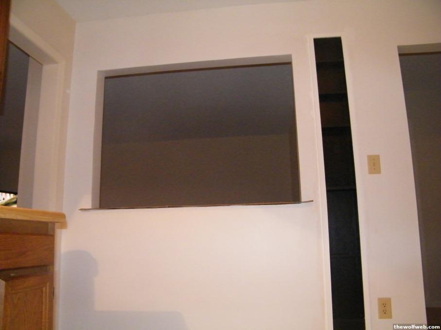

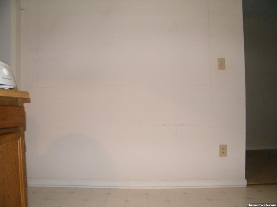

Kitchen/Living room pass-through question.
I have the pass-through cut out and framing done. I want to put down a 12" wide oak "bar top". It'll hang over about 2" on the kitchen side and a bout 6" on the living room side. Do I sheetrock the inside edge of the pass-through before or after I put down the bar top?
I'm thinking about putting the bar top down first then sheetrocking the inside edges.

Personally, I would rather put up the drywall and do all of the finish work there (corners, priming, painting) before putting the oak in. Much less chance of me fucking up the oak that way.
1/14/2012 8:20:03 PM
Yea. That's probably the way to go. Just thought it would look neater(neat as in better. Not as in cooler)

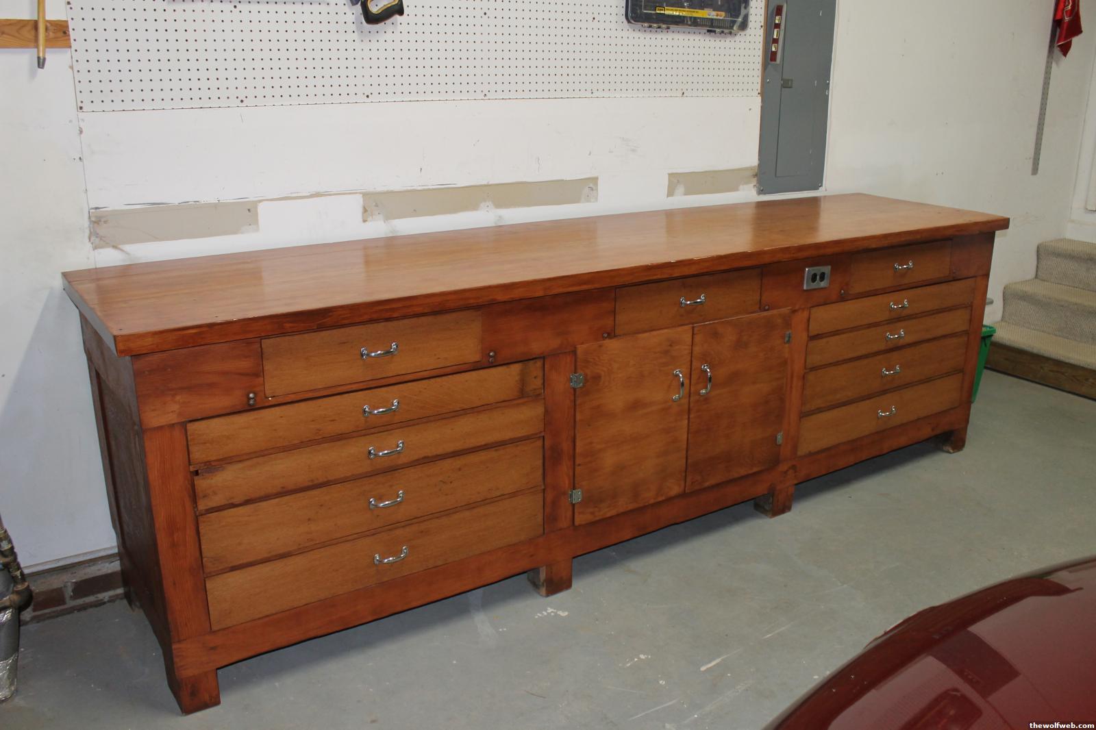

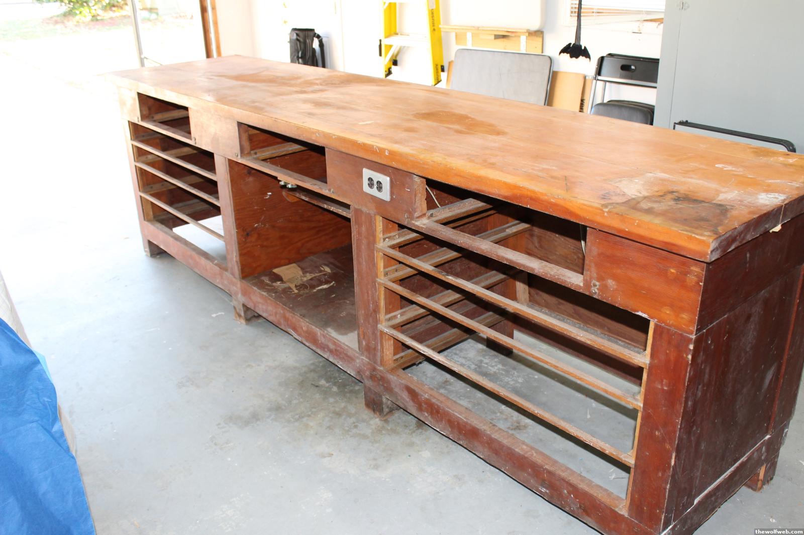

So my grandfather gave me his fathers old workbench a couple weeks ago and I have spent some time re-finishing it. It is 10.5' long and almost 3' deep and more than 70 years old. A couple guys from the Wolf Web helped me get it out of my grandfathers crawl space.
Here is the before:
I sanded, stained and 4 coats of Poly on the counter top. I know it isn't perfect but I think it is pretty sharp for a garage piece:

looks great

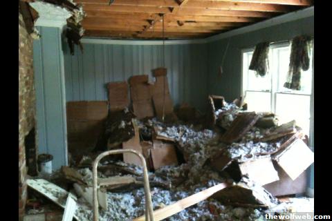

i hate any and everything involving ceilings, probably because ours fell over the summer. hanging new sheetrock isn't fun (although drywall lifts are awesome) painting isn't fun, insulation isn't fun, and mudding isn't fun. if you have other projects i would do those before i even thought about doing anything ceiling related.
