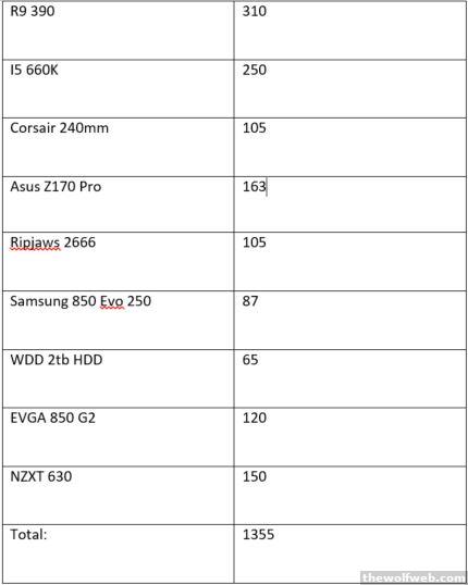

neodata686 so as discussions with the wife have continued ... I've learned my budget is more in the $1500-1700 range instead of $2k
HAHA so changing gears is there anything you'd tweak on the 1300 build ?
http://www.pcgamer.com/best-gaming-pc/
I'll prob upgrade the second HDD to 2tb and the CPU fan to water cooled (because I got a big kid job, and I wanna do it and she's just gonna have to deal with it !!)
so anything I could go up a bit on ? (assume the ^ changes don't cost any money.) More to the point is there anything another 200 bucks on something would really change or impact?
11/2/2015 7:17:36 PM
ssclark
Black and Proud
14179 Posts
thoughts?
ps : that's 16gb of 2666 ram, overkill ?
11/2/2015 7:49:55 PM
ssclark
Black and Proud
14179 Posts
this whole 30 min edit thing is killing me .... I ask because if I can wittle it down to 1100 or so I can prob talking wife into a 980 Ti or 2x R9 390's ....
any thoughts on those two options ?
I can prob cut money in the case and hd etc. I have a 3tb external so i can cut to a 1tb there and a cheaper case.
11/2/2015 8:37:55 PM
19016 Posts
get a gtx970 for 280 and buy the equivalent pascal when it comes out for 300 instead of dropping 600 on a card that will be outclassed sooner than you think
11/2/2015 10:20:00 PM

11/3/2015 9:46:52 AM
neodata686
11577 Posts
A single 980 ti is still going out outperform 2 970's and you'd only be saving ~$100.
11/3/2015 12:24:59 PM

ssclark
Black and Proud
14179 Posts
hrm logical increments said two R9 390's would be better than a single 980ti.
and i thought the 970 and 390 were in the same class.... i mean they're the same price so why would i go with a 970 over the 390?
11/3/2015 12:52:28 PM
neodata686
11577 Posts
Yeah get the 370 and yes 2 370's would be nice especially with the initial DX12 benchmarks. Then again an Nvidia update could drastically change performance.
11/3/2015 1:14:11 PM
