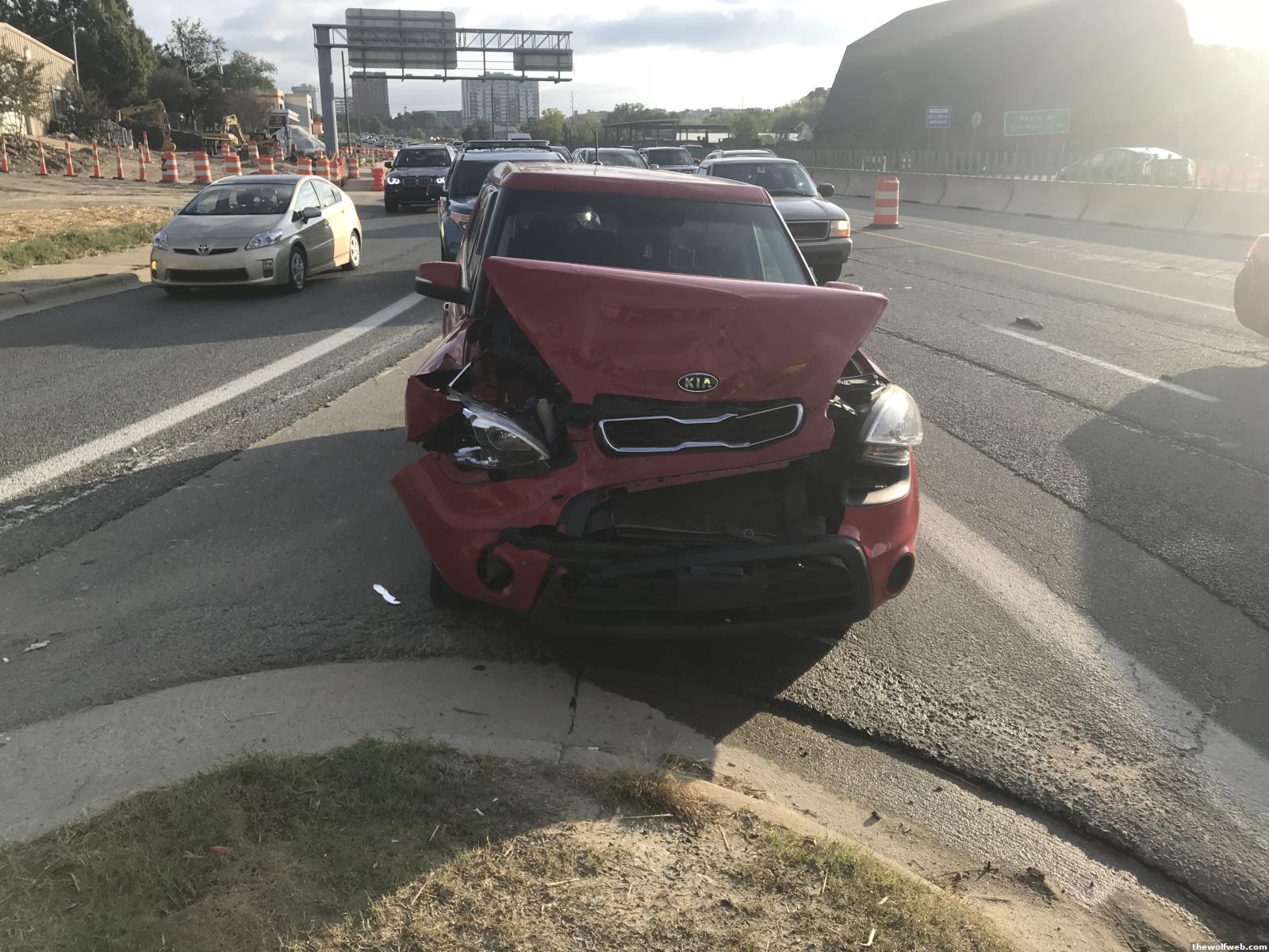

Totaled the car
10/20/2017 5:24:37 AM

wheres the other car?

The other car was a 2014 Ford Taurus, barely damaged

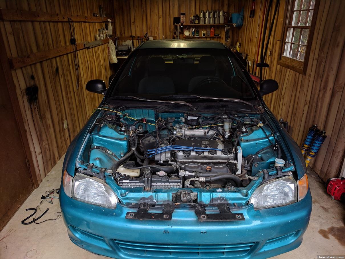

Still working on the other civic. Getting it ready for Frozen Frenzy @ VIR in February... Basic JDM H22 swap, nothing fancy... Just a lot of labor

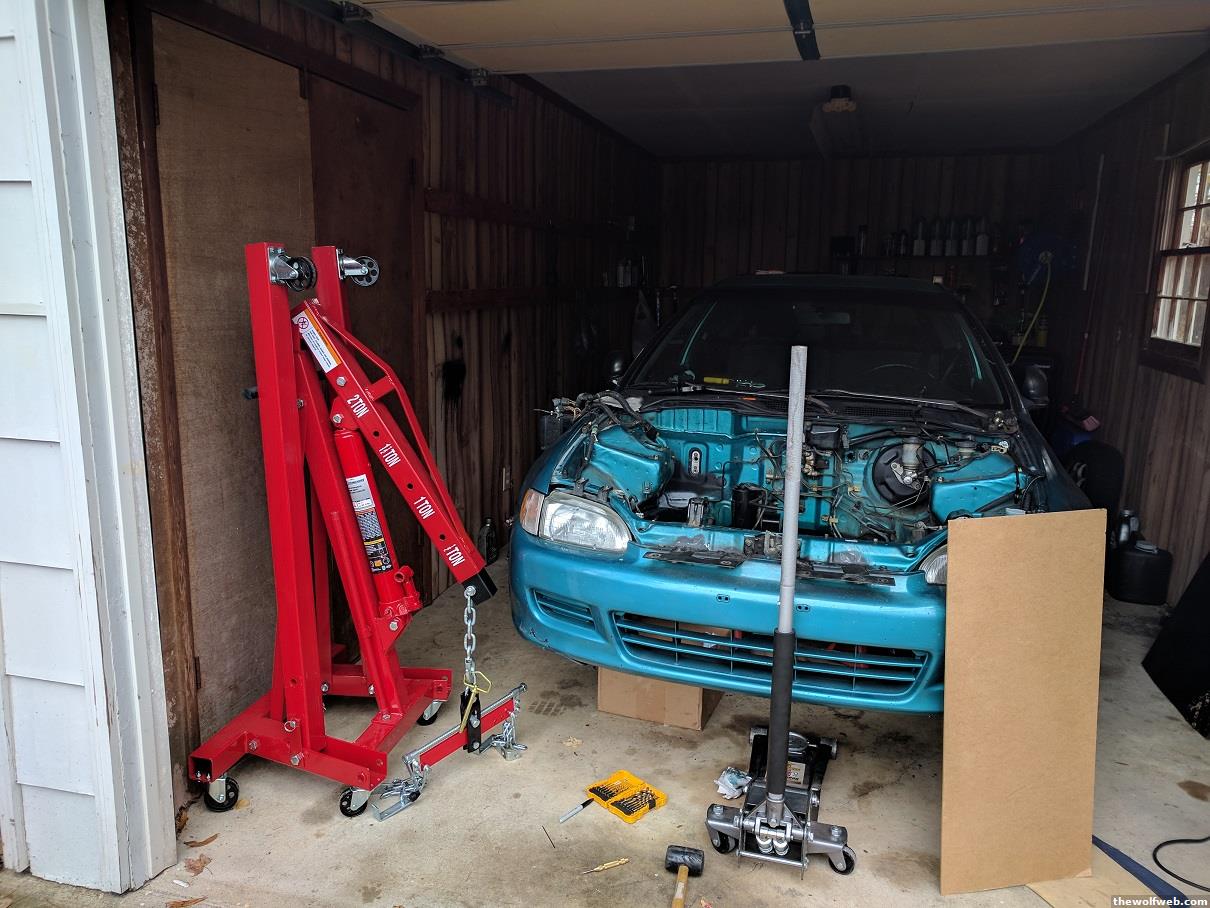

Anddd the motor is out... that's about as far as I've gotten I mean, I'm further along than that... but nothing worth really talking about... Going to be dropping the motor in by new years weekend... Getting the wiring and cable shifter all sorted out, as well as the battery relocation to the trunk. Lots of work on the inside...

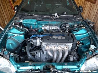

She's in!

^^Nice! I recently picked a 93 CB7 in pretty decent shape. Dropped in a H22A from a 97 Accord SiR wagon and used the original stock transmission. Gearing was way too long. Between gears it would drop out of vtec. Just picked up a T2T4 transmission. Currently replacing r&p but I'll swap transmissions soon. But so far the car is super fun.

Yeah. This swap has been pretty straight forward. The cold weather has been a PITA though, slowing down a lot of work. I'm having to relocate the brake proportioning bodies further down the firewall, closer to the passenger side, to clear the intake manifold. It's snug in that bay. not a lot of room, just plenty enough. My 944 swap was definitely the definition of a "hair to too big for the bay". I can make this work, just a lot of "little" setbacks that the forums don't tell you about... I'm looking forward to making the new brake lines, clutch line, finishing the exhaust, and starting her up!
