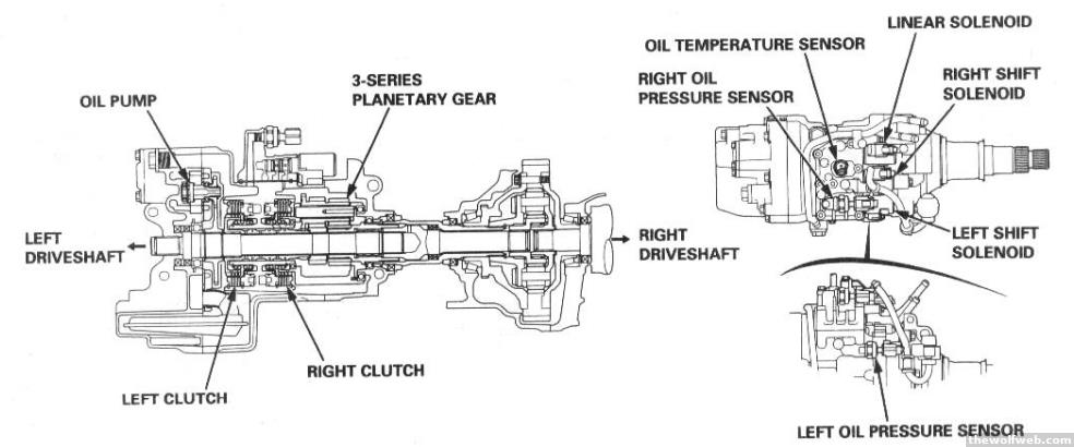

The last generation Honda Prelude Type SH uses what Honda calls the Advanced Torque Transfer System, or ATTS. This is a front wheel drive vehicle, and front wheel drive has a tendency to understeer. To address this, ATTS uses clutches to engage a planetary gearset in order to transfer torque between the two axles and increase the speed of the outside wheel in a turn. The system uses a lot of elements you find in an automatic transmission.
You can see its location in the front of the vehicle and the hydraulic lines to cool the fluid for the wet multiplate clutches (similar to what's in an automatic trans).
Here you see the two half shafts, a set of planetary gears, the pump used to generate hydraulic pressure, solenoid valves and fluid pressure sensors like you would see in an automatic transmissions' valve body.

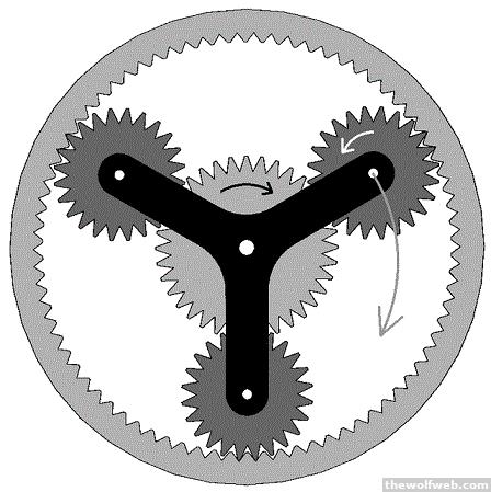

Here's a basic diagram of a planetary gearset. In the middle is the sun gear, then the planetary gears connected to a common gear carrier, then a ring gear on the outside. For purposes of this discussion, the ring gear is irrelevant for understanding how this system transfers torque between axles.
A simplified way to explain it is that, if you think 3 dimensionally, there are 3 sun gears next to each other: left, right, and central. There are two sets of pinion gears, left and right. The clutches will engage the left side with the central, or the right side with the central. If I engage the left clutch, I transfer torque/driving force from the left wheel to the right wheel, and vice versa. Due to carefully-chosen differences in the number of gear teeth, it works out that the outside wheel in a turn will be able to spin at ~1.15 times the speed of the inside wheel when the clutch is fully engaged. This transfer of torque and rotation to the outside wheel reduces the understeer tendency.

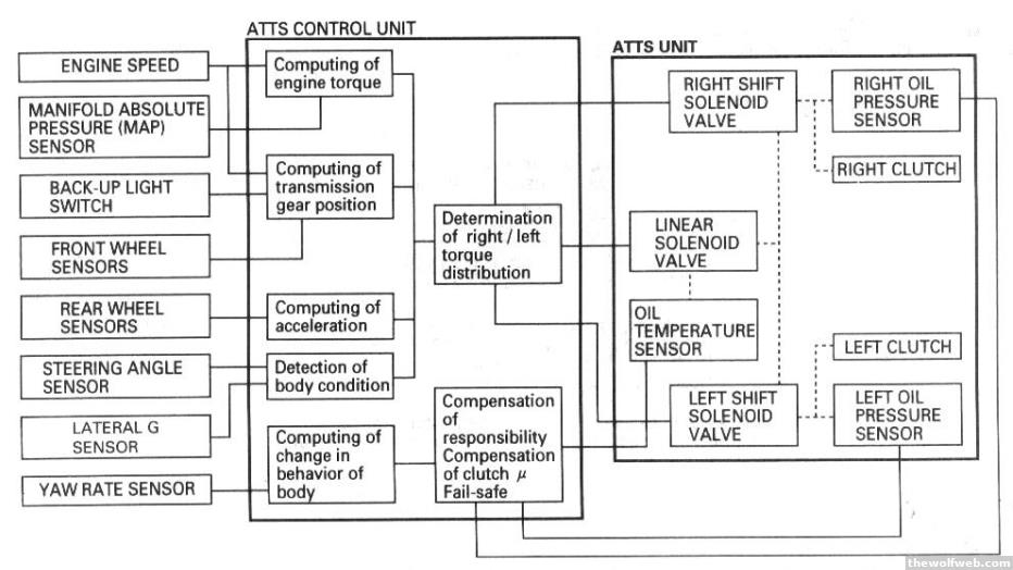

The above diagram shows the basic structure of the control system. This generation Prelude came to market as a 1997 model, and these are pretty advanced controls for back then. A basic engine torque model and wheel driving force/torque model are used to determine how to engage the clutches. The system also had a yaw sensor and a G sensor to better understand the current driving maneuver. These sensors are more likely to be found in the more advanced AWD or other vehicle dynamics systems of today.

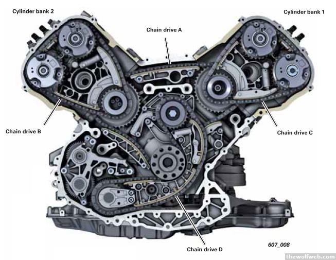

Compare the timing and accessory drive of the Audi 4.0 liter twin turbo V8 engine (420hp), which is a dual overhead cam engine, and the GM Gen V 6.2 LT1 engine (450hp) with pushrod valve actuation. Both engines have cylinder deactivation and variable valve timing.
Here's the Audi chain drive:
So you've got 4 chains, labeled A-D
Chain A - connects from the crank to intermediate gears on the two banks
Chain B - driven by Chain A, drives the cams on Bank 2
Chain C - driven by Chain A, drives the cams on Bank 1
Chain D - drives all accessories except for the alternator

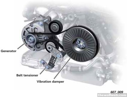

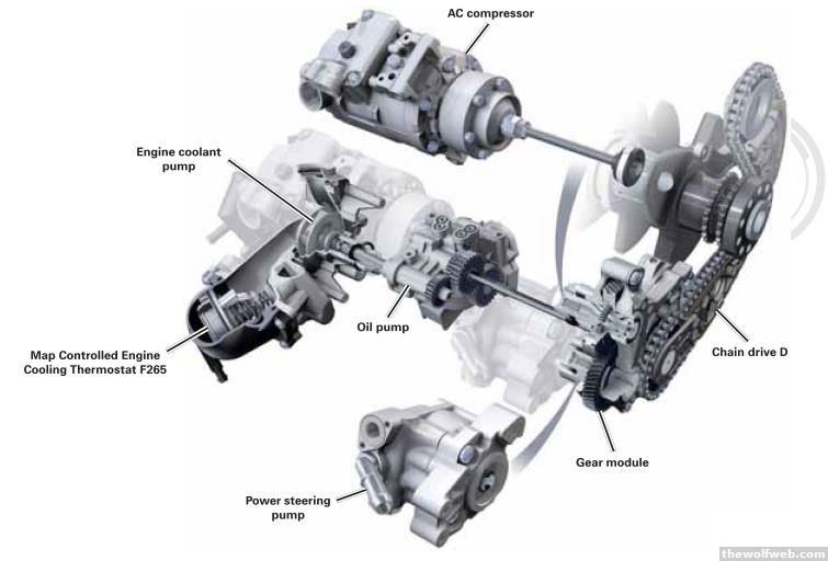

You can see the system of accessory gears connected to Chain D:
The alternator is the only accessory with conventional serpentine belt and tensioner:
Why the complexity? I would think that the use of intermediate gears and separate chains for the cams reduces noise and doesn't have the stress of one big chain driving all the gears, especially with the variable valve timing cam phasers and high pressure fuel system.
For the chain driven accessories I can only speculate that it may have been a packaging issue of some sort--reduces the number of pulleys. Or maybe the chain drive as implemented here was quieter.

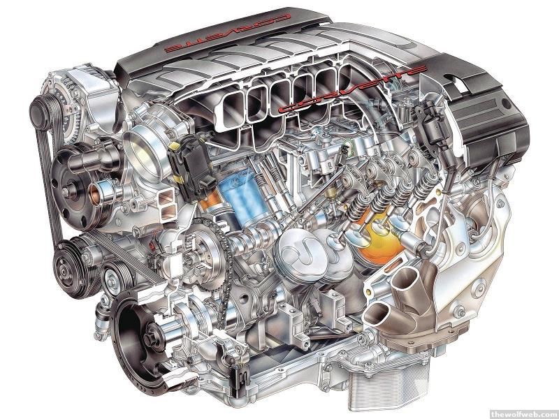

Now, look at this cutaway of a GM Gen V LT1 engine:
You can see on the left a small chain driving a single camshaft in the valley, with a simple dual-equal phaser (retards both intake and exhaust valve timing at the same time). The high pressure fuel pump is cam driven but not shown here. Then you have a simple serpentine belt system to drive the accessories. This is a less expensive and less complex design than what Audi uses, especially since it is a large displacement naturally aspirated pushrod V8.

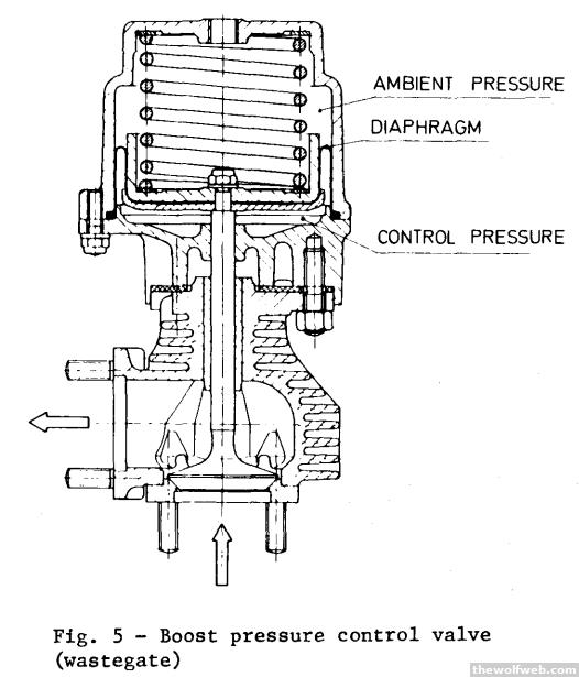

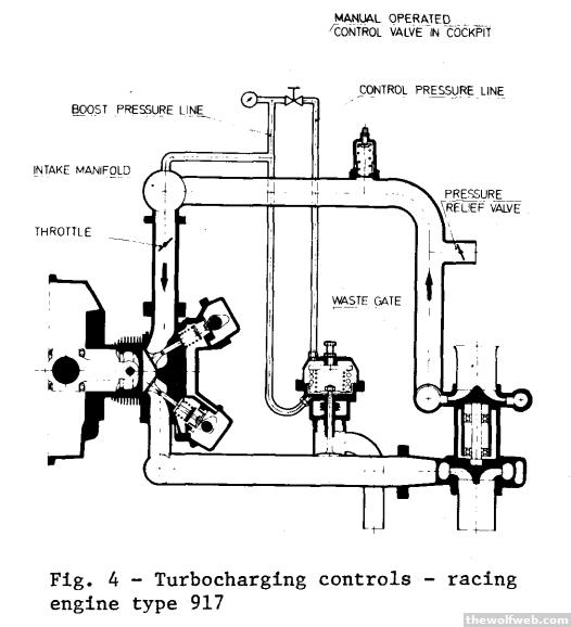

Porsche was the first manufacturer to have a turbocharged engine for racing. The 1973 Porsche 917 was a 5.4 liter flat 12 cylinder rated at 1100 horsepower. It used a setup that may be familiar to many of you with flat engines: an external wastegate controlled by a manual boost controller.
An external wastegate bypasses exhaust gases from the turbocharger wheel to control boost. A spring-loaded poppet valve controls flow. The stiffness of the spring indirectly controls the amount of boost pressure to the engine. The diaphragm chamber is divided into an upper portion and a lower portion. The lower portion can receive boost pressure to left the poppet valve off its seat and bypass exhaust from the turbo. The upper portion can be open to atmosphere, or it can receive pressure to push the poppet valve closed and raise boost.
When the valve lifts off its seat, it sends exhaust back into the main exhaust stream. Porsche originally used a physical screw to set preload in the spring in order to raise boost pressure. Then they used a manual valve to regulate additional air into the upper portion of the diaphragm chamber.
Wastegates of course are standard now on turbochargers, but at the time it wasn't always the case. The Chevrolet Corvair Monza for example, a turbocharged flat engine, had no wastegate, and neither did a lot of diesels. Not all wastegates were controlled with boost pressure; some were actually controlled by letting exhaust backpressure push the poppet valve open by overcoming the force of the spring. So technology and systems we take for granted today had to be discovered by earlier generations of tinkerers.

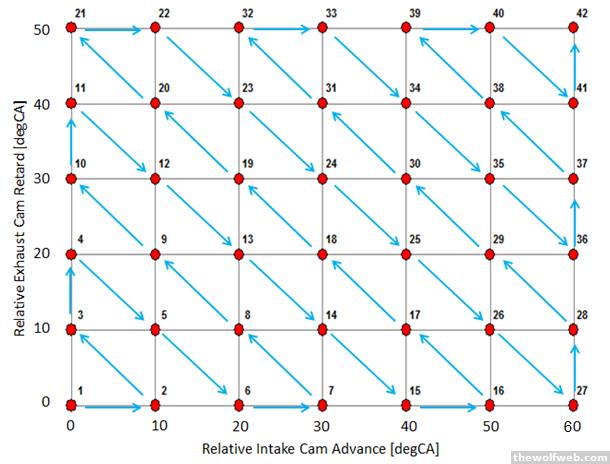

These days most new mass production gasoline engine designs with dual overhead cams have phasers on the intake and exhaust cam. This means they can move the valve events earlier or later with continuous variation, rather than a "2 step" on/off system. This type of system can be called things like VVT, VTC, VCT, VANOS, i-VTEC, etc.
The cams default to a locking position, typically with no overlap or very little overlap between intake and exhaust events. Then the exhaust cam can be retarded (moved to the right in the image above) and the intake cam can be advanced (moved to the left in the image above), and in some systems the intake cam can be retarded as well.
Usually the cam phasers have some range of authority, usually anywhere from about 30 to 70 degrees. Newer engines tend to have cam phasers a wider range of authority, and require a piston design that doesn't allow the valves to contact the piston. Fully optimizing for fuel economy requires extensive studies on an engine dyno to measure the brake specific fuel consumption, combustion stability, residual gas fraction, etc.
The thread below, which I mentioned on the previous page, has more explanation about cams and what happens when you move cam centerlines around. http://forums.nasioc.com/forums/showthread.php?t=2687550

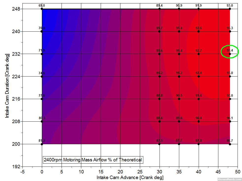

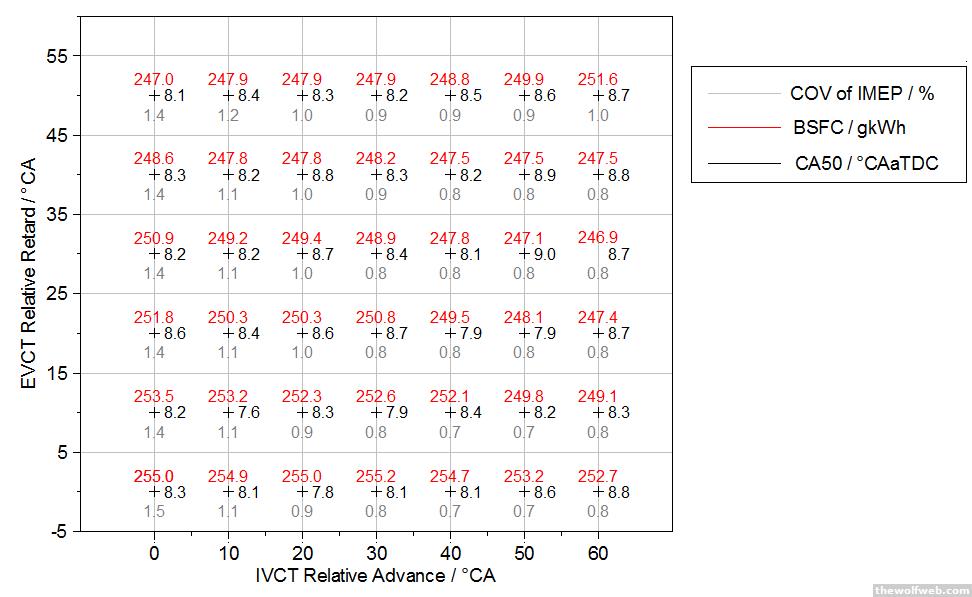

So here's an example of a full detailed study ("full factorial" is the jargon) at a specific speed and load point:
Take an engine with a 60 degree intake cam advance authority and a 50 degree exhaust cam authority. The four corners of the map above represent four different cam phasing strategies. At the bottom left is the cam running with the phasers at their locking position. This is equivalent to a fixed cam engine. Whatever the default centerlines, lobe separation angle, or whatever term you want to use, is what you get. Since it's a continuously variable system, you can change the cam setpoint to whatever you want (whether it will hold precisely is another matter), but typically 5 degrees is a good step to move during these kinds of studies. A certain amount of time needs to be averaged at each combination, as this is a steady-state analysis. Now you can start moving cams.
Keep the exhaust cam locked and step the intake cam toward the bottom right corner of this chart and you get primarily an early intake valve closing scenario with higher effective compression. There's also a small amount of residual gas (internal EGR).
Move to the upper right corner by retarding the exhaust cam and you get a high overlap and high residual gas fraction (internal EGR), assuming that scavenging isn't going to come into play under these conditions.
At the upper left corner you have a locked intake cam and a fully retarded exhaust cam. With this particular set of cams you get a small amount of residual gas and minimal overlap. With a different design though you may have more overlap. You also have late exhaust valve opening, which increases expansion ratio. With this particular cam design your default position has a somewhat late intake valve closing.
Note that this image above is somewhat similar to what "dual equal" phasers do, that is variable cam phasing on pushrod engines and SOHC engines (Ford 4.6 3 valve, GM and Chrysler pushrod V8). They can only retard the intake and exhaust cam together, and the overlap is fixed.
If you look back at our cam phasing mapping plan you'll see a bunch of diagonal arrows and numbers. That's one possible way to step through all the combinations when testing on an engine dyno. This can be controlled manually or it could be automated. Now that we've illustrated the 4 corners of the map, let's show what a resulting map might look like:
Each set of numbers represents the brake specific fuel consumption (grams/kwh , lower is better), the location of 50% mass fraction burn (crank angle degrees ATDC firing, ~8ish is considered minimum spark advance for best torque), and the amount of combustion instability (coefficient of variance of indicated mean effective pressure in %, lower is better).
So in the example shown here, the engine seems to like the upper left corner the best in terms of fuel economy (red numbers). This is late intake valve closing, late exhaust valve opening, and could also be considered Atkinson Cycle. Under other conditions, maybe the engine likes the upper right corner better. Notice that the edges of the map, especially the upper left corner in this case, have the highest gray number. The combustion can become unstable from overlap or late intake valve closing. If it's bad enough, a driver could feel vibration in the vehicle. Generally 3% is a rule-of-thumb limit, but it depends on the application. Maybe under other conditions your most unstable point will be the upper right corner of the map rather than the upper left.
The black number is the location of 50% burn. It's between 8 and 9 degrees ATDC here. The reason this moves around is that the combustion speed changes as we change the valve events. The spark timing needs to change with it. A slower burn requires more spark advance, which has to be adjusted by whoever is running the engine or by the automation program running.

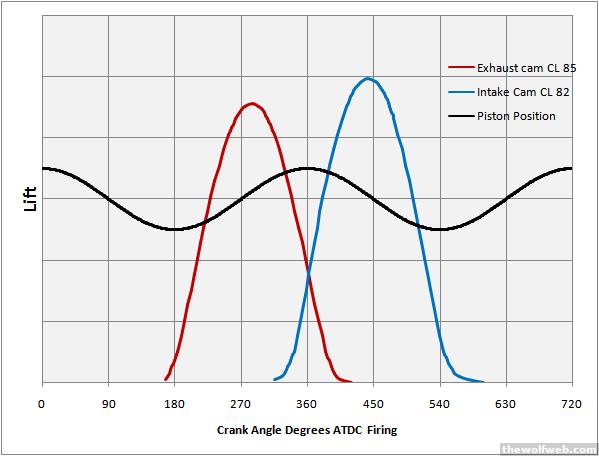

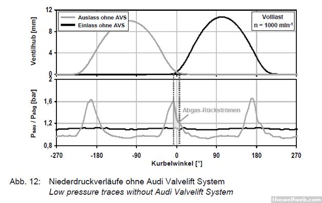

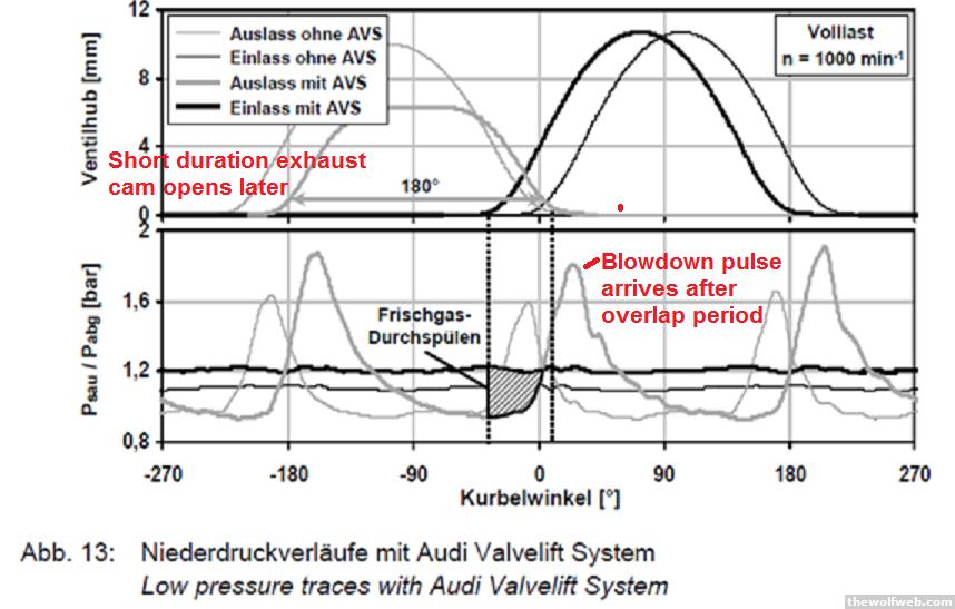

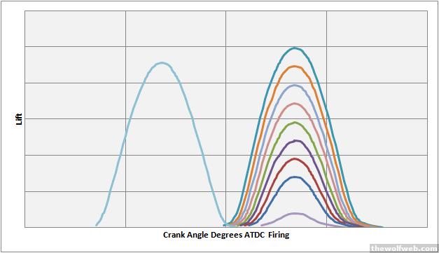

Back on page I talked about how twin scroll turbos separate exhaust gas pulses on an I4 engine to reduce residual gas in the engine and give better low end torque:
There are a few drawbacks to twin scroll turbos though. The divider in the middle and overall design of the turbine housing causes more restriction and backpressure at high speed. These housings also must be run at lower exhaust temperatures than monoscroll turbos of similar material, and can be more of a thermal sink to inhibit catalyst light off.
So there's another way to accomplish the same effect without some of the drawbacks of twin scroll turbos. By reducing the exhaust cam duration and retarding the exhaust valve opening event, the blowdown pulses will not flow back into subsequent cylinders. Audi uses this principle on some of their newer I4 turbo engines, and advertise it under the umbrella term of Audi ValveLift System.
The diagram above shows conventional valve timing during overlap. The exhaust pulse from an earlier cylinder firing event travels to this cylinder, causes a rise in exhaust port pressure. When the intake valve opens, the exhaust travels into the combustion chamber and results in hot residual gases remaining in the cylinder. That increases the chance of knocking and reduces volumetric efficiency as fresh air is displaced.
In the image above, the top pane overlays the short duration exhaust cam profile with the standard profile. The short profile opens the valve a lot later and closes later here. In the bottom pane, the short profile's cam results in the exhaust pulse not reaching the subsequent cylinder until after the exhaust valve is closed. The result is similar to a twin scroll turbo at lower engine speeds and high load, but without the drawbacks described above, especially at peak power speed where monoscroll turbines are advantageous due to less backpressure.

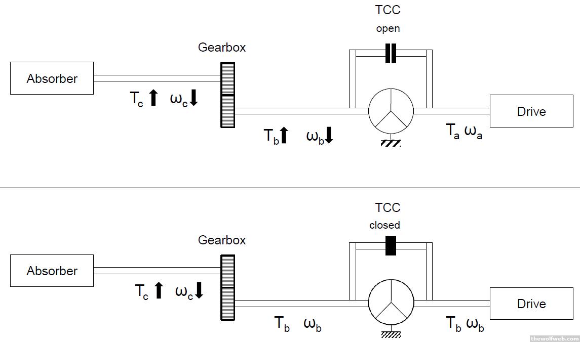

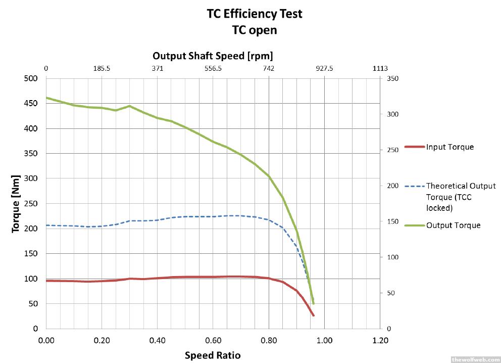

Today I want to talk about torque converter torque multiplication. There are gazillions of sites and videos about what a torque converter is and what it does. The torque multiplication effect deserves some extra attention. Here's a Youtube video called "How does a torque converter stator work?"
It shows how the stator, the fixed part in between the spinning engine side and spinning transmission side, directs fluid in such a way as to add torque. This happens when the engine side is spinning faster than the transmission side which ultimately connects to the wheels. To illustrate this relationship, we can use data from a relatively modern but still basic 6 speed front wheel drive auto transmission mostly found in frumpy sedans.
Test Bench
In this case, the transmission is being spun on a test bench where the input and output shaft speeds can be independently controlled, with the converter clutch open (converter is not locked up, top pane of image). The input shaft speed is fixed at 2000rpm, while in 6th gear with a fixed hydraulic line pressure. With the gear and final drive applied we have a fixed difference in speed (speed ratio is 1). Then the test bench can lower the output shaft speed, reducing the speed ratio and raising the multiplication effect. The baseline relationship with closed torque converter can also be measured (bottom pane of image). By running output shaft speeds we can build a map of the torque multiplication relationship.
Data
The bottom x axis is the ratio of speeds between the input and output shaft. Remember, the input shaft speed is held fixed by the test bench, and the output shaft is affected by the gear ratio (around 2.2:1 here). So a 1.0 ratio is not going to have the input and output shaft spinning at the same speed. If the ratio is less than 1, it represents the torque multiplication effect of the converter, not any kind of gearing change, when the torque converter clutch is open.
When the torque converter clutch is closed, the input shaft speed needs to be varied to get the output shaft speed labeled on the top of the X axis.
The Y axis is torque. The test bench dyno motors can apply torque on the input side, and absorb torque on the output side. So looking at 1.0 on the graph, starting with the engine and transmission side spinning at the normal (gear related ratio), we look left at the green line and red lines. That increasing separation shows the multiplication effect. The increase in the red line (input shaft torque) reflects reactionary forces from the output shaft as a result of the torque multiplication effect.
As a reference, look at the blue dotted line and the top X axis. This is just varying the input shaft speed with the converter clutch locked.
Now look at the efficiency plot (lower ratio efficiency can be extrapolated).
This number is a comparison of the power put into the system vs the power put out. The output torque is going up but the output speed is going down. From the perspective of overall efficiency you can see why you would want to run at a speed ratio of 1.0 (torque converter locked), and that's why the newest autotransmissions have a locked torque converter in most areas of operation.
From the perspective of getting more torque to the ground through multiplication effect, you want to expand that gap between the green and red lines in the second image. That's what changing the design of the torque converter stator does, and it's a frequent change used in drag racing applications.
[Edited on November 9, 2016 at 3:03 PM. Reason : .]

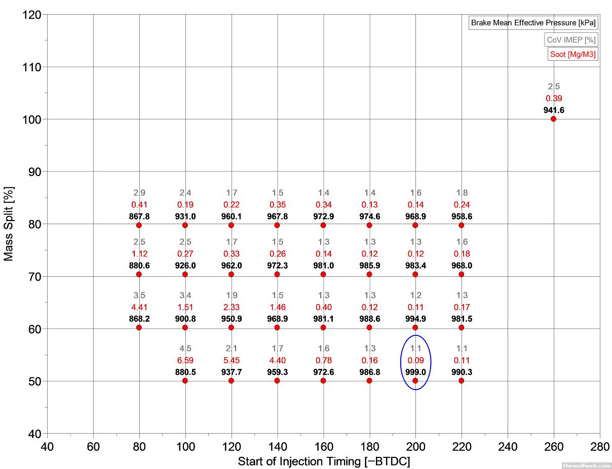

You know all that nasty black soot stuff that comes out of your tailpipe on these newer gasoline direct injection engines? The newest emission regulations are trying to reduce that, not only in situations that occur in controlled lab tests, but also for real world engine speeds and loads.
One of the ways to do this is to optimize the start of injection timing (SOI), the number of injection events, and the mass split between them. The images below show an optimization test at 1200 rpm, wide open throttle. That exact condition is not too common in the real world, but you can see some interesting trends.
In the example below the engine is run in a lab, running 20 seconds steady state (sitting there at WOT using systems to cool the engine) at each point with a fixed spark at TDC (0 degrees advance). The points in the scatterplot have different injection timings and mass splits. The Y axis is the injection mass split %. 100% would correspond to a single injection event. The other points have two injection events, where 80% on the Y axis would mean 80% of the injection pulsewidth is allocated to the first event, and 20% is in the second event, and 50% would be an even split.
The x axis is the start of injection timing in degrees BTDC firing, the same units we normally associated with spark timing. As you look towards the right, the injection timing is earlier. As you look towards the left, the start of injection timing is later. The black numbers are the brake mean effective pressure (proportional to measured brake torque, higher number = good), the red are the soot (higher number = bad), and the gray are the combustion instability (higher number = bad). Most of those numbers (black, red, gray) should be compared in a relative sense to the other points in the matrix. You want the highest BMEP, the lowest Soot, and the lowest combustion instability, or some compromise among those choices.
So in the upper right corner is a baseline condition, running a single injection event. We know it's a single injection event because the mass split is 100% --> 100% of the injected fuel is in the first event. The injector starts firing at 260 degrees before top dead center. Although the combustion instability of 2.7% is acceptable it is not great. If it's over 3.0% as a general rule you can feel vibration or torque fluctuation in a car. That's a general rule of thumb.
Then in the rest of the matrix you see two injection events. The first injection timing is still fixed at 260 degrees BTDC, while the second is varied from 220 to 80 degrees BTDC. We don't fire the second event earlier than that so the injector has enough time to respond, as this engine doesn't have expensive piezoelectric injectors. When the second event starts much later, we get lower torque, and what's not pictured here are the high exhaust temps as so much combustion is pushed out the exhaust valve (similar to what is done during a cold start). The later injection also has higher soot, as the fuel is impinging on the piston top or cylinder wall.
An even 50/50 split with the second injection firing 60 degrees after the first shows the most optimized point of stable combustion, low soot, and high brake mean effective pressure/brake torque. This is circled in blue.
This chart shows the soot and combustion instability, but also shows the location of 50% burn instead of the brake mean effective pressure. The units are in degrees ATDC firing. Considering these all have a fixed spark at top dead center, a higher number corresponds to a slower burn (which is generally not good) and a lower number corresponds to a faster burn (which is generally a good thing).
We can see from this chart that the highest torque point with the most stable combustion and low soot-producing impingement also is the fastest burning. We know this because the number "22.4" is the lowest among the points, meaning that half the mixture is burned 22.4 degrees after top dead center, with the spark fixed at TDC. In contrast, the upper left corner of that matrix with a low mass late second injection has a 50% burn location of 33.3 degrees. So it's burning much slower. Meanwhile the baseline is 27.8, meaning we've advanced the combustion about 5 degrees (almost like advancing the spark 5 degrees).

Let's talk about camshafts and low end torque. Bigger isn't always better. We know that, but it's interesting to see it illustrated.
Long duration cams with the intake valve closing long after bottom dead center is not good if your goal is trapping the most air in the cylinder. One way to find the best theoretical valve timing is by measuring the volumetric efficiency of the engine with different cam centerlines and different lift/duration profiles. Below illustrates a fixed intake centerline with varying intake cam duration/lift profiles and a fixed exhaust. Notice that with the different intake profiles, the opening and closing timing of the valve will vary, but the centerline (a straight line through the point of peak lift) doesn't change. Now let's move on to the different combinations of intake centerline and cam profile:
Here is test bench data from a gasoline V8 engine using 7 different cam lift/duration profiles with the intake same centerline, shown here on the Y axis. Exhaust valve timing remains the same in each case. With each profile the intake cam can be at a baseline position optimized for higher rpm or the centerline can be advanced up to almost 50 degrees. Engine speed is 2400rpm, which is realistic for "stump pulling, get off the line" scenarios. The engine is operating as an air pump here; it is not firing, so exhaust gas dynamics (scavenging effects etc) are not a major concern. This method isolates the effect of the intake-side valve timing.
The cylinder filling % is calculated by taking the engine control unit's measured mass airflow (from a hotwire type mass airflow meter) and dividing it by the theoretical pumping according to engine displacement etc.
The peak pressure in the cylinder is calculated by taking the peak pressure measured within a 200 cycle window from a cylinder pressure transducer located in the spark plug.
So what can we learn from these graphs? Well, when the engine is only pumping air, the valve timing of best pumping also has the highest cylinder presssure. At an engine speed like 2400 rpm, the biggest duration with the latest valve timing really sucks for pumping --> compare the 69% volumetric efficiency in the upper left corner with the 93.4 % volumetric efficiency circled in green.
Also, notice that on the far right column with the most advanced cam centerline, the longest duration cam is still too long--the upper right corner is at 93.0%, while the circled green is 93.4% with 16 degrees shorter duration (and thus the closing and opening timing are affected from this despite the same centerline).
In this case, the pumping efficiency (motoring condition) of the engine is more sensitive to change in intake cam centerline than it is to change in profile.
What does that mean to you? Well, there's more to a cam than its lift/duration profile. Those big numbers thrown around for marketing purposes aren't everything. The timing of the valve events has a huge effect, especially the centerline of the cam (or lobe separation angle depending on the context).

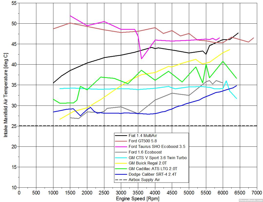

If you have a turbo engine in your car, there's probably some thread on a car forum somewhere complaining that the stock intercooler for your car sucks. What I find interesting are the assumed efficiency of the stock intercoolers for the rated horsepower. One of the ways to look at that is by graphing up the intake manifold temperatures (after the intercooler) from the published certification reports. These measurements are taken in a lab although they are supposed to represent real world[ish] conditions.
The X axis represents the engine rpm, and the Y axis represents the temperature after the intercooler. Keep in mind though that the engine speed is ramped very slowly in these tests, like lugging your car in top gear at 1000rpm and flooring it under it redlines. Also, the intercoolers can all be controlled in different ways in the lab, usually using some kind of forced cooling due to insufficient airflow from fans.
So the dotted line is 25C or 77F, which is the temperature of the air at the airbox and the standard condition for power correction calculations. You can see post intercooler temperatures mostly ranging from 35C (95F) to 50C (122F). What's actually interesting and sort of impressive to me are the engines that are making their power with hotter temperatures, because that implies that they don't depend on the stars all aligning to perform well (cold day out).
