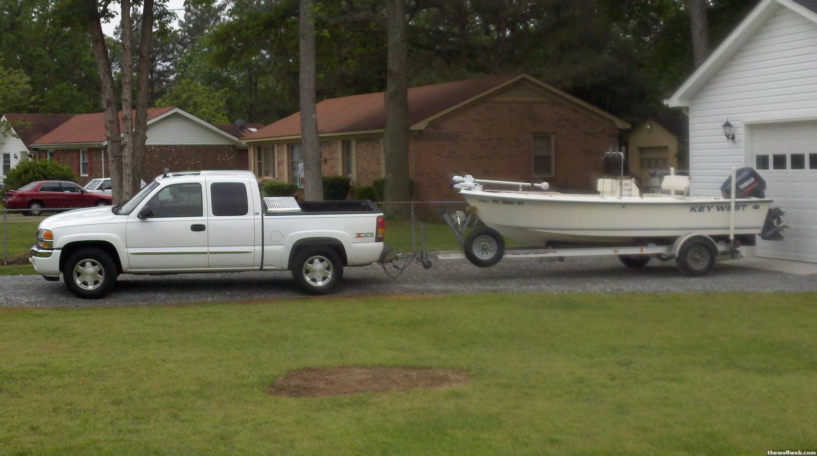

finally took the boat back down this weekend. the new forward bunks on the trailer made it load like a whole different boat. so much faster and easier. also really glad i went ahead and got a full size truck. towing it down was a lot more comfortable and i could actually tow it faster than 60 mph.
here it is before heading out:
