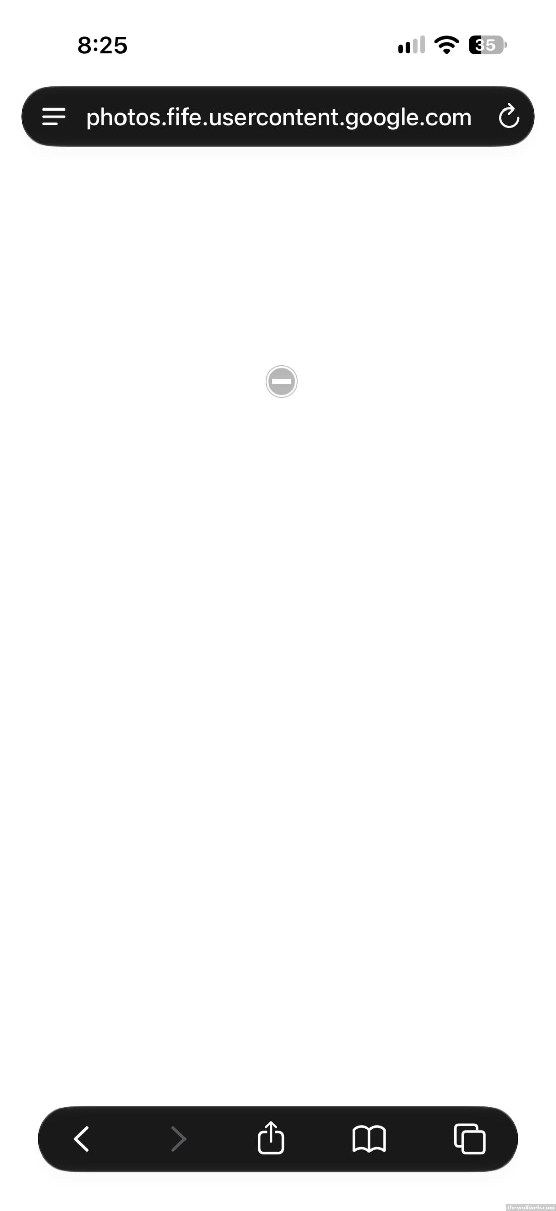

280k miles. The radiator had a huge hole in it, too. They probably overheated it, warped the head, gasket failed, then tried to start it with a cylinder full of coolant and jumped timing.
Carnage: https://photos.fife.usercontent.google.com/pw/AP1GczMzI_oWA4gx3cskiE0q9mOh4gurwIQGQbiYB7zmwEgFUgxZ5O37OQJlvg=w1294-h970-s-no-gm?authuser=0

Not AI!
17624 Posts
Bummer this is what shows up for me
9/15/2026 9:26:24 PM
35756 Posts
try this https://photos.app.goo.gl/hqpyNdFnC27jNr8A9
