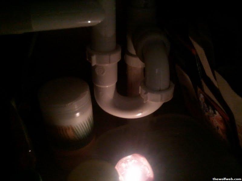

Possible plumbing problem:
So it's hard to see it in this picture because I cleaned up most of the mess...however...
Last weekend I did a deep clean of my kitchen (cleaned up the clutter and got into the nooks and crannies and did some good cleaning). There was definitely a lot of shit going on under the sink that I had to organize. And when I did, I found a leak in my PVC piping. If you look at the picture, on the right upper side of the "U" part where the two pipes connect, I had a ton of black gunk. Apparently it was leaking because the Trader Joe's paper bags I had beneath it were wet and moldy with some gunk as well.
So I cleaned up the gunk and threw out all the moldy paper bags and scrubbed the wood beneath it and put a tupperware container beneath the pipe. While it hasn't collected a ton of water, there has been some continued leaking.
I have absolutely zero plumbing knowledge unless it's basic garbage disposal problems or toilet issues. But there are no cracks and the connecting part with the tubes is ridiculously tight. What's the easy fix here? Is there a sealant I can buy? I don't want to pay a plumber a couple hundred bucks to do something easy...but at the same time, I don't want to be fucking with the pipes and all of a sudden have an in-kitchen pool.
What say you?

That's a sink outflow, right?
The only water in it is gonna be the amount in the trap (the u-shaped part) at a lower elevation than the bottom of the 90-degree elbow on it. Put a casserole dish or something under it and loosen everything up. You'll get a few cups worth of water to catch. Those parts work by screwing a PVC nut down to a flared flange or flared washer. You'll see what I mean if you take it apart.
If the vertical PVC drain goes up to another fixture in your house (like a bathroom sink upstairs over the kitchen) just don't use it while you are working.
Disconnect the parts completely and clean them all off, and then clean all the pieces and parts, and then hook them back up. Tighten everything finger-tight, and try to get everything lined up square and flush. Then go back and tighten everything evenly until it's solid. If you over-turn one of those PVC connection you can pull something out-of-square or warp a piece enough to let water escape, which is what I suspect happened.
I might have made it sound hard, but it's really not that difficult. Some internal flared washer might have cracked to start the leak, especially if you or the previous owner saw the leak and cranked the connection really tight to try and fix it. Lowe's or HD or ACE will have any replacement part you might need for a few bucks.
Putting sealant in is a hard way to fix it, because the connections work by compressing the parts together and it just squeezes the sealant out of the connection.

There should be a compression ring/washer between the nut and the flange of the male threaded section. I'd loosen the nuts and take out the P-trap section (the u shaped thing) and see if those compression rings are in good condition.
A replacement P-trap with new washers and nuts is only like 5 bucks at Lowe's. It's worth a shot.
Just a word of warning though, there will be water in the u-shaped section when you remove it, and that trapped water is what blocks sewer gas from venting up through the pipes into the house (that's why we use p-traps), so when/if you remove it, it may start to stink pretty bad, that's normal, just be ready to work fast or temporarily plug it.

Sweet. Those sound like pretty simple fixes. I'll try that out when I get home today (leave early to watch the ACC tournament I mean).
Everything under there is fairly new (1.5 years old), so it shouldn't be too bad.

Cut the water off to ensure that you don't use the faucet while everything is dismantled. It's easy to do
