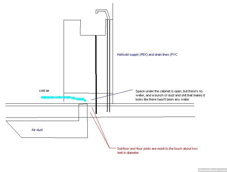

I had a sugar ant problem show up a few days ago, put out the terro, and I went under the house to see if I could find them coming in. Didn't find the ants, but I did find a wet spot on the subfloor right under the kitchen sink.
It doesn't look like it's been there for long, and I can't find any water on the floor in the house, or evidence of there having been water. I pulled the insulation away underneath and it seems like it's drying out really slowly.
The only thing I can think of is that we have an A/C vent the penetrates the floor under the sink and stops, and the cabinet under the sink has a vent cover on the toe kick, so the air comes out of the duct, enters the space under the cabinet, and then comes out of the vent into the house. The sink supply and drain lines run through that space. I might be getting some condensation and just haven't been in the crawlspace at the right time to see it.
thoughts/comments/ideas?
MS Paint sketch:

is there a gap between the duct and the subfloor? Is the duct insulated?
my first guess is that the cold air comes out of the duct and some of it gets back in the crawlspace. The cold dry air from the duct meets the warm moist air from the crawlspace and condensates around the opening/on the joists.
You can use expanding foam to seal around the duct to the subfloor. then ensure that the duct in the crawl is insulated and taped up well.

Good call. The sink drain line is sealed with mineral wool and leaks a little cold air, and the duct penetration leaks a little as well. I'll foam em both up and see what happens.
