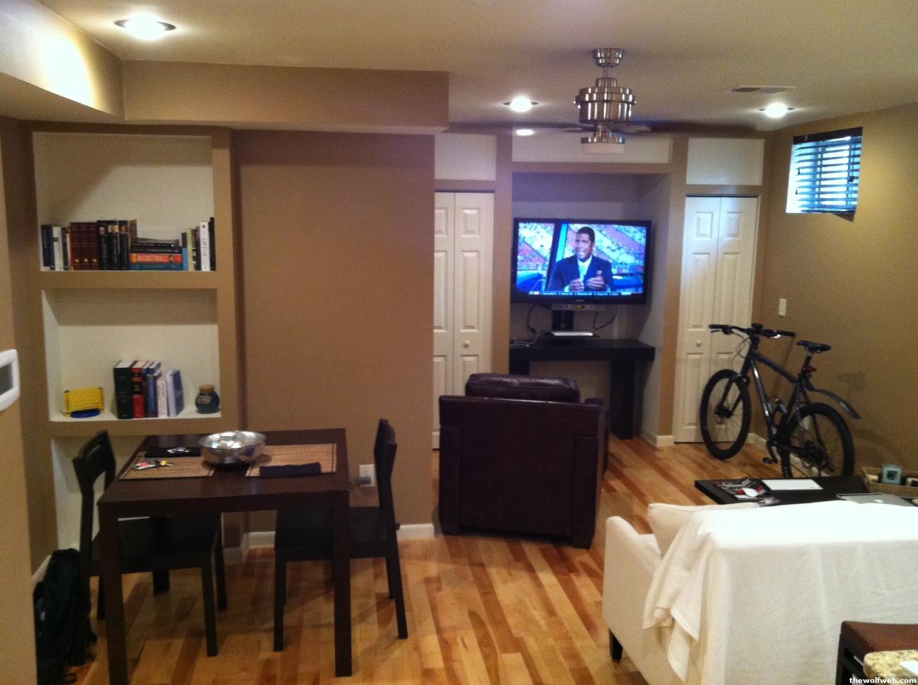

and finally tackled my living room. now i just need to figure out what to do with the short hallway between my bedroom and the rest of the place.

ceiling is finished and we are finally wrapping things up. i still need to paint 3 doors, the trim, caulk the molding, and paint the toe-kick and install shoe molding. hoping to be done this weekend but my motivation is weaning.
here is a picture journey!
started with this
then got it to this
then this
followed by this
took out the wall to get to here
then the ceiling fell resulting in this
after hanging new drywall we found ourselves here
and here we are today
