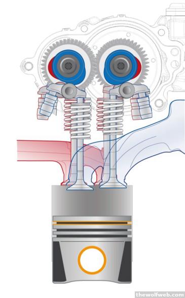

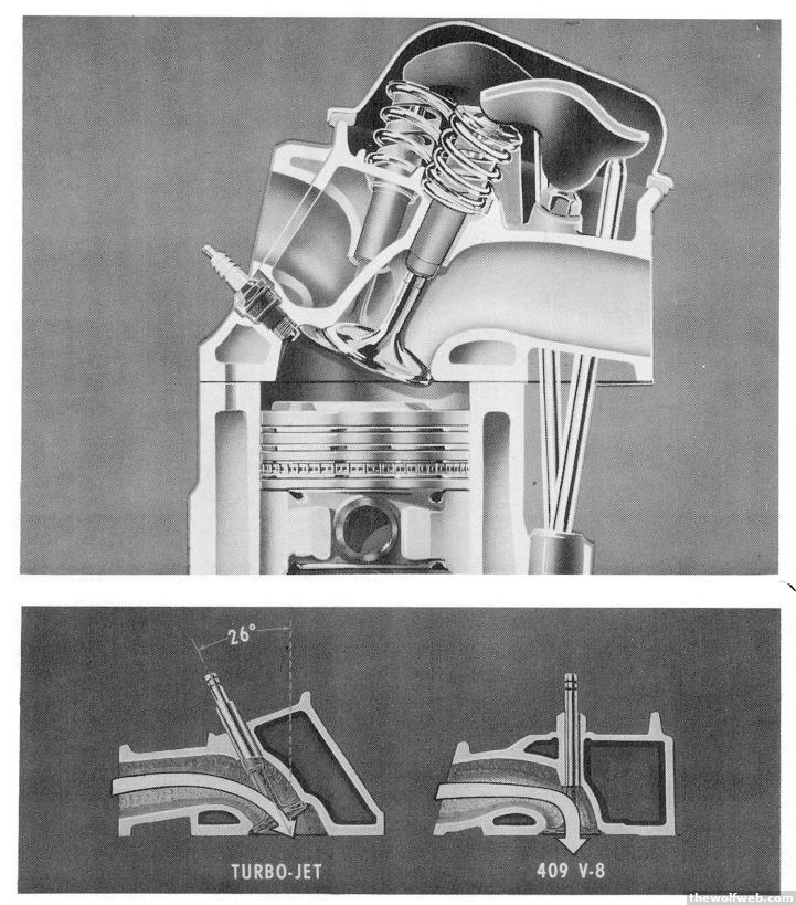

The GM "Turbo-Jet" engine family, including the 396 and 427 cubic inch variations, replaced the venerable 409 V8. This engine family improved intake airflow through a better combustion chamber design and valve arrangement:
You can see that the Turbo-Jet engines (above, and left) used a wedge-shaped combustion chamber with a more gradual transition from the intake runner to the valve and port itself.

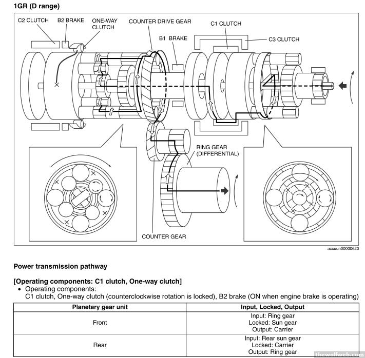

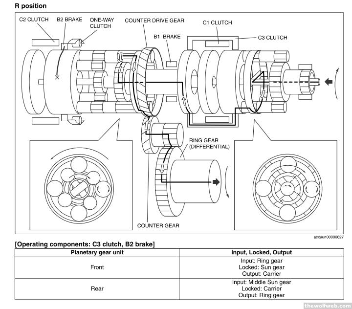

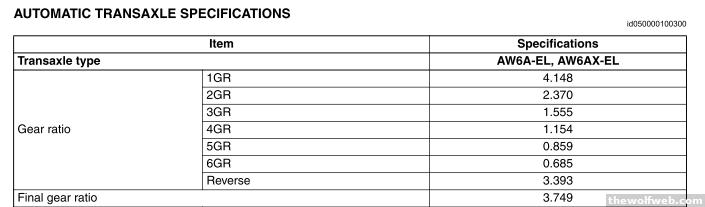

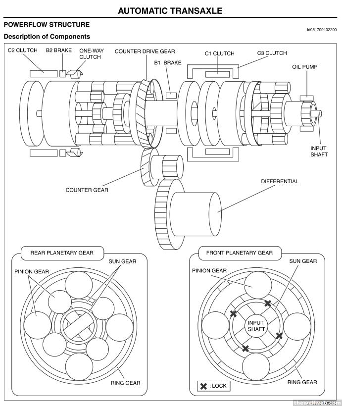

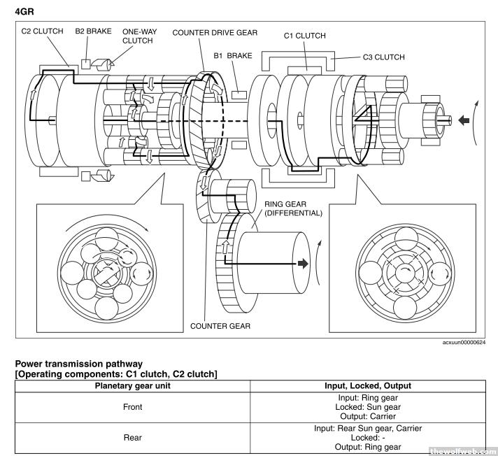

The Mazda 6 uses an Aisin 6 speed automatic (FWD/transverse) transaxle that has similarities with many other 6 speed transmissions in the industry.
Modern 6 speed (or greater) transmissions utilize a Ravigneaux gearset . A Ravigneux gearset has a front and rear sungear, a shared set of pinion gears and an additional set of pinion gears used only for the rear sun gear. A diagram illustrates better:
You will see clutches and brakes utilized to engage or hold stationary different elements of the gear system. This transmission uses a brake band/servo (B2) to hold the rear pinion carrier but many competing designs don't use bands at all anymore. These diagrams show powerflow for 1st gear, 4th gear, and reverse:
As you can see, it's pretty damn complicated.

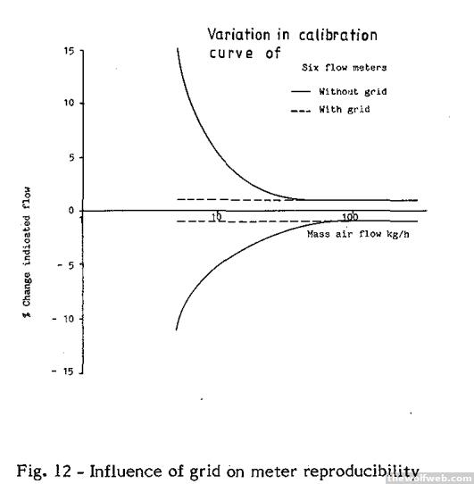

On page 2 I mentioned hot-wire mass airflow meters. There are two types of these meters: one in which the sensing wire samples directly in the main stream of intake air, and another where the air is routed into a bypass passageway. Both have their own set of tradeoffs in terms of flow restriction, power consumption, and sensitivity to flow and pulsation effects.
For a MAF sensor sampling directly from the main air stream, a mesh of some sort will be found in front of the wire. The mesh is intended to condition the airflow in front of the wire in order to have a more accurate signal. The chart from an old Bosch study shows the sensitivity of this type of MAF sensor to not having a mesh. At low airflow levels (solid line), the sensor reading can deviate greatly.
The design of the sensing wire and MAF housing affect this sensitivity.

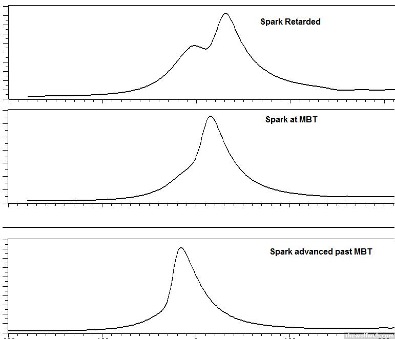

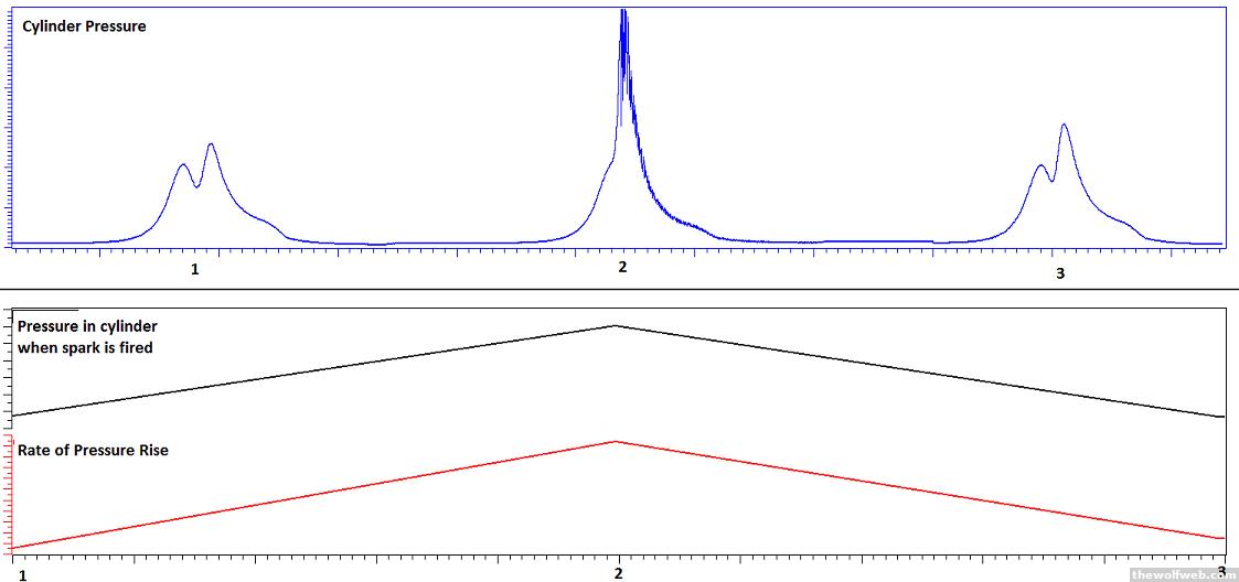

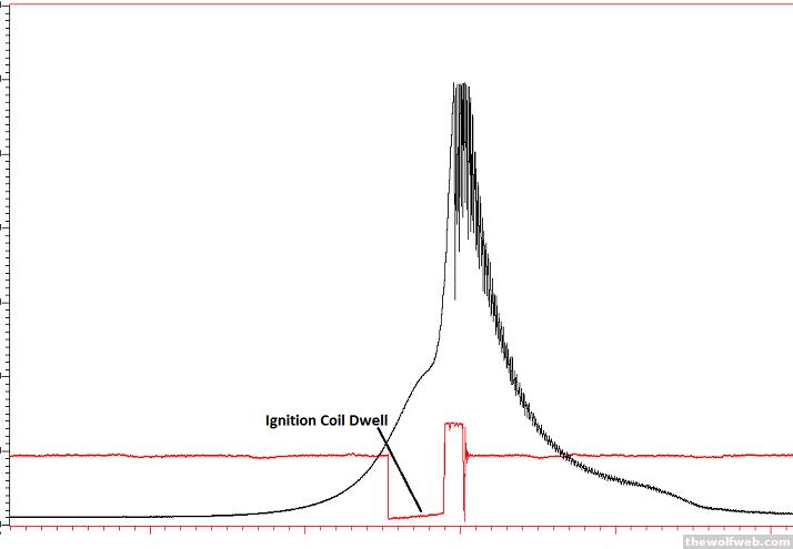

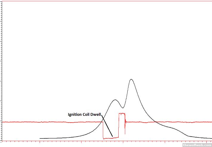

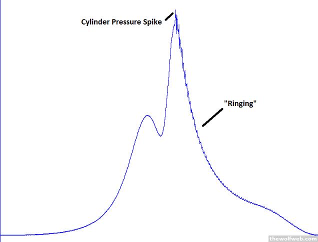

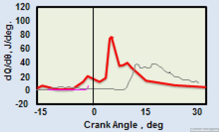

You've probably read a lot of stuff on the internet about knock, and maybe preignition. You know that they're undesirable for a spark ignited combustion engine - they can make noise, they can damage your engine if severe enough. We know knock and preignition are undesirable explosions, explosions that happen when we don't want them to happen. What exactly is happening in the cylinder though? Let's look at knock and preignition from a combustion perspective. First we need a brief introduction to combustion pressure and how it relates to spark timing. Then we can look at what happens to cylinder pressure during a significant knock event, and finally we can discuss what serious preignition event looks like.
Spark Timing, Cylinder Pressure, and Combustion Phasing
The plug creates the spark, and then the mixture begins to burn. For simplicity's sake, let's take combustion speed/burn rates out of this part of the discussion. At low speed/low load I can advance my spark very far past MBT (minimum spark advance for best torque) without encountering knock. MBT typically has the peak pressure located at about 11 degrees after top dead center firing. You can see in the image below the combustion getting more and more advanced.
Now retarded combustion has this characteristic "double hump." What happens is, the first hump (looking left to right) is the compression from the piston reaching TDC. My burning is very retarded due to spark timing, but also due to burn rates which are a factor I won't get into. The pressure begins to drop as the piston moves downward, until enough burning begins and the pressure rises again--hence, the double-hump.
Why would I retard my combustion from MBT? I need to reduce knock, and in some cases I might need to raise exhaust temperatures to spool up a turbo or warm up a cat. The more knock limited the engine is, the more of you will see this characteristic double-hump pressure trace as spark is retarded. Retarded combustion lowers the peak cylinder pressure, which may be desirable if I don't want to stress the mechanical components too much (bearings, rods, etc).
MBT combustion has a single hump with significantly higher peak pressure then retarded combustion even if there is no knocking. It's a single hump because burning is occuring much closer to when the piston is at TDC, so the pressure of compression combines with the pressure of the combustion.
When the combustion is advanced is past MBT, you get much higher peak combustion pressures and you can see the characteristic "lean" to the left.You don't have to be knocking to have high cylinder pressure. Under normal circumstances there is no reason to advance combustion past MBT. Now let's look at what happens when I start to knock.
Knocking Combustion Pressure
If the spark is too advanced for the engine speed & load for a given fuel, the gases at the end of the combustion chamber will explode before the normal flame arrives. Knock has different levels of severity. The more severe it gets, the more likely you will hear it audibly, and the higher the peak cylinder pressure will be.
In the image above, the engine is knocking significantly but probably not enough to damage the engine and probably not enough to be heard over normal engine sounds without a microphone. The severity of the cylinder pressure spike is called the knock peak while the amount of "ringing" is called the knock intensity. There are other ways to characterize knock but those are the main metrics that rely on actual cylinder pressure.
This pressure trace isn't going to immediately break anything, but a knock sensor will probably judge it as knock. Somebody somewhere had to make a judgement call as to what constitutes severe enough knock for the knock sensor to react. The knock sensor can't read the cylinder pressure, only the vibration in the engine. As the engine speed increases, both the engine vibration and the cylinder pressure get noisier.
Severe Preignition
Preignition occurs when an explosion happens before the spark plug fires. This isn't always a major problem, but severe events can happen at high load for a number of reasons. Maybe some deposits broke off inside the engine. Maybe a spark plug overheated. Maybe some debris got into the engine. There are a bunch of causes for preignition, but I want to focus on how the cylinder pressure behaves in the event of a severe preignition event.
Here are three major characteristics of severe preignition:
1) high peak combustion pressure - this is can damage your engine
2) high rate of pressure increase inside the chamber - this is a major factor in the audible noise (metallic sound)
3) high pressure at the time of ignition - this is one of the main ways we know it's preignition and not just regular old spark knock.
Below is an image showing three successive pressure combustion cycles for the same cylinder. Cycle #2 has severe preignition. The rate of pressure rise and the pressure at ignition is much higher than the other two cycles (the lower chart isn't crank angle based, don't look at it the same way as the upper chart).
If we zoom in on the preignition event and overlay the ignition coil current trace, we can see cylinder pressure already shooting up when the coil discharges.
Compare that to the image below, which is the same scaling. The coil discharges and then there is a delay until enough burning happens to raise the cylinder pressure.
You can see that there is a significant difference between a severe preignition event, the kind that can definitely damage your engine, and a moderate knock event which might call for retarding spark timing. Of course, a severe knocking event can also cause high peak combustion pressures and noise. However, unlike preignition a severe spark knock event will not have that same characteristic high pressure at the time of ignition and probably not as fast of a pressure rise rate. I hope this clears up some misconceptions about these two types of abnormal combustion.

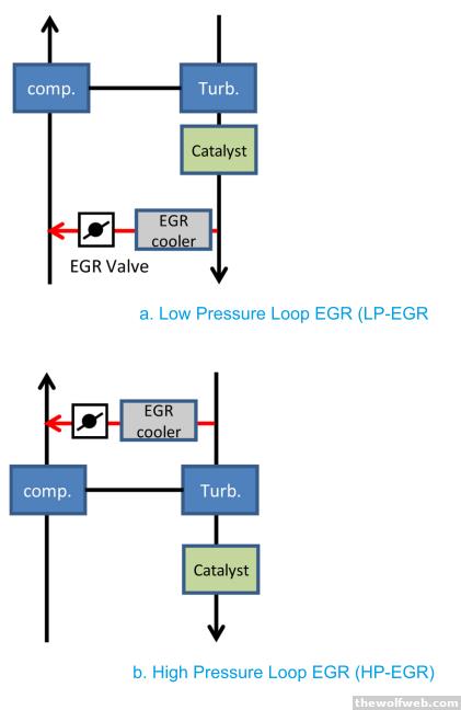

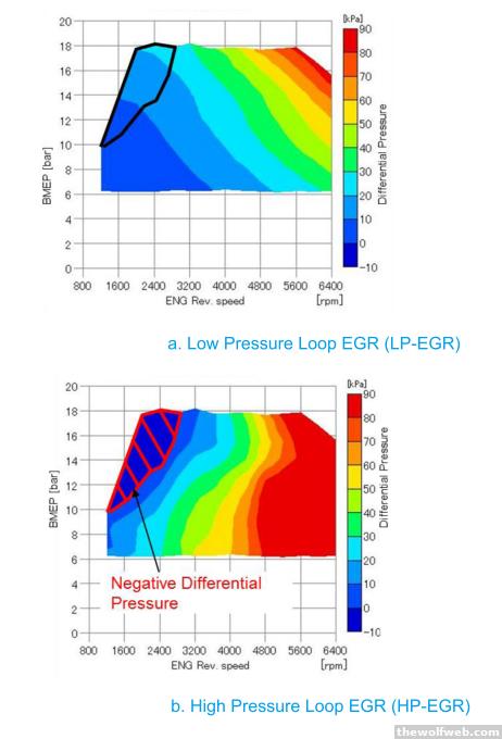

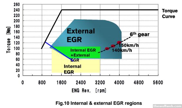

Let's talk about exhaust gas recirculation in its most modern of applications. Many of you may be thinking "ok, I'm vaguely aware that diesels use EGR now. Didn't we mostly rid ourselves of EGR valves on gasoline engines in the past 10 years?" Well, they're coming back now with the upcoming 2017 fuel economy regulations. On diesels we primarily use EGR to reduce NOx emissions. Because of the tradeoff between CO2 (fuel economy), particulates, and NOx, especially with aftertreatment, an improvement in engine-out NOx ultimately improves fuel economy.
I want to talk about EGR on turbo direct injected gas engines though. In the old days, starting in the 1970s, you had a vacuum controlled EGR poppet valve on an exhaust manifold. This would draw very hot exhaust gases into the intake manifold and back into the combustion chamber. The inert gases would reduce NOx emissions and provide a very modest fuel economy benefit. With variable valve timing/cam phasing, you can get a similar benefit from commanding overlap. So EGR valves mostly went away for gas engines.
Now they're coming back, but with coolers in-line, just like on a diesel. Some non turbo gas engines are bringing them back, like the 6.4 Hemi engine now available in Ram trucks. This draws hot exhaust from the exhaust manifold, routes it through a cooler, and then back into the intake manifold. Now Nissan is introducing cooled EGR on their 1.6 liter MR16DDT engine found in the Juke.
So for purposes of our discussion, there are two major cooled EGR configurations on a boosted gas engine: high pressure and low pressure. Diesels have these as well, as I previously mentioned.
On a high pressure system, EGR comes from before the turbocharger turbine wheel, and is drawn through a cooler and into the intake manifold, typically with a poppet valve. At low speed and medium loads, exhaust backpressure will push exhaust into the intake manifold. The point of EGR introduction affects the mixing of the EGR gases among the cylinders and also affects the risk of deposits on the throttle valve. High pressure cooled EGR is good for NOx reduction and for fuel economy and steady cruising, rather than accelerating or climbing a hill. It can be typically controlled using on-board models or a simple pressure sensors to calculate EGR rates.
The problem is, that exhaust energy will be taken away from the turbo, slowing the turbo down (reducing its achievable speed). This makes it more difficult to make boost. Another concern with high pressure EGR could be catalyst failure if the EGR valve leaks and boost shoots fresh air right into the cat and overheats it. That presents on board diagnostics challenges (OBD).
The other system is a low pressure EGR architecture. This draws EGR from after the turbocharger and pulls the EGR into the compressor inlet, usually with a butterfly valve like an electronic throttle. There's only enough backpressure to drive EGR at higher loads - more differential pressure means higher possible EGR rates. The EGR can mix very well as its drawn into the turbo compressor inlet, but the turbo needs to be able to tolerate crap being thrown at it. It needs special treatment on the compressor wheel, and it can also have icing risks in high humidity. That affects the placement of the EGR valve and design of the mixer. It can be controlled using ECU modeling but the most accurate control is with a wideband o2 sensor placed in the compressor outlet gas stream.
Low pressure EGR is intended to really help "real world" fuel economy that so many people complain about on turbo DI engines, especially an engine like the MR16DDT on the Juke. It mostly works during heavier loads at a steady state. That means towing, climbing a hill, or accelerating in high gear. Banging through gears quickly is not advantageous for low pressure EGR due to the long transit time through the engine.

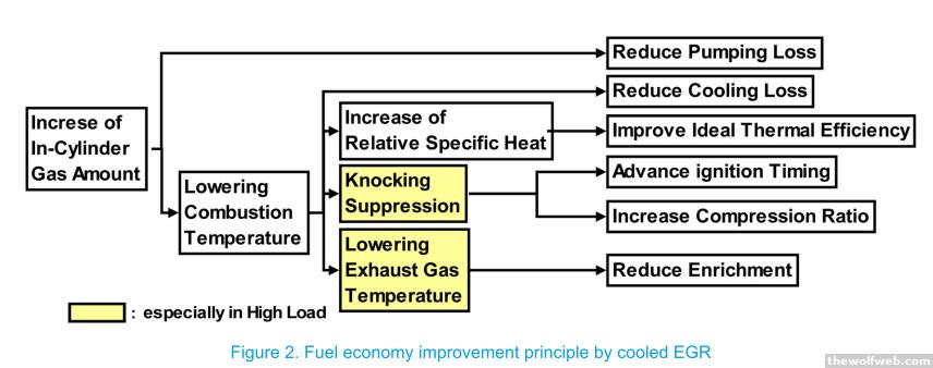

Low pressure cooled EGR can reduce knock tendency at higher loads, allowing more advanced combustion. This keeps exhaust temperatures down, meaning less fuel being dumped in when you go into boost just driving around town. At higher speeds and loads the low pressure EGR can overspeed the turbine. Typically EGR rates are limited or set to 0 at full load. With low pressure EGR running, the engine needs to run more spark timing and more boost to make a given torque. It also has to cope with hotter compressor outlet temperatures; this stresses the cooling system in the vehicle. Another disadvantage of low pressure EGR is a potentially loud droning sound at medium loads. This requires noise cancellation through the speakers, some active valve in the intake box, or disabling EGR and losing the fuel economy benefit.
Both of the high and low pressure systems have two major disadvantages: they increase risk of deposits in the intake tract, intake valves, etc. They also hurt combustion stability, causing torque fluctuations. If the combustion gets too unstable, the engine feels like it's camming just driving around the road at low load (mostly low pressure EGR and internal EGR). Most "regular" drivers don't like that feeling. There are some tricks to mask that effect, like active engine mounts. At high load for low pressure EGR, too much combustion instability can lead to a surging feeling.
To reduce the combustion instability on either low or high pressure EGR, the intake port is typically designed for high swirl or high tumble. That means either a restrictive intake port (requiring more boost to make torque/power) or a tumble/swirl control valve. Cooled EGR and modern late intake valve closing Miller Cycle concepts typically require a gazillion psi boost to make the same power as simpler turbo DI designs; this is because of low effective compression ratio to reduce knock and pumping work, as well as restrictive high tumble ports and combustion chambers to tolerate high EGR rates.
This image shows the EGR utilization on the new Juke engine. Notice that at low loads it is using overlap for hot internal EGR like a conventional engine. At mid-high loads it uses the cooled EGR. At full load it doesn't use EGR. This could be due to a design choice in turbocharger matching - the turbo would need to be sized such that it can handle the extra speed requirements of running EGR. There are disadvantages to that. Not running CEGR at full load also limits how hot intake manifold will get.

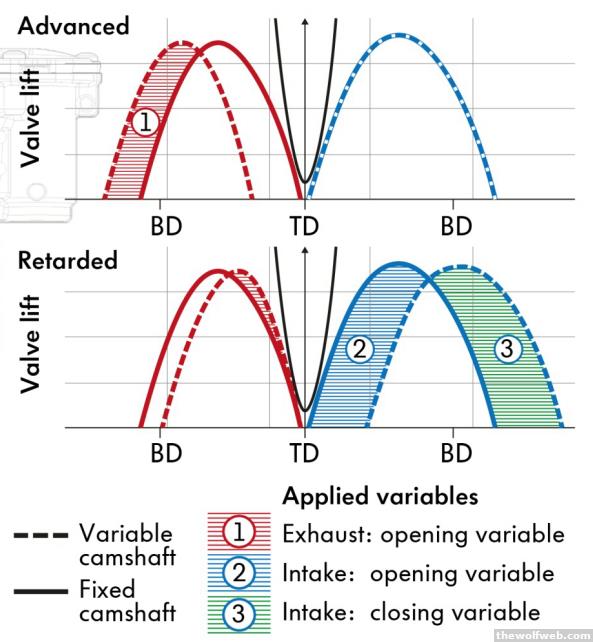

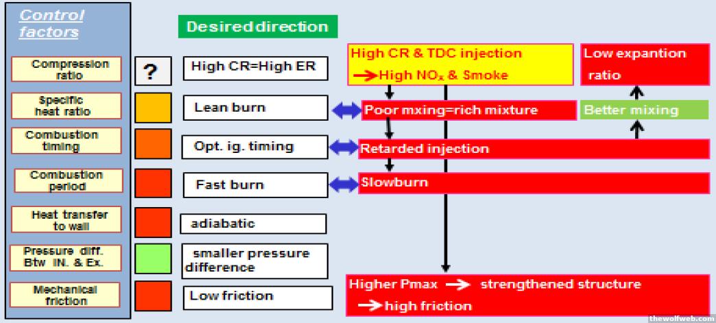

Volkswagen is now incorporating cam phasing into their newest diesel engines. Normally on a dual overhead cam engine you have one cam controlling the intake valves and one controlling the exhaust valves. The VW new diesels have a clever design where a cam will control an intake and exhaust valve on one side of the engine:
One of those camshafts can phase (I will skip details of how the actual phaser works) and one of them has fixed timing. So each cylinder has two intake and two exhaust valves, with one of each being adjustable:
So the phaser can retard the intake valve closing of one of the valves. When I retard the intake valve closing, it lowers the effective compression ratio. This is because the intake valve spends more time pushing air back out into the intake port as it ascends through the compression stroke. With a lower effective compression ratio on a diesel, you get lower NOx emissions due to lower temperatures at firing TDC.
Remember, when we can lower NOx emissions, we don't have to retard injection timing on a diesel to counteract that. The image below shows combustion heat release on an engine with a higher and a lower effective compression ratio. With the lower effective compression ratio, the combustion can be advanced by moving the injection timing (sort of like advancing spark on a gasoline engine). Red line below shows earlier and faster combustion enabled by lower compression:
When you reduce the emissions inside the cylinder you ultimately reduce reliance on complicated and expensive after treatment (particulate filter regeneration events, diesel exhaust fluid consumption, etc). The chart below, originally discussing Mazda SkyActive diesel engines, shows some of the negative effects of high compression ratio.
Now, shouldn't a lower compression ratio hurt efficiency and fuel economy? Well, the trick here is that with this simple cam phaser we offset the lower compression ratio with a longer expansion ratio. It's a similar principle to the cam phasers on SOHC and pushrod engines, like the GM and Chrysler V8's. The exhaust valve opens later, so I get more expansion work to offset the loss in compression. We can also advance the opening of the exhaust valve, creating a stronger blowdown pulse (with lower expansion ratio). That high pressure exhaust opening during the expansions stroke can help relieve backpressure and pumping work as the turbo is spinning.
With this cam phaser in the retard position we also have a staggered opening of the intake valves, because the phaser operates on only one valve. That increases swirl. Swirl is very good for diesel combustion because it helps mixing in the cylinder. Normally a cam phaser requires valve pockets on the piston so that the valves don't collide. When you put a valve pocket on a piston engine it can disturb the swirl motion; by using the offset lift you counteract that side effect, while still gaining the benefits of lower effective compression.
Mazda also uses a simple variable valve timing system on their SkyActive-D engine. It opens the exhaust valve during the intake stroke for cold start. Hot exhaust gases from other cylinders will blow back into the engine to stabilize combustion due to the low compression ratio used on the Skyactive-D.

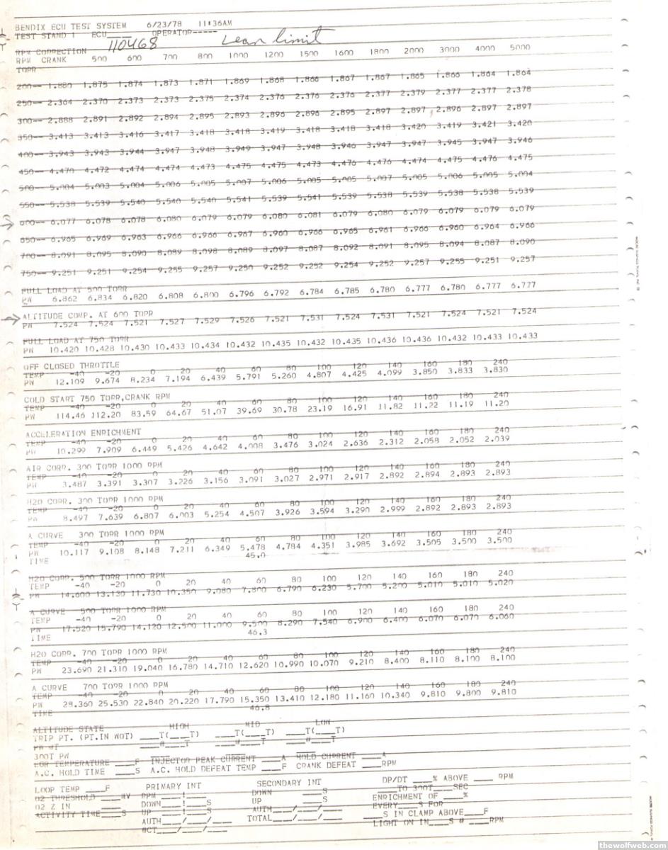

These are the maps and look up tables in the stock ECU of a 1970s Cadillac ElDorado. I snagged this from an old timer who worked for Bendix back then, when they did fuel injection for GM and were way more than just a brand of brakes you get at Autozone. I think he appreciated me listening to his stories of the good ol’ days and he let me scan it. “Maps” and “Look up Tables” are really not accurate; the stock ECU was analog and these values were input with resistors or something. It’s hard to grasp something so primitive, like trying to understand how the Egyptians built the pyramids without backhoes and cranes.
Back then they were mostly just look up tables of injection pulsewidth (firing duration of injector) versus manifold pressure (units: mm Hg, also called tor) or air/water temperature. You can even see at the bottom an area for oxygen sensor feedback, which for whatever reason wasn’t filled out. It's a primitive speed density system.

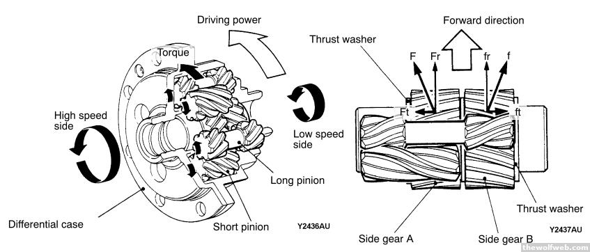

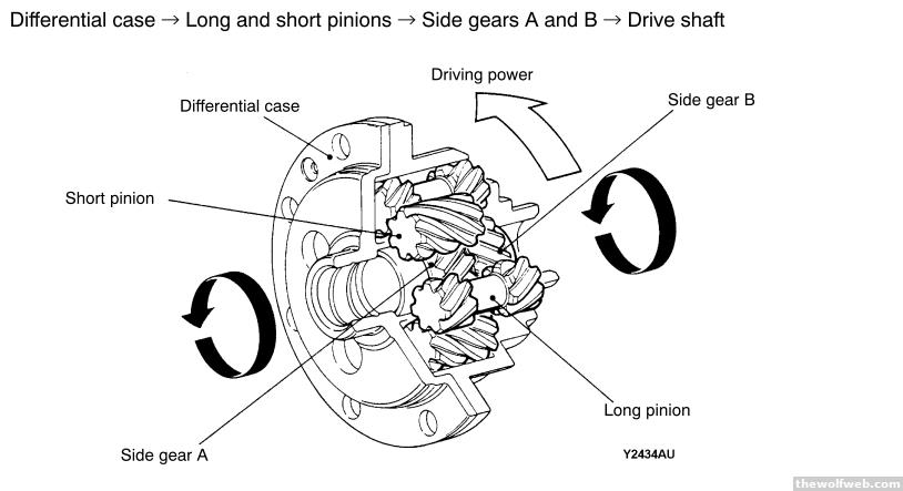

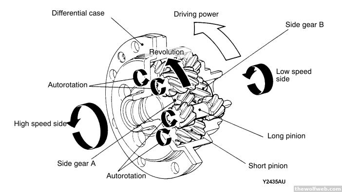

On page 2 I showed a chart that compared different types of limited slip differentials. Here are some diagrams from the front limited slip differential out of an Evo VII, which is the Helical/Torsen type.
You have differential case, side gears, and pinion gears with "long side" and "short side. When you are driving straight for basic cruising, everything pretty much moves in the same direction and you don't have differences in speed or torque applied to the different gear sets.
In a normal turn, there is a difference in speed between the side gears. This makes the pinion gears on the faster turning side rotate backwards so that the inner and outer wheel of the vehicle can move at different speeds.
Now here's a slipping condition. Say one wheel hits ice and the other is on pavement. The wheel that hits ice would be the high speed side here, with the wheel contacting a lower friction surface. The gears are constantly in mesh, and when the high speed side slips, it creates a series of forces in the various gear sets that work against the thrust washers (axial direction) and differential case (radial direction). Remember, all the gears are connected, so they are all pushing back on one another. The gears, thrust washers, and differential case are designed so that a friction torque is generated to provide limited slip functionality.

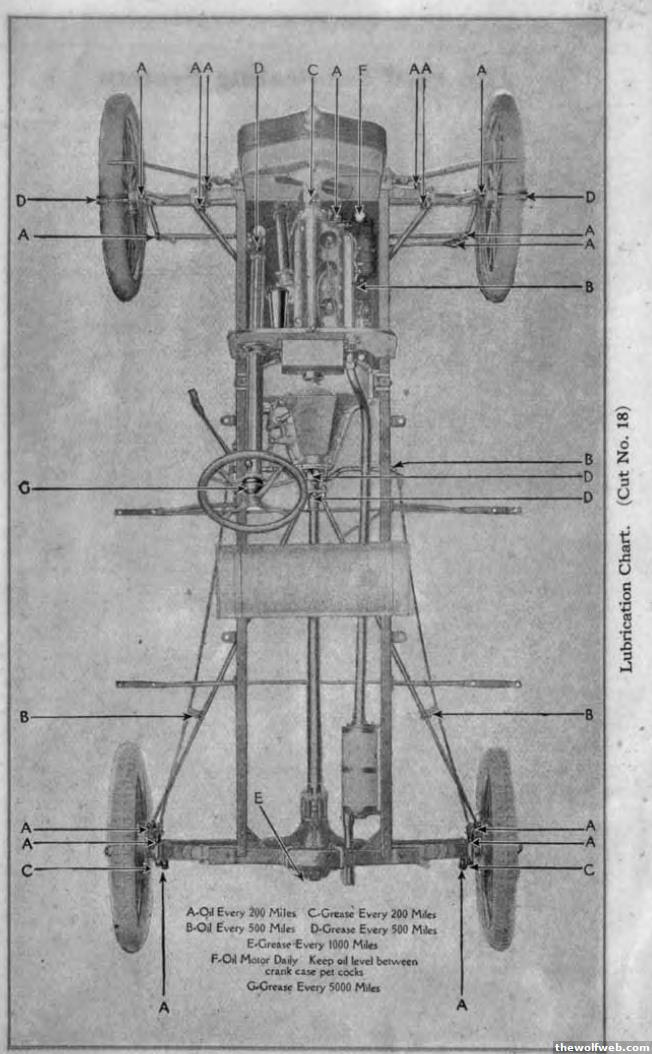

Today you might be able to go up to 10,000 miles without changing your engine oil on a modern vehicle. People don't realize though that early automobiles required regular lubrication of the chassis, steering, and suspension components. Here is a lubrication chart for a model T:
Notice how parts of the vehicle required new grease every 200 miles. Now I'm sure people slacked on that to some extent, but you can be sure that accelerated wear would occur.
Rolls Royce actually had a system built into their vehicles that would lubricate the various joints for you. This must have been a very convenient feature back then. Of course, if you owned a Rolls Royce you probably had paid staff who could lubricate the thing for you anyway. And you probably never drove your own car. And you probably had to pay to fix that lubrication feature. So maybe it wasn't as much of a benefit as it might seem.
