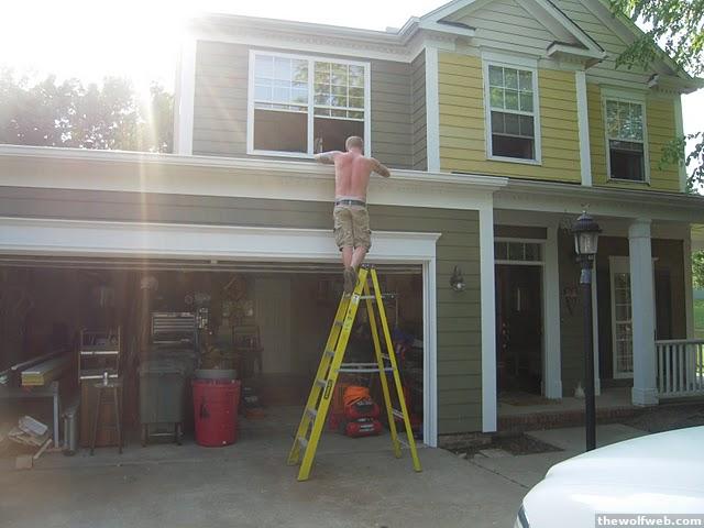

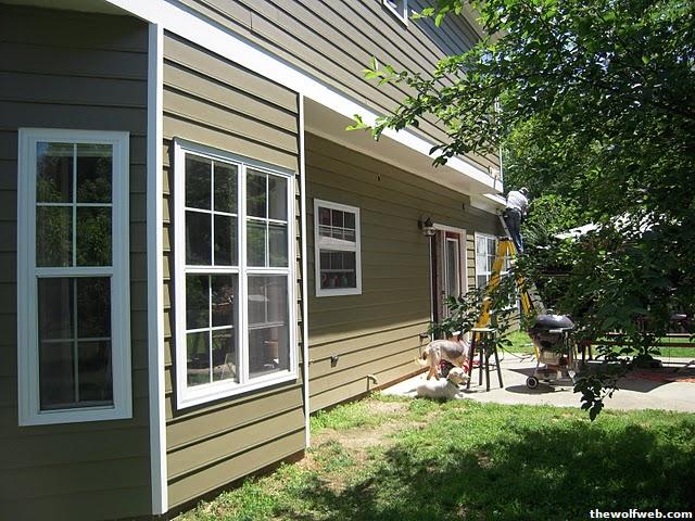

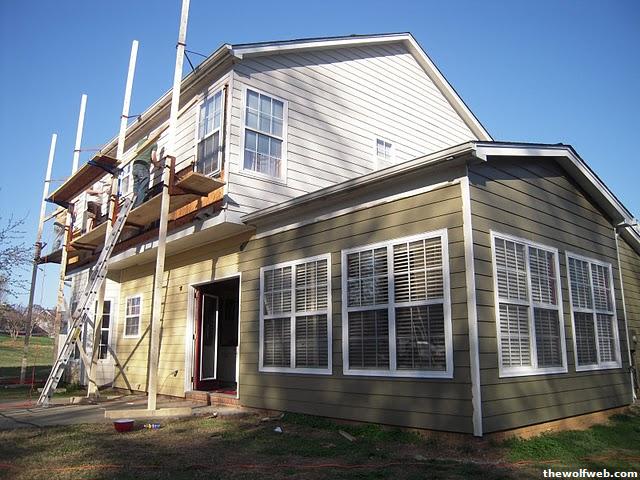

i skimmed the previous 49ish pages iso anyone doing siding replacements - but saw none
so, with that said, is anyone doing any minor or major replacements/repairs to their home's siding?
my house was covered in junky masonite - some still ok, but mostly it was a wreck.
i'm replacing with the same style, smooth beaded 8.25", but with hardieboard. -
5/23/2011 4:29:16 PM
93320 Posts
are you doing the work yourself? what are the supplies going to run you? (ballpark?)
5/23/2011 9:15:38 PM
schwank
2785 Posts
yes, i'm doing it all myself.
a 12' stick of siding runs 6.3- paint is 29ish per gallon
i donno, i got quite a few estimates for just the necessary repairs to the siding and trim and i was blown away. for example - the bottom couple rows of siding all around the house were pretty bad off - so they needed to be replaced. the white vertical trim boards were pretty much toast after soaking up water and from never being caulked. so a few things here and a couple things there, bam - 6k repair bill.
so ya, 6k is wayy more than i need to replace almost every stick of that siding, trim, and paint that som-beach - we're almost done too -
5/24/2011 9:53:52 AM

I replaced a couple of rows of siding on the front of my house last summer with the smoother hardieplank. I have several places that the previous homeowner repaired rather crappy and other areas where the paint / surface of the masonite has deep cracks and needs to be replaced. I've been contemplating getting pre-colored hardieplank but haven't decided what I want to do. It looks like I need a permit in Raleigh for siding work?
I also have a bunch of fascia and soffit that needs to be replaced because the previous owners didn't take care of the gutters.

schwank
2785 Posts
i dont believe that you need a permit and if you can get a close enough paint match, i wouldnt bother with the pre-painted hardie - it's quite expensive - -

schwank, how difficult a job was replacing the siding, and about how long did it take you?
5/26/2011 9:58:26 AM

schwank
2785 Posts
wlb420 - the hard part is piecemealing it. because of the way most of the Masonite was installed in my area, inserting a piece here and there to replace damaged boards results in a hella ugly finished product with massive gaping holes from where you had to back nails out.
if you can afford the time and money to do larger areas, you wont regret it.
5/26/2011 2:26:24 PM

9053 Posts
Well, my house is 3/4 brick, so there isn't too much to replace (and only a 1 door and 3 windows to deal with)...I was thinking of just doing it all....rough estimate of 400-500 sqft.
5/26/2011 3:46:31 PM

schwank
2785 Posts
wlb420 - knocking out 500ft, depending on the location *(like a 2nd floor with requiring scaffolding would take longer) i could knock out in a weekend - demo/installation/caulk - everything but painting *(unless i got lucky)
bonus if you have someone that can cut while you work - sawing the hardie is a bit slower than if you were chopping a wood based product
i did the top section in three days, all with the exception of the very top of those peaks where the siding was actually pretty protected and didnt need to be replaced. did the siding, the white vertical end trim, caulked, and the miss painted one piece -
5/31/2011 9:21:46 AM
