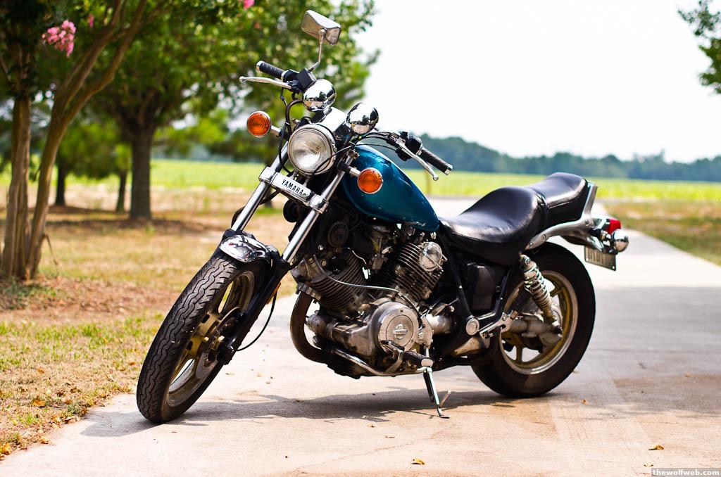

Threw together a new seat cover for the Virago today. Material is marine vinyl from JoAnn's, about 1/2 a yard worth. I took apart the old seat cover and basically reproduced it piece by piece. Making the thing was much more difficult than I had anticipated, and putting it on was no easier. I can see why seats cost so much to have re-uphostered, because it's something of an artform. Mine is not exactly centered, but it's not terribly noticeable. It's not great, and it definitely isn't perfect, but for $8 worth of materials and a few hours, it was a good learning experience if nothing else.
7/17/2011 1:33:13 PM

Well, it's done - and it's about to be up for sale.
A good deal on a track bike has come my way, and I just can't let it go. The only way to afford it (and fit it in my garage) is to move one out, and selling this guy should get me enough cash to pick it up.
All told I had to do the following to get from day 1 to where it is now:
Charge battery
Rebuild brake calipers
Clean brake pads and rotor
Replace handlebars
Overhaul and recondition front forks
Replace engine oil + filter
Replace final drive gear oil
Clean and adjust carburetors
Replace fuel and vacuum lines
Rebuild petcock
Replace carb intake boots + o-rings
Replace spark plugs and caps
Strip, clean, and seal fuel tank interior
Re-cover seat
Replace grips
