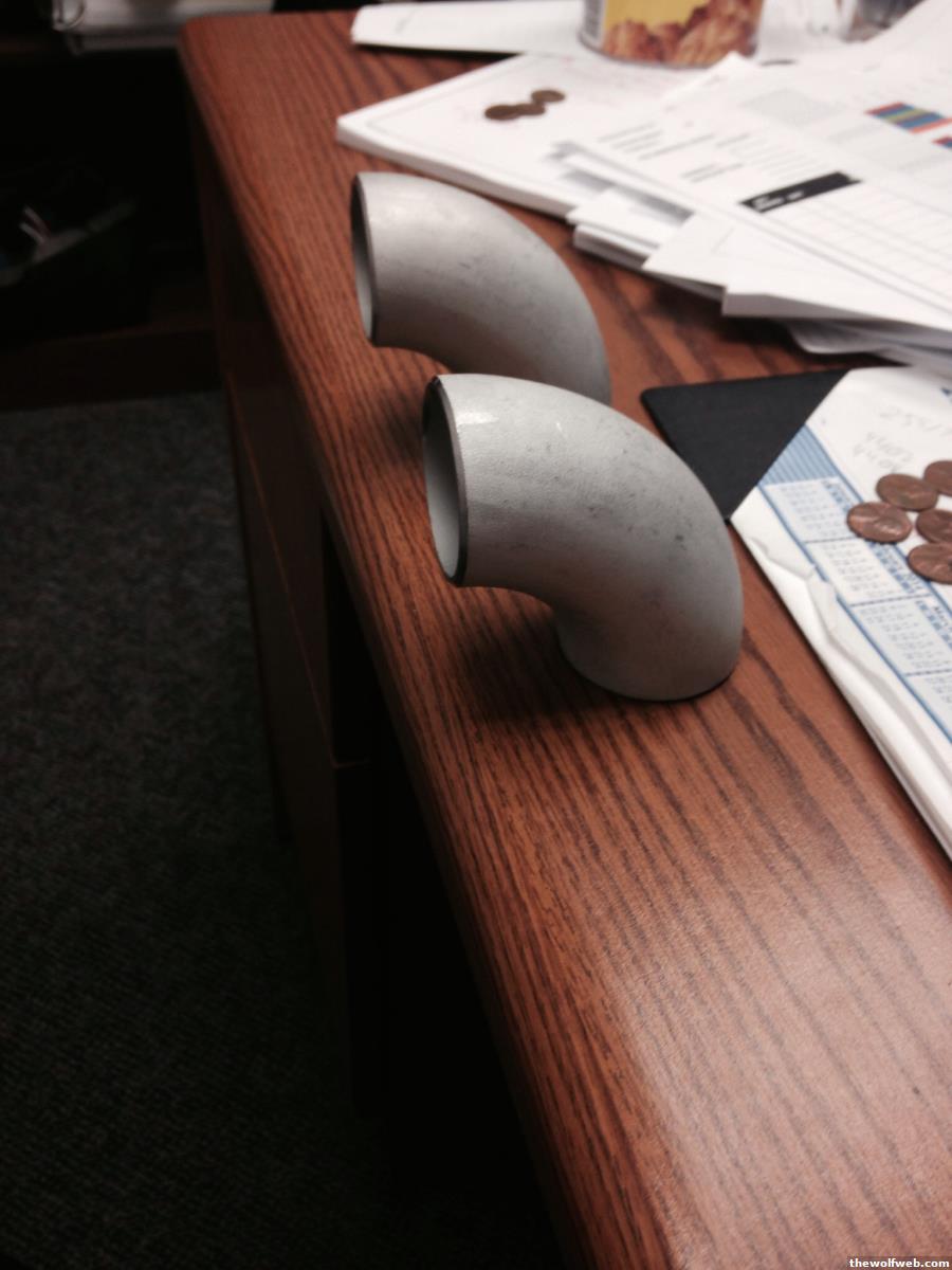

Because ss headers...

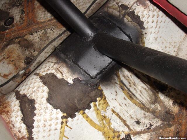

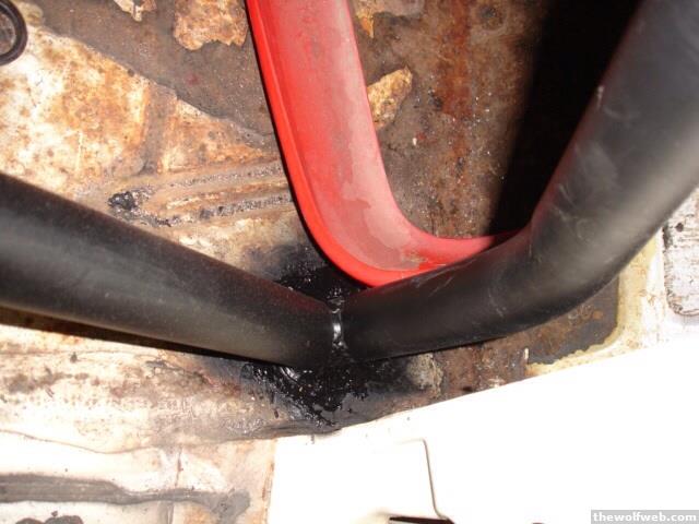

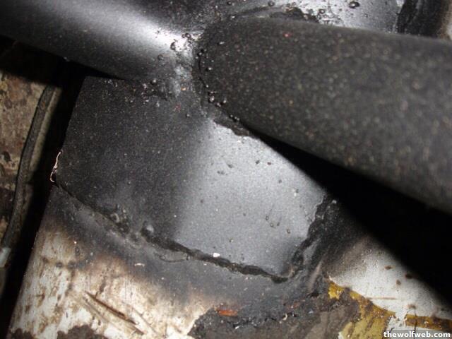

Is it bad the guy who's doing my sfi certified cage I want to go back and clean up his welds with my tig?
4/10/2014 8:06:18 AM
Dr Pepper
3583 Posts
is that tube welded to a plate, which is welded to the body? or is that just a cover plate for the hole?
I wouldn't do any cover passes - make them brittle
[Edited on April 10, 2014 at 8:18 AM. Reason : MSE200/yada dada]
4/10/2014 8:09:41 AM
I wasn't going to do it... I was just unimpressed with that weld lol.
Cover passes will just make it worse structurally .
4/10/2014 8:23:07 AM
adam8778
3096 Posts
"unimpressed"
that is putting it lightly
4/10/2014 8:32:21 AM
Yeah I know
4/10/2014 8:53:26 AM
Welds are being re done by certified welder. I told them it looked like their wire speed was a little high and their weld speed was inconsistent and they were like holy crap this guy knows what he's talking about.
