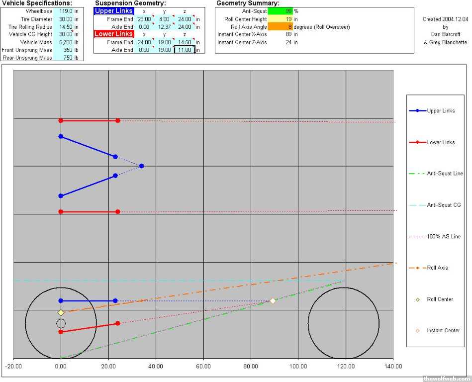

here's a pretty close calc sheet for my suspension

i think you're definitely going to want to raise the IC and get the AS number somewhere around 100% or higher. put the IC up around the CG height on the Z axis and see where that give you. where abouts are you estimating the CG to be on the X axis? IC length looks like it's probably okay, but it wouldn't hurt it to be shortened a little.
anyway, just those minor changes should get you pretty close to a good setup. it should be able to be fined tuned as you add power within any adjustment on the control arm brackets and the shocks f/r.
7/25/2008 8:08:21 PM

So I updated the sheet, I'm closer than before with my real numbers (CG, etc.), and the AS is looking good. There will probably be one more iteration of the calc sheet before we actually finish the suspension.

yeah, that's looking pretty close for a driveway build.

^^haha, no offense intended... just saying it's not going together on some fancy chassis jig.
^i would assume they're building some adjustability into the lowers, that's only where you really need it for something that's not a dedicated race machine.

^exactly what we did. The adjustable lowers will allow us to fine tune pinion angle and any wheelbase woes. I'll have adam post up our final 4-link sheet, i'll have to say it came out pretty close to 100% AS.
^^The control arms are way overkill, but a good street application imo. Other than the adjustable lowers, the only adjustable parts will be +/- 1/2" or so on the coilover mounts for fine tuning of the ride height.
