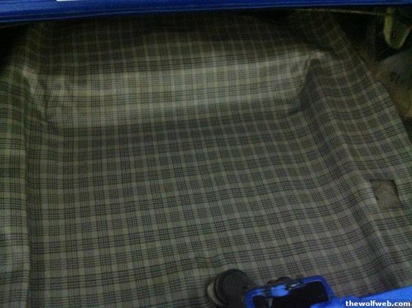

DoeoJ
has
7062 Posts
new trunk mat to hide the ugly bare metal haha.
also, spare that came with the car is looking rough, so i'm going to get a 5th rim/tire when i get around to figuring out exact what kind/size rims the guy had on it when i got it.

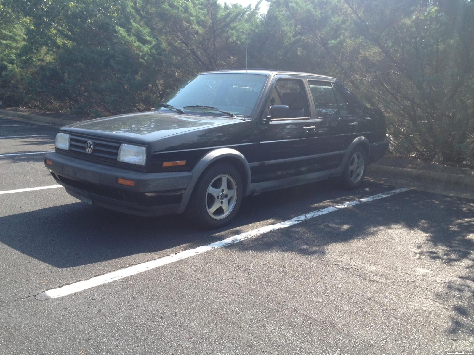

toyotafj40s
8649 Posts
this is the ride that I have been tinkering on
8/17/2012 11:20:22 AM
