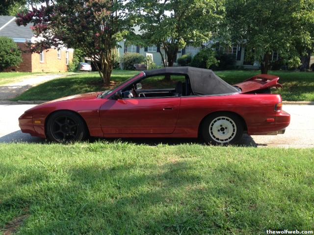

8649 Posts
Did not upgrade to coil overs.. Does not compute.
Bigger turbo and sending ecu out for retune tomorrow. Maybe q45 brakes too.' i just don't know if there will be enough time'
7/30/2012 11:48:10 PM
jawhitak
328 Posts
q45 front brakes, i assume? what rears? z32? z31/altima?
7/31/2012 12:02:40 AM
toyotafj40s
8649 Posts
Stock rears. Altima what year is bigger? I hear q45's up front don't destroy the braking bias

jawhitak
328 Posts
"Stock rears. Altima what year is bigger? I hear q45's up front don't destroy the braking bias"
non-turbo Z31 rear caliper brackets (the bracket that attaches the caliper to the upright), '03 Altima rear rotor, and your stock S13 caliper/pads.
^ that's what i'm running out back. super easy to install, you don't even have to bleed your brakes. basically the bracket spaces the caliper away from the hub for more braking leverage, and the Altima rotor is larger in diameter to fit perfectly in the caliper again.
i'm also using q45 fronts. direct bolt-on. Q45 rotors, Q45 calipers, Q45 pads. your stock brake line still fits right where it should. this one is also very easy to install.
oh, i should also note: aren't you 4 lug? Q45 fronts and Altima rears are both 5 lug. either redrill the rotors for 4 lug, or get 5 lug hubs. orrrr just get 5 lug rear hubs, and redrill your stock front hubs to 5lug like a BOSS
old write-up, still applicable for S13s.
http://zilvia.net/f/archive-faqs/291877-diy-z31-2003-altima-rear-rotor-upgrade-s14-calipers.html
