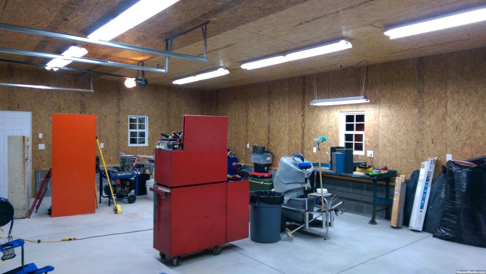

passed electrical rough-in today. rented a panel lift. gonna try to put my ceiling up tomorrow (OSB). then i just have to put in the switches, outlets, and light fixtures and i should be ready for electrical final and building final. i'll do the insulation and wall sheeting after final inspection.
3/6/2015 10:21:50 PM
35756 Posts
got half of the ceiling up. gonna have to hit it again this coming weekend.
3/8/2015 7:17:50 PM
35756 Posts

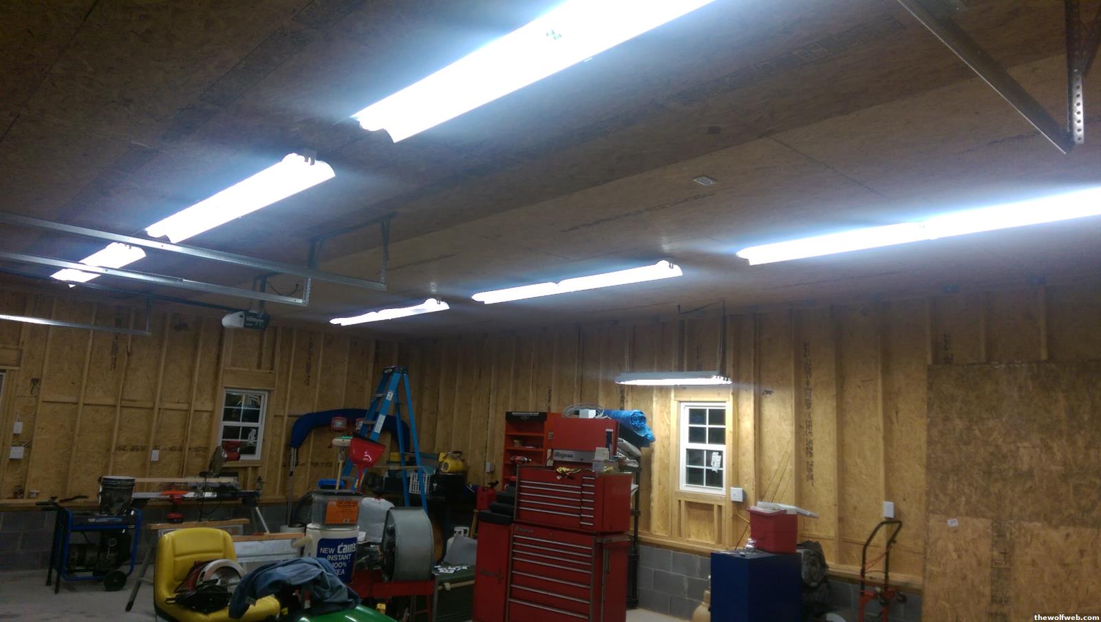

finished putting up the ceiling. hung the lights inside. got my outside lights in too. all i've got left is hooking up the ground wire to the ground rod. i pulled a ground wire along with my service from the house panel because the NEC book says you don't need a ground electrode on accessory structures if you do that. the dumbass inspector down here says i need that wire as well as a ground rod. anyway, i should be able to knock that out tomorrow and then i'll call for electrical final and building final this week. gonna go ahead and insulate the walls and sheet the walls with OSB after inspection. also going to put in a 220 volt 50A outlet for a welder
had to go to 3 different home depots to get those six 8' fixtures. no store around me had more than 2 in stock.
[Edited on March 14, 2015 at 9:44 PM. Reason : really happy with how this shop came together]

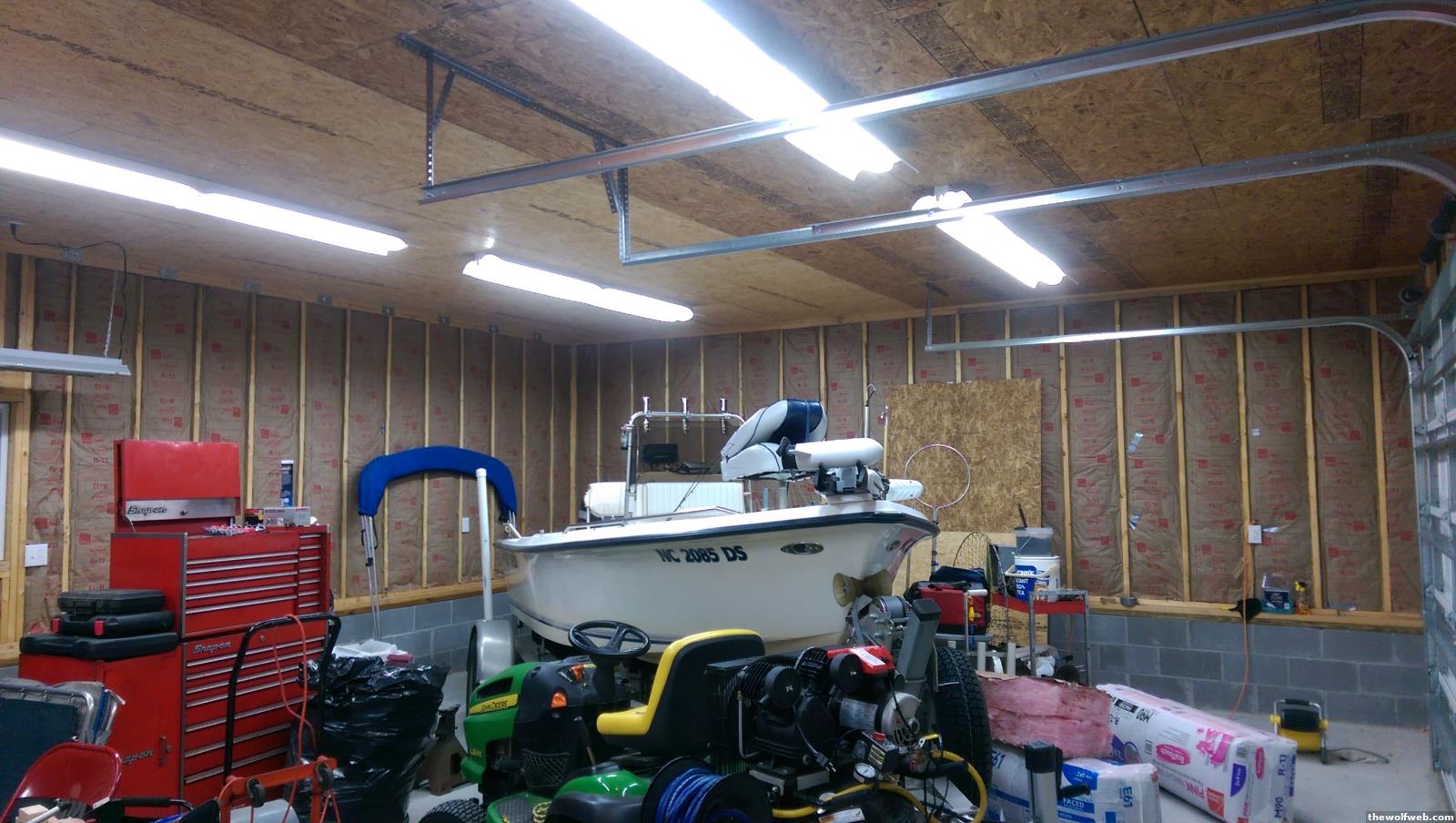

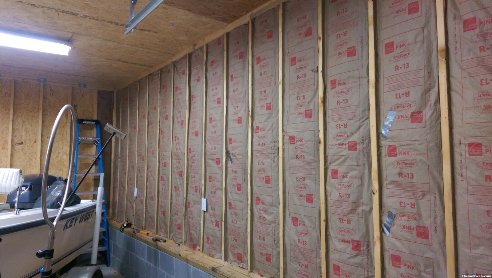

picked up some R13 and R19 (my front wall is 2x6) today and got started. just fyi, if you intend to hang insulation, get a staple hammer. i started out with the regular lever-style staple gun and my hand was cramping up in no time. my loving wife stopped on her way home and grabbed me a staple hammer and i was able to move a lot faster, then i ran out of staples .
[Edited on March 16, 2015 at 10:00 PM. Reason : nice to have lights so i can get work done after work now]
3/16/2015 9:58:41 PM

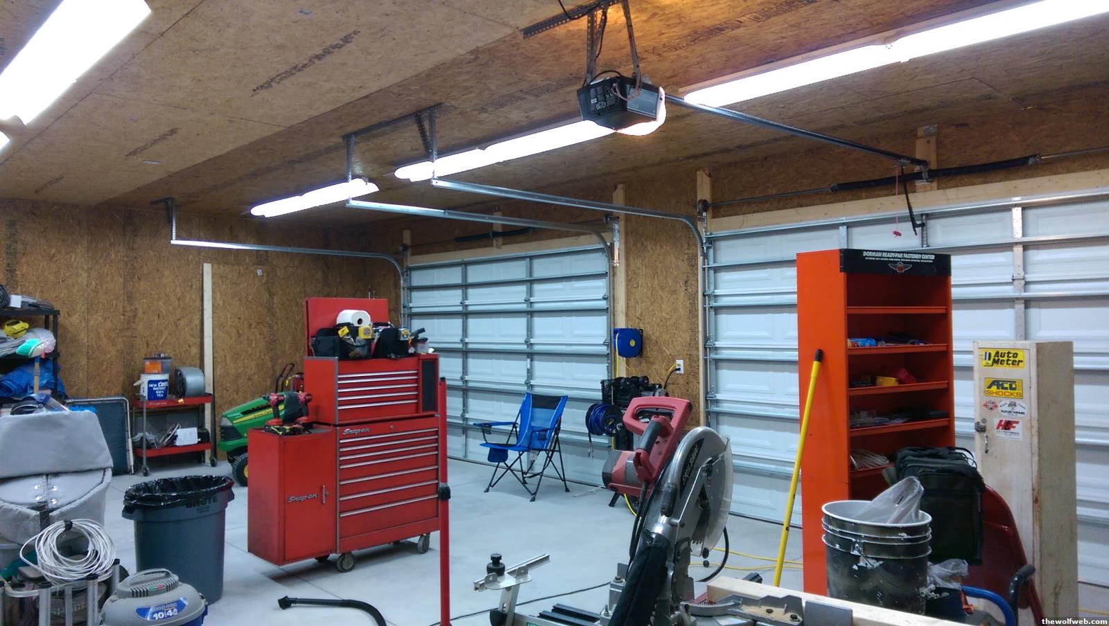

35756 Posts
inside walls are covered. hung 26 sheets by myself. sucked.
[Edited on March 22, 2015 at 10:57 PM. Reason : shelves are next.]
3/22/2015 10:57:18 PM

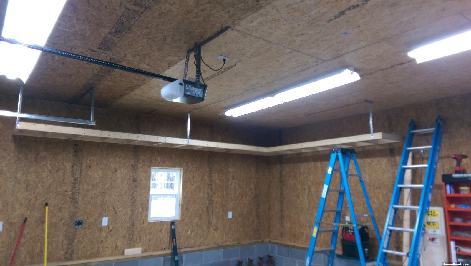

Built some shelves for rarely used stuff. 24 ft long and 2 ft deep.
3/28/2015 7:43:02 PM

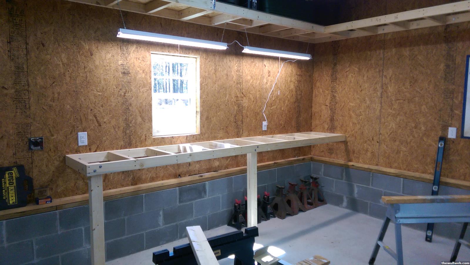

12' long 2' deep 42" high workbench. this thing is solid. got some 3/4" MDF and 1/8" masonite to put on top of it. two 4' LED strip lights above it.
3/29/2015 4:57:43 PM
