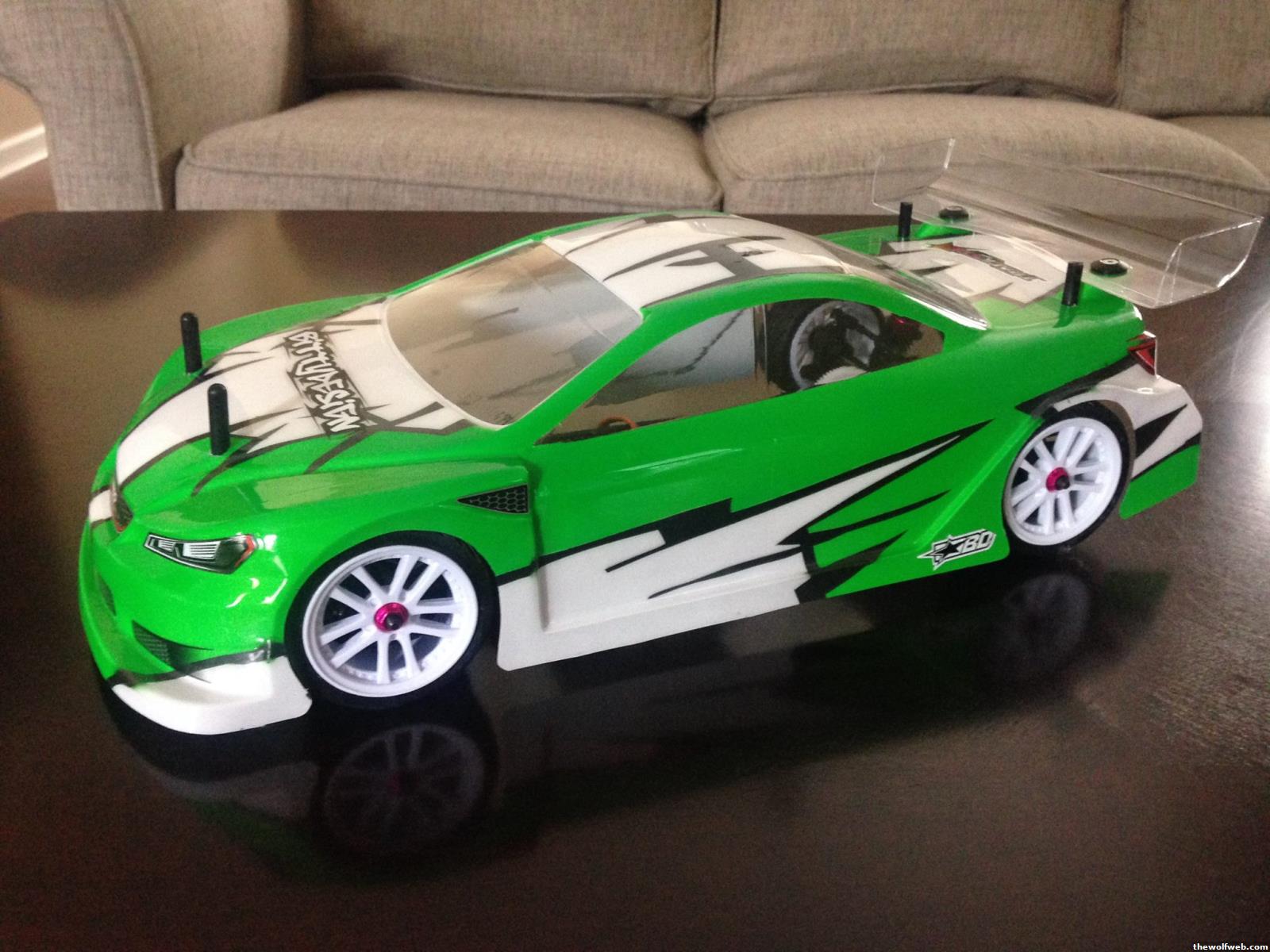

Here's my latest body I painted for my touring car:
Didnt turn out too terrible for a rattlecan and masking tape job. I REALLY want to get an airbrush though. Also gonna pick up another practice/bashing body that I'll probably just spraybomb a single color.

That is a good looking paint job. I have a hard time putting a lot of time and/or money in a paint job for an off-road buggy. It's just going to get destroyed over time.

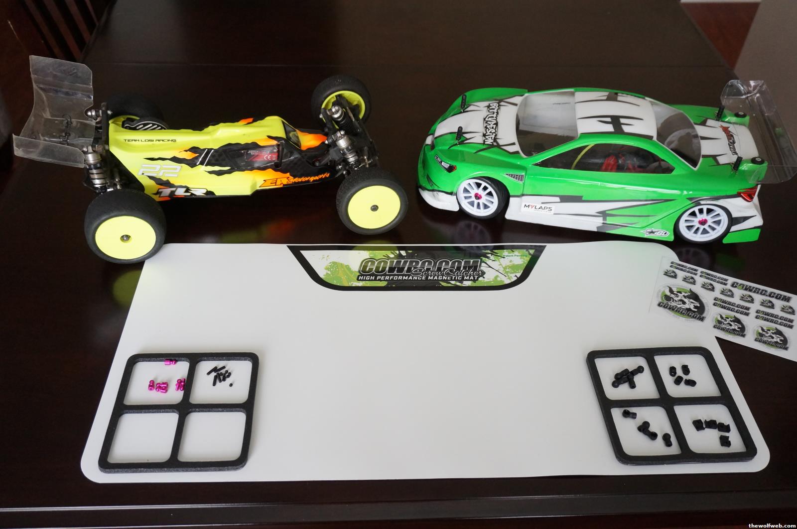

i like those magnetic mats. i was looking at cow rc's parts trays just the other day. ended up just buying some RPM plastic parts trays for ~$3 each. they have a tiny little magnet that isn't really sufficient, so i was just going to shoe goo some real magnets onto the back of it.

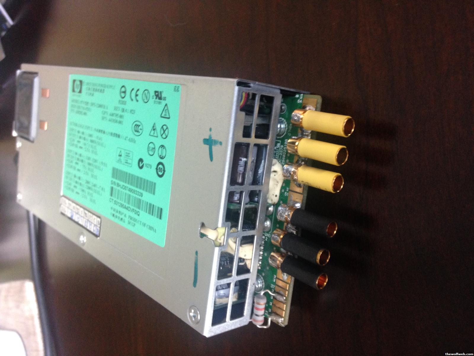

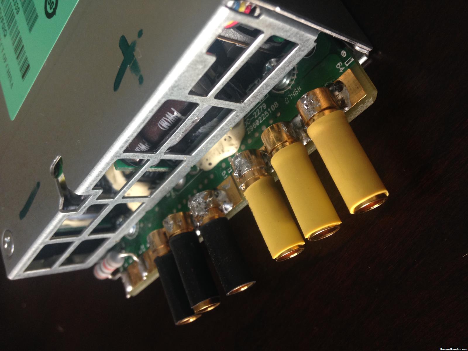

The power supply I use is a HP DPS-1200FB A
Specifications:
Input: 110V-120 Volts AC
Output: 12V DC, 75 Amps, 900 Watts
Only Measures 3.375" x 1.50" x 9.50"
Detailed instructions on the conversion:
http://www.rchelination.com/setting-hp-dps-1200fb-power-supply
Given the rugged nature of these particular PS (Redundant and Hot-Swappable) they hold up much greater than a typical PC Supply.
Here's mine:
