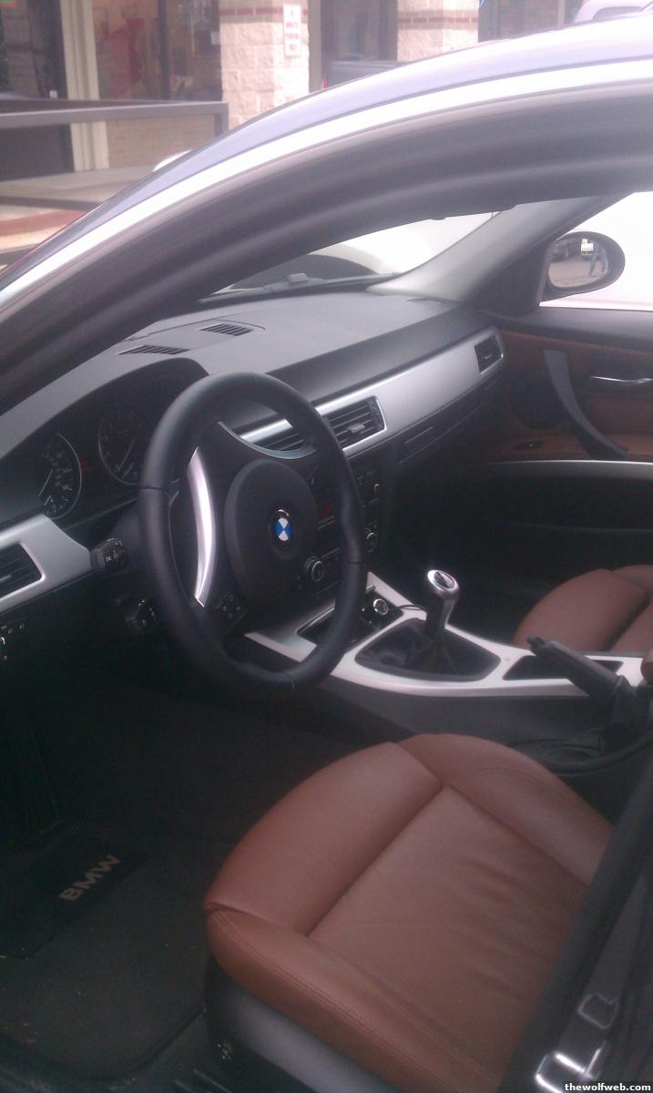

slightly off topic at this point, but I finally got my trim switched out

just drove mine 4200 miles cross country. boston->NC->SF. broke down and went to limp mode on a mountain at 11,000 feet in very rural southern Colorado. Had to drive 374 miles to SLC to get it fixed. That was the nearest dealer. actually there is only one dealer in entire Utah! next nearest was Las Vegas 500+ miles. Crazyyyy! Of course it happened at 9pm on a Sunday. vacuum line going to wastegate actuators bla bla bla...drove 6 hours in limp mode, slept in dealer parking lot. great night!
so far 3 dealer trips and 14k in 4 months of ownership. 74k on odometer.

^^damn you've had horrible luck with that car
also here's your pic:
5/30/2011 12:01:58 AM

New BMWs scare me, a lot. This is the reason I like 996s so much, but maybe I've been dodging a bullet on those as the internet keeps saying they're terribly unreliable.
Anyway, nice job on the alu. trim, looks nice. Also, get these pics working people, I wanna see more hawt BMW action!

^^^yes, E46 is missed!
^^thx, imageshack started some gay registration? not sure what is going on. i did have bad luck, but car is first year production and i knew that going into the purchase. luckily CPO is still there.
