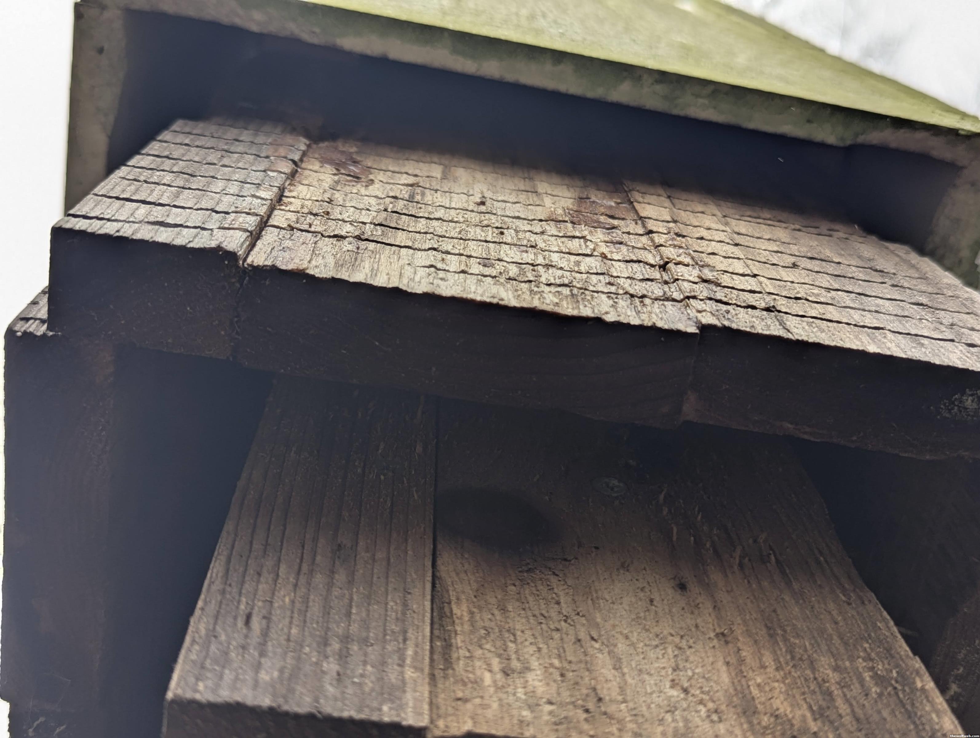

Guess I never shared these, but here is what the inside of the bat box looks like

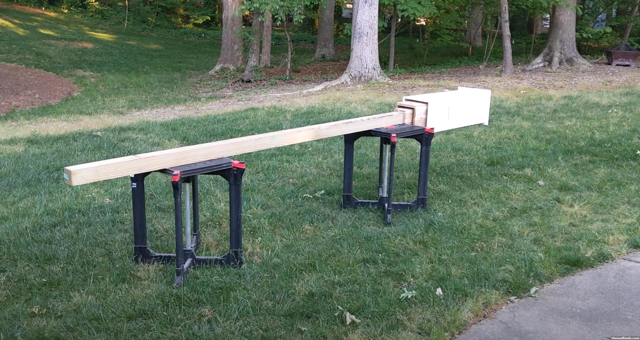

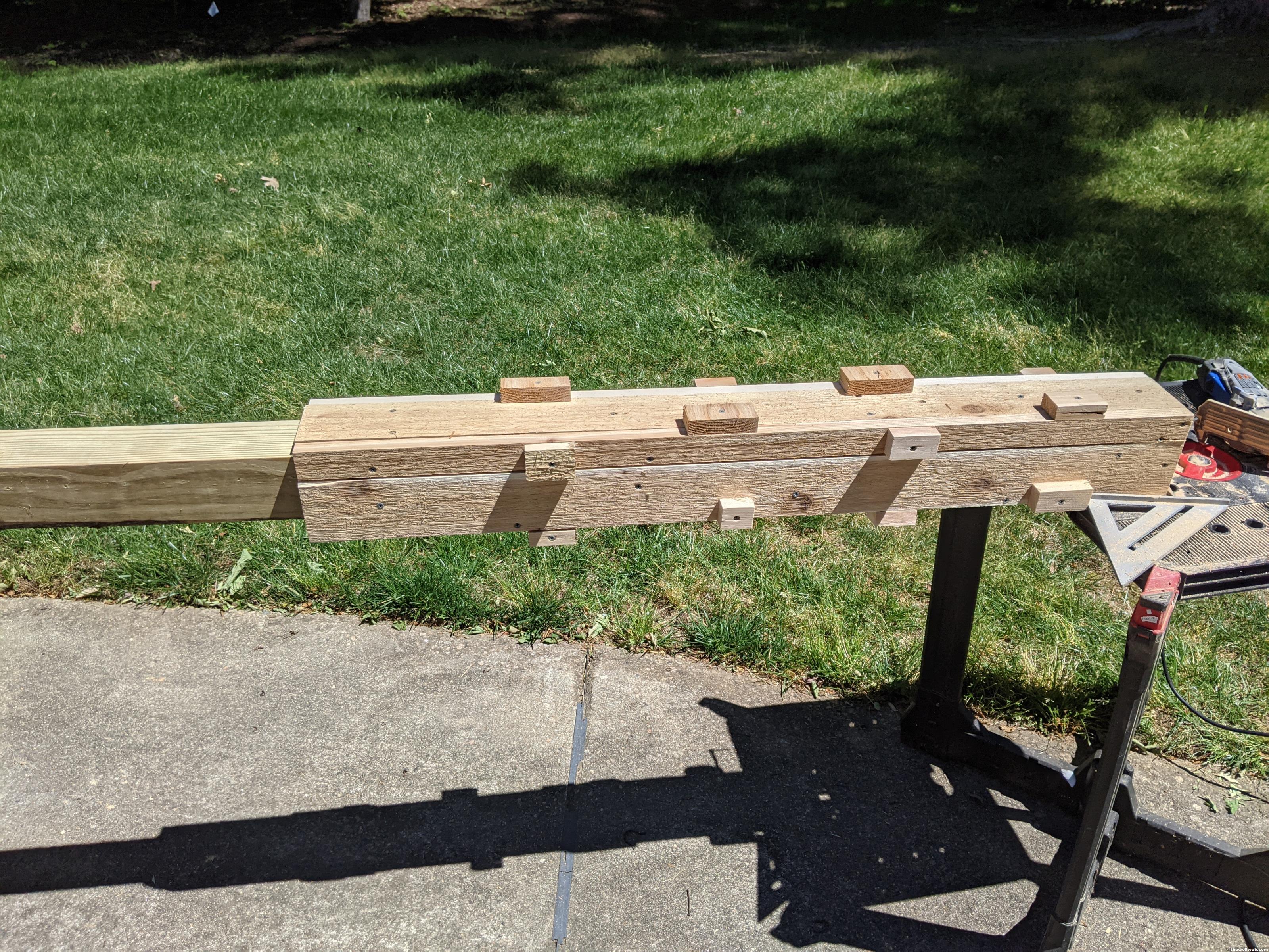

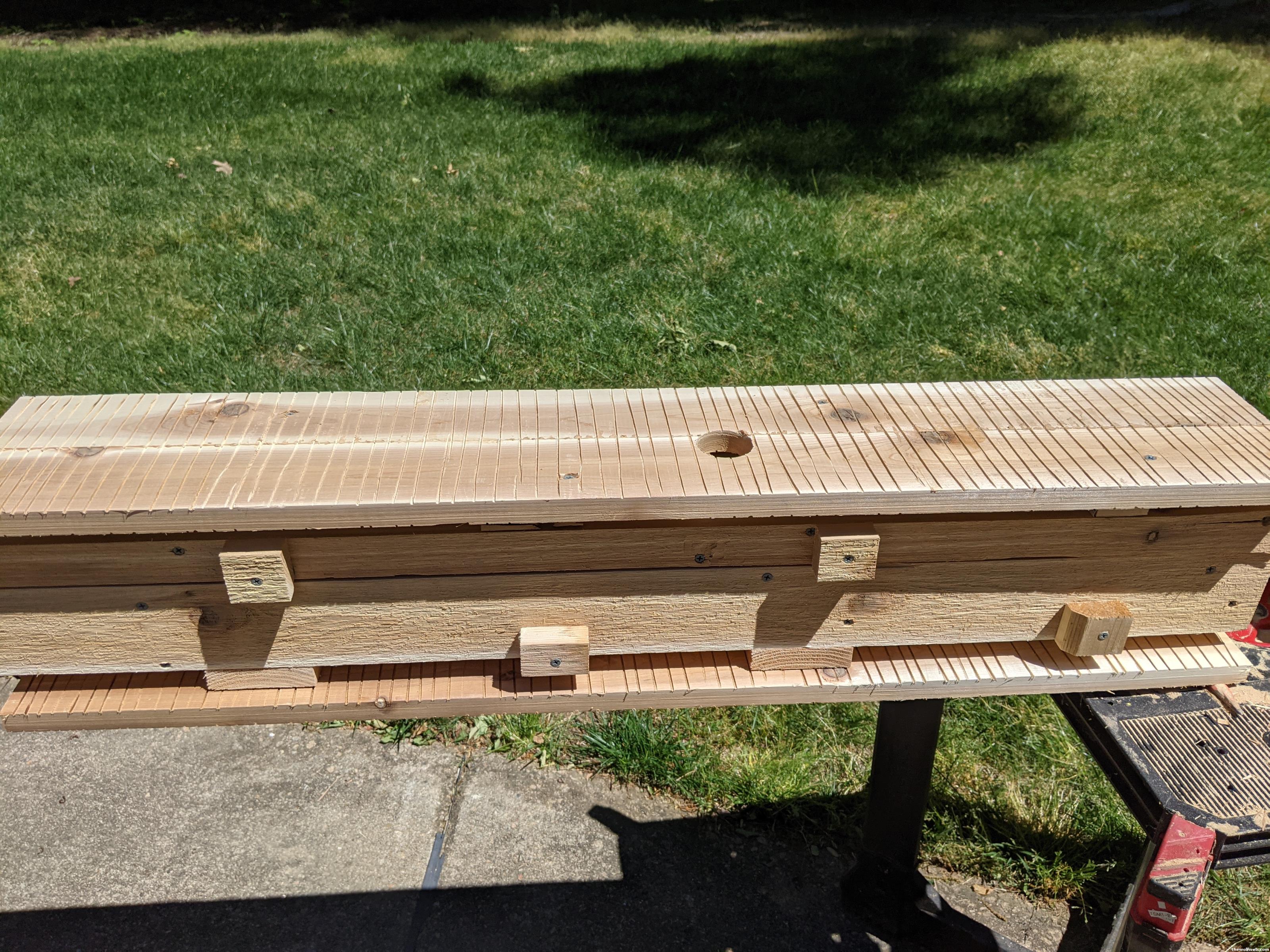

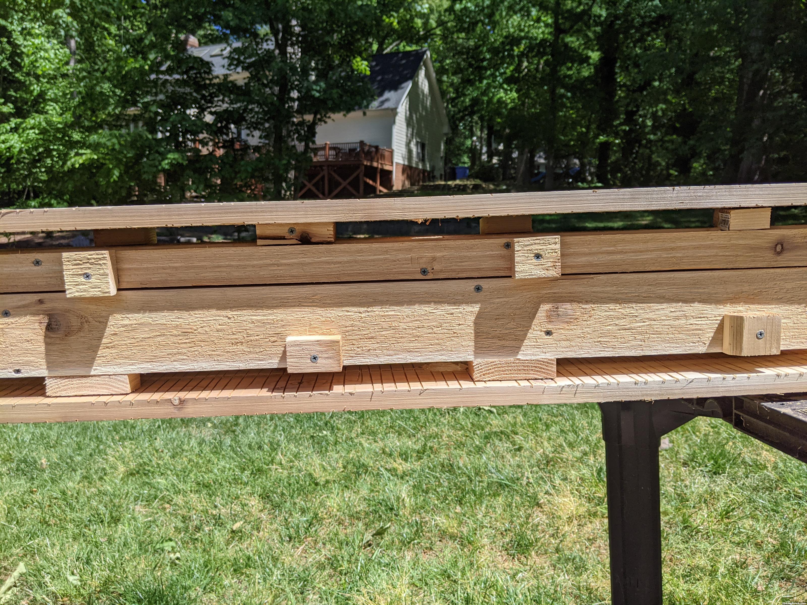

I roughly followed the design at http://www.batcon.org/files/RocketBoxPlans.pdf. I used cedar for the inside and my inner most box is 4"x6" since I wrapped the 4x4 (so a little bigger than the design specs). I think I built it in a morning, would have quicker if I had bought 1x6 and 1x8 cedar instead of gluing 1x4 boards together.

oh man, my b! I had taken a picture trying to look up the bathouse but you can't really see anything. Here is the pic from January. Definitely lots of bats back in residence, the poo mound grows every day. I haven't really seen them yet, but I haven't really been looking either. I put out 6 mosquito dunk buckets today. We have been watching the hurricanes games outside, and I notice a mosquito every now and then and want to see if the dump buckets make a difference.
