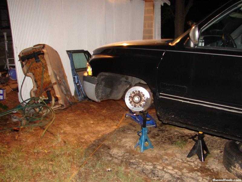

OK, due to Hurley's piece of junk honda, work on the 'LUNG was delayed a little. Finally made a little progress yesterday on the front end.
High tech bushing press
Poly Bushings
Squeak
Proposed ride height, what you think??
OK, so maybe not, but it is getting dropped 3 inches. Hopefully we cna get the front end put back together tonight. We said fuck it after we pulled the lower control arms late last night only to be confronted with tack welded in ball joints......

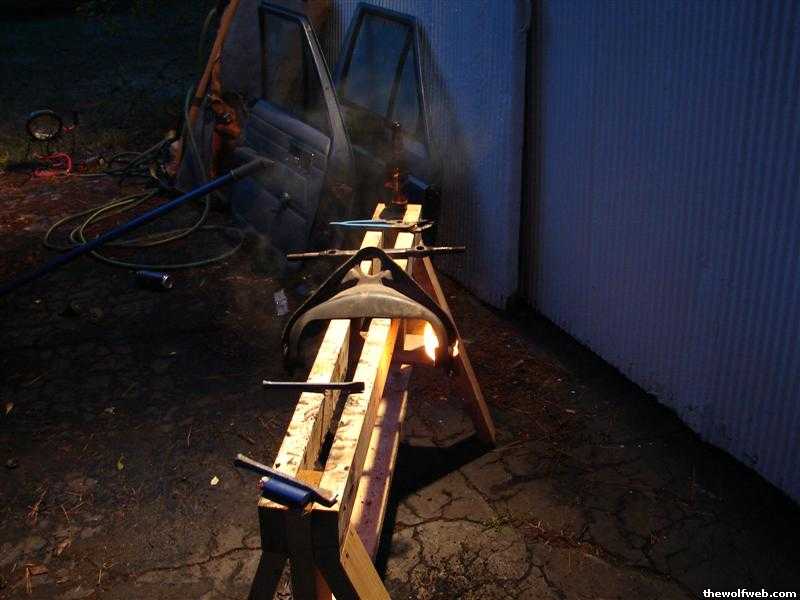

start of the frame, this will be the upper of the two hoops
7/14/2008 10:34:26 PM
Hurley
7284 Posts
bear in mind that the hoop will be ~20" shorter, and its not in position.
[Edited on July 14, 2008 at 11:04 PM. Reason : damnit]

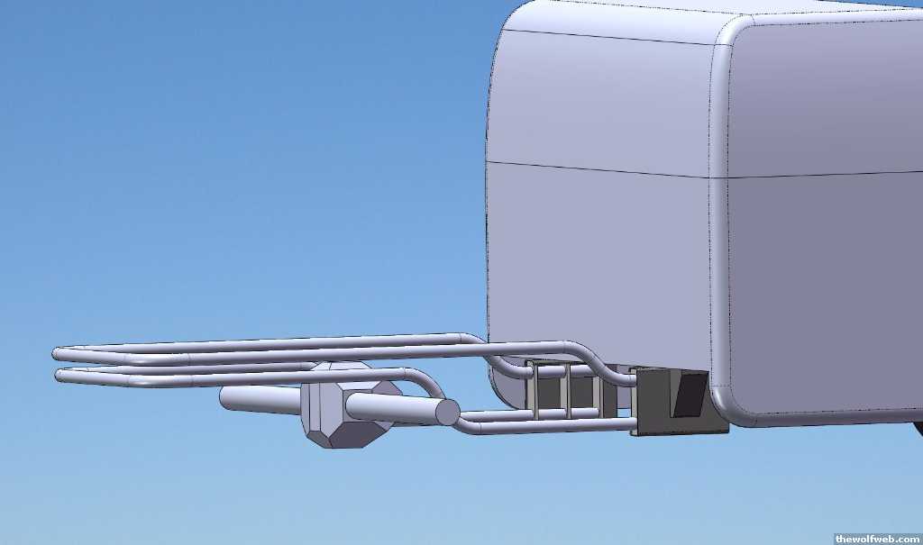

"so what are the final specs for all the fabricated stuff as far as dimensions and materials? or are you just doing trial and error as you go? have you modeled the suspension into a calculator or anything?"
I've a solidworks model that has been the basis of our hashing out, its more of a cartoon than anything, but I can depict proposed designs fairly easily with relation to some semi-critical dimensions. With our specific situation, some trial and error was inevitable due to our limited supply of tools/etc., and having only done a cage and bumpers with the bender before this project - learning to use this bender is pretty fun. We are also going to attempt a NHRA spec Rollbar to tie to the rear half for strength. 4-points in the cab, and 2 (maybe 4) points in the bed.
as far as the tube, its 1.75x.120 DOM, plain-jane.
I've not shown anything more, simply because this design is fairly dynamic, and there will always be differences between what I model and what gets bent.
... when it was all said and done last night, adam said "lets just fuckin' do it" - we did it with the old eyeballs and tape measure (and a great more skill on his end).
As for the suspension, I had played around with the 4-link calculator some early on, but I need to get serious and hack through some numbers very soon to keep our work steady.

Yeah, messing around with a whole stick of tube in the bender, we could have benefited from another set of hands for sure. The way the bends worked out, we had to have the hoop hanging below the bender to go the right direction. The tube was dragging the ground, for a while i thought we might have to cut the hoop or raise the bender stand to make it work. Ended up forcing it, and it worked out.
Hopefully should really start looking like something tonight. Hope to get the bottom hoop bent, and get the 6 plates ready to go into the frame(you can spy them in the SW model), they may be mocked up by late tonight.
7/15/2008 2:56:45 PM
adam8778
3096 Posts

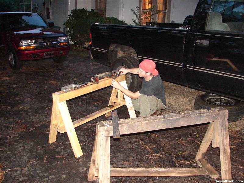

Daily update.
They arent totally parallel in the pic, they arent welded, just sitting there.
I also fucked up and made a bend 14" off, that basically ruined an entire stick of tube. GOD DAMNIT...
