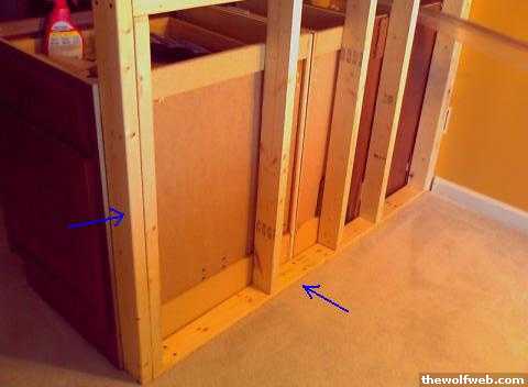

I need some help with finishing up my bar. I have the 2x4 frames in but I'm not sure the best way to sheetrock this.
1. How do you sheetrock two sides adjoining at the corner edge? I'm assuming I need one of those corner braces.
2. On the bottom edge where the frame meets the carpet, is it better to cut away carpet and sheetrock all the way down to floor and put a base trim on?
Your help is appreciated as I need to get this done by Sunday!

ctnz71
7207 Posts
1. you need an outside corner there.
2. just leave your carpet the way it is and buy a piece of base moulding that matches the existing.

2578 Posts
2. you mean it's ok to put sheetrock and basetrim on top of carpet?
3/18/2010 8:40:43 PM
ctnz71
7207 Posts
yes
