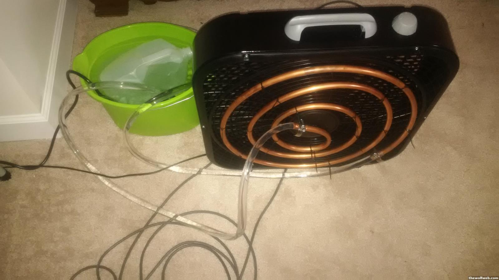

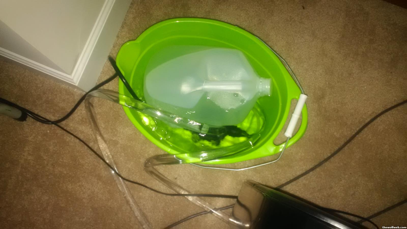

I work from home and my office is the only room in the house that gets hot, so I made a <40w solution
The freezer is keeping stuff frozen every night, so I figure the energy to refreeze the water is pretty minimal
4/9/2015 2:38:08 PM
35756 Posts
what did you use for a pump?
4/9/2015 10:48:13 PM
CalledToArms
22025 Posts
that's what I was going to ask ^
I was going to guess some sort of aquarium circulation pump but the tubing looked fairly large for thta.
4/10/2015 12:25:27 PM
19016 Posts
it's an aquarium pump called a power head pump. it was the smallest they had but still does 160GPH. it uses 12V at 0.5 and is silent. the hose is big so the copper would fit inside without any termination

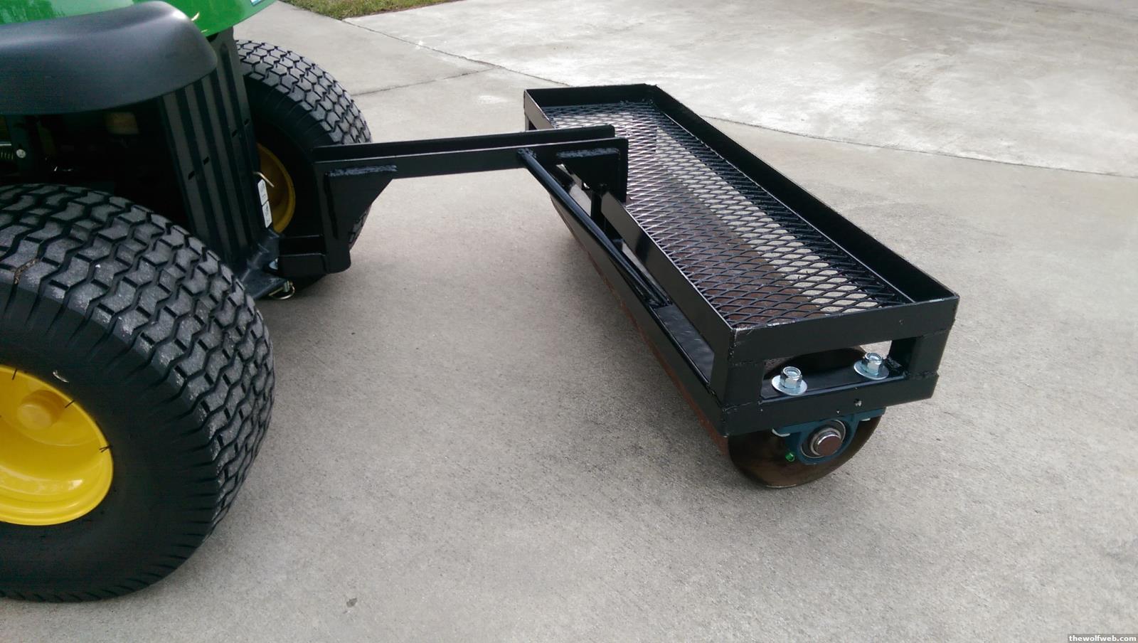

i built this roller for the RC track about a year ago. i don't think i ever posted it. the drum itself used to be an industrial conveyor belt idler. it is full of sand. the rack on top allows you to add weight with cinder blocks or sand bags or whatever.
12/20/2016 5:50:13 PM
^nice; you want to build me one?
12/21/2016 7:52:30 AM
35756 Posts
i will if you find the drum
it would have to cost several times what a cheap landscape roller would, though. a regular roller wouldn't really work for us because we have to pull it over jumps, so the tongue has to be goosenecked up to keep it from scraping the tops of the jumps. also, it has a knifeblade sort of scraper on the backside because the sticky clay will just pile up on the drum and make it jam up against the frame.
12/21/2016 5:48:42 PM

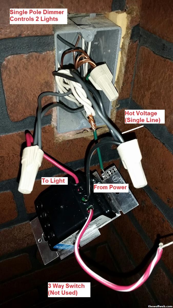

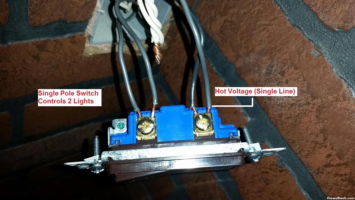

Thought I could easily DIY and convert this rocker switch into a dimmer switch, but having problems. Past dimmer conversions I've done have been straightforward. This one is giving me a challenge and I can't figure it out. Hoping TWW electricians can help!
I have a single pole switch that controls 2 lights, 4 black wires going into two screws. I tested and only one is the hot voltage line.
I want to replace with a Lutron dimmer DVCL-153P, but whatever combination I tried, it will not work.
I've tried the two black wires from lower screw to the black wire in dimmer, and other two black wires to red wire in dimmer - Nope!
I've tried the hot black wire to the black wire in dimmer, with other 3 black wires to red wire - Nope!
Either I am doing something wrong or my dimmer is busted.
Before:
After:
[Edited on January 5, 2017 at 2:13 PM. Reason : k]
1/5/2017 2:11:02 PM
35756 Posts
are the bulbs in the fixtures capable of being dimmed? some CFLs and LEDs are not dimmable.
1/5/2017 7:25:42 PM
krazedgirl
2578 Posts
Yes, bulbs are dimmable. My issue is the dimmer switch does nothing, light does not turn on nor off. I'm guessing I didn't connect the wires correctly.
1/5/2017 7:38:44 PM
35756 Posts
try it with only one of the circuits connected on the load side
sometimes you can successfully troubleshoot systems you don't know anything about by just removing parts of the sytem and seeing if the problem goes away.
but it looks like it's wired up fine to me.
[Edited on January 5, 2017 at 8:18 PM. Reason : afsd]
[Edited on January 5, 2017 at 8:19 PM. Reason : i'm sure you checked the breaker]
i realized that statement sounds condescending and makes it sound like i don't think you know anything about what you're doing. that was not my intention. i'm the one who doesn't know anything about it.
