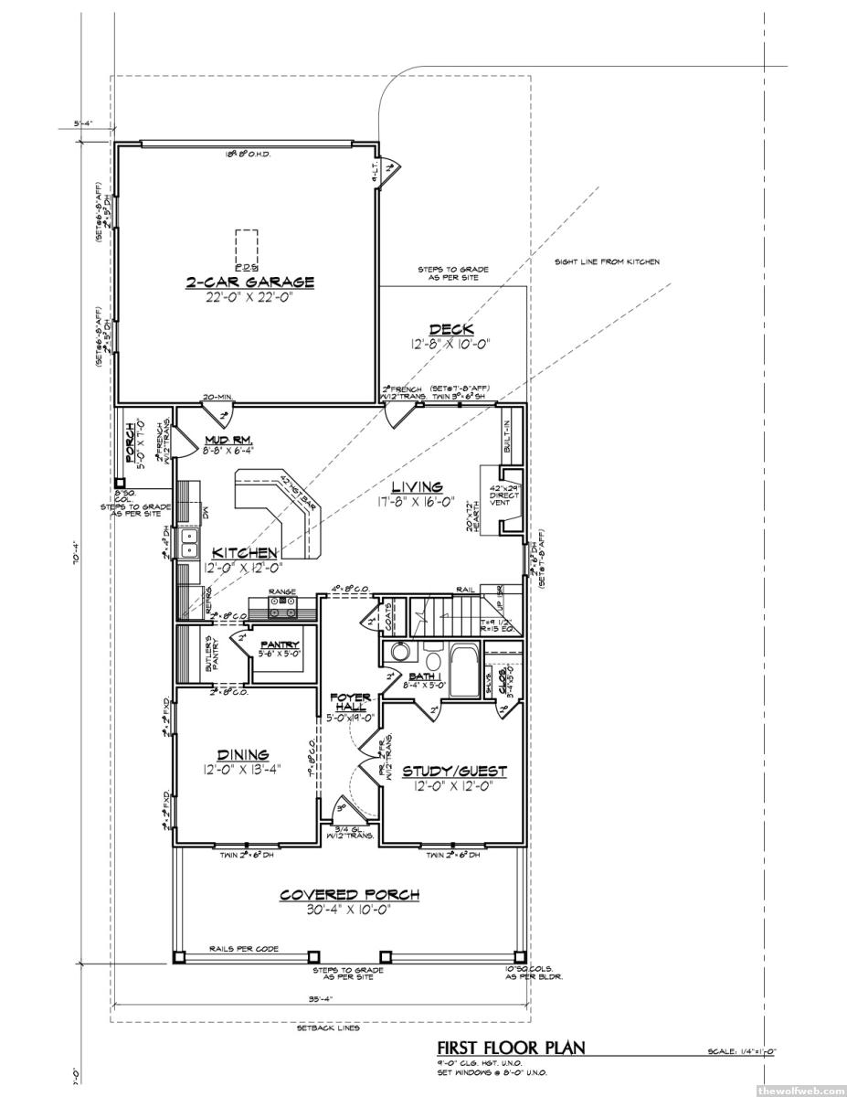

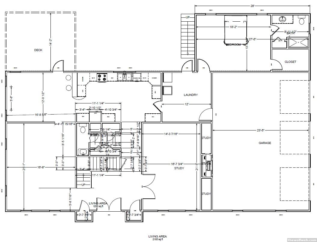

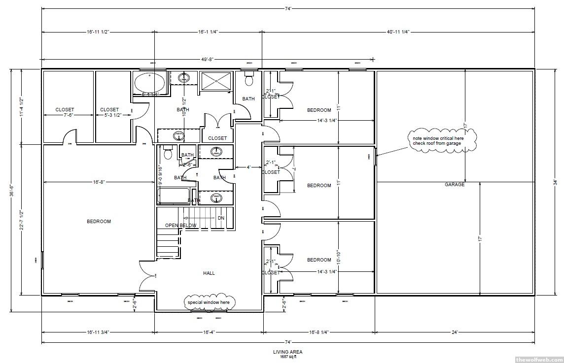

Ok, so we've finished the design...any and all positive/constructive comments welcome. we will have a basement (still working that), and there is a MIL suite/guest room on first floor.
first floor:
second floor:
The style we are after:
9/28/2011 7:47:14 PM

My Opinions
1. Take about 3'-4' out of the width of the laundry. that space will be more useful in the kitchen.
2. I would do the same thing with the study but both directions.
3. I think there is too much going on in the Powder room. with the footage taken out of the study and a simple powder room you could make the kitchen more of a square rather than rectangle and increase the dining and living.
4. I would increase the short width of the dining room by a foot or 2. A nice formal dining table with any buffet/misc furniture on the wall could get cramped.
Second Floor
1. I would figure an access door in to the garage roof from a bedroom for storage. even if you decrease the pitch of the roof to accommodate a window it is still useful space. With the hip roof on the main house your attic space is less than that of a gable roof. You can never have too much storage.
2. I am assuming that you have his/her closets and yours is in the bathroom? If so, yours is too big... Just kidding. a pocket door on the one in the bathroom might be useful or a small set of double doors. You might could remove the wall and have one big closet and put an island in it.
http://blog.customclosetsdirect.com/custom-closets/add-more-closet-storage-with-an-island/
3. i would increase the width of 2 of 3 bedrooms and leave one smaller. 11' is not a lot. You will need that window in the middle bedroom and i think it will need to be big enough to climb through in case of a fire.

Looks like you have a nice floorplan. One of my hobbies is to look through floorplans and find all the things I would do differently. I can't find too much with yours. The only things I could think of are a couple of issues concerning space.
- I'm all for having a nice size laundry room, but holy crap thats huge. Do you have anything special you're planning on doing with all that room? I realize it's the connection to the inlaw suite but it just seems like it would be a waste of some sq footage
- The other thing is concerning the closets in the 2-4 bedrooms upstairs. The bedrooms are very good size but the lack of a walk-in closet in at least one of them is a bit of a downer. In at least one of the bedrooms I would push out the wall in the closet into the bedroom even with where the closet doors come out to currently (when shown on the plan in the open position). Then put the door for the closet next to the door for the bedroom. While it may make the room smaller, you don't loose much, if any, usable space since that space along the closet isn't really usable now with the doors as they are currently. Does that make sense? But I wouldn't do it in the middle bedroom since it currently only has one bedroom and the lack of natural light can make the room look even smaller.

panthersny
9550 Posts
@ ctnz71:
a) we actually took 2 feet out of the kitchen. Currently Kitchen is 11' x 20'. The Laundry room is also going to be the mud room with cubbies for shoes/jackets, and a sitting bench.
a) the sides of the fireplace will be built in's with a desk on each side for the kids to do homework at. Also plan on this being a kid's play area. Are you saying make this room from 16'8" x 21' down to 12'8" x 17'?
a) I don'ts understand. The powder room is simple (sink/toilet). The ahll has a food pantry, HVAC return, and a small closet for additional food stowage. The measurements do make the area seem busy. This is the one area I am still looking at...any additional thoughts?
a) have thought of that, but as we don't expect to do a 'formal' dining room we don't expect that to be a big issue. we may regret that later so save your 'told you so' for future redemption.
Second Floor
a) we are def doing that from the upstairs hall...but good idea for the garage (they are only about $200. We are doing a 2100 sq ft basement with half as storage.
a) we went with the his/hers, with mine opening into the bathroom since I am up @330 for work. I like the idea of a pocket door.
a) we wanted to keep the bedroom sizes the same so the kids can't argue about the others room being bigger. we are working the challenge of that window...not an easy one.

@wolfpack:
a) see post above about using it as a mudroom. plus we HATE our small laundry room. We are considering putting a fold down from wall table for folding too.
a) interesting point, will bring it up with the wife!

ctnz71
7207 Posts
Still think you can cut some space out of the laundry. Even with cubbies. That's a really big room.

DaBird
7551 Posts
"Still think you can cut some space out of the laundry. Even with cubbies. That's a really big room."
100% agree.

As an architect myself, I find this thread extremely useful & hilarious at the same time.
I mean WTF, who walks through a laundry room to enter a bedroom??? Who DOES that? Also back-to-back sinks is not a very good idea if you plan on having mirrors on both walls you'll get the never-ending tunnel look. Otherwise I guess, not bad, but agree with some of the other comments about the kitchen.
