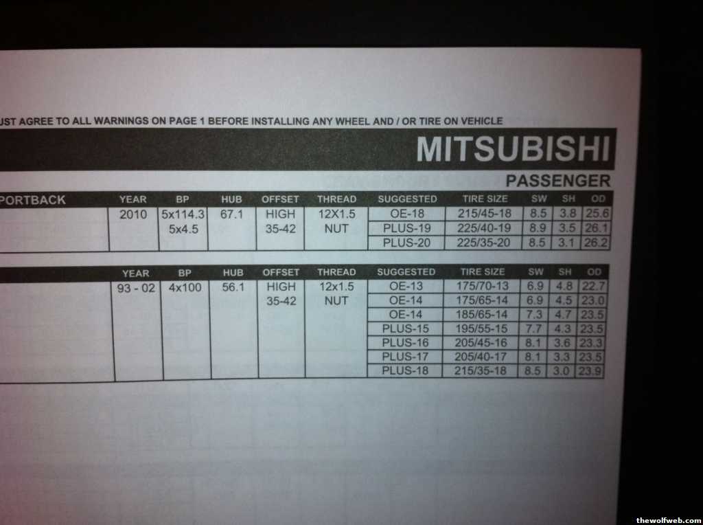

A pic of my tire specs from a Goodrich manual in Sears.
It talks about Plus-sizing. Anyone have any idea how to minus-size? I've looked online, but I really value your opinion.
1/4/2011 1:40:12 PM
43473 Posts
go to http://www.tirerack.com and mess around with the tire size tool. They usually list outside diameter (OD) for all the tires. So figure it out from that. Off the top of my head I'd start with a 205/55/16 and go from there.

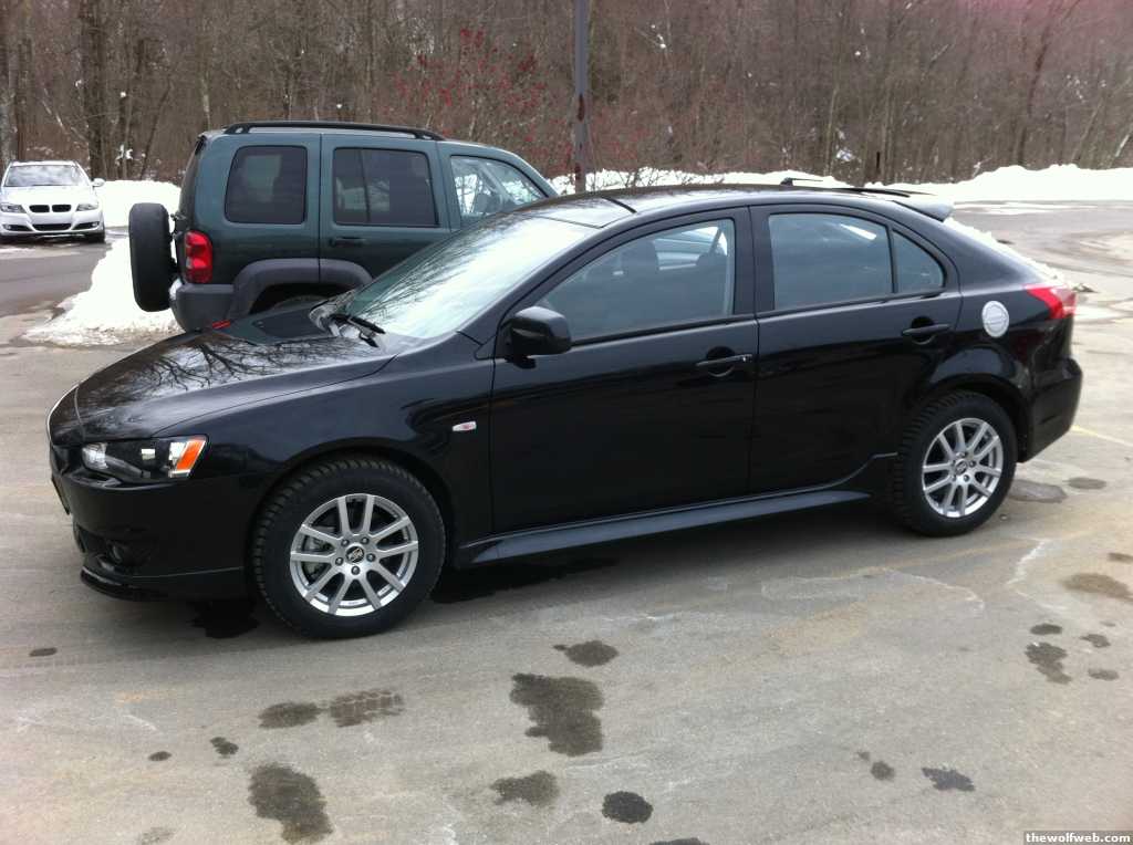

Tires are here. Will post pics when installed. Much lighter than I thought.
1/7/2011 4:00:50 PM
kdogg(c)
3494 Posts
Snow Tires:
Compared with All-Seasons from above.
I had to go to Midas and have them swap one of the wheels, because they had the wrong direction of rotation.
