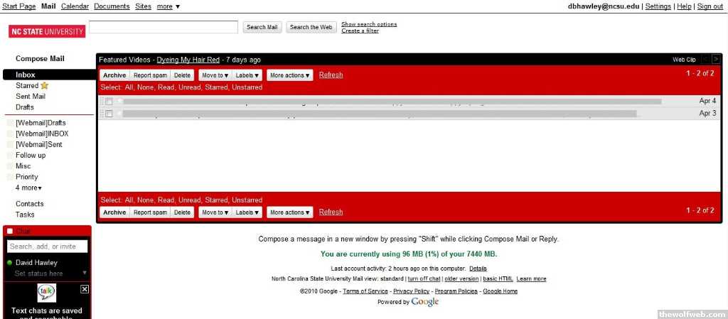

dbhawley
3340 Posts
mine:
never learned how to post big pictures...
