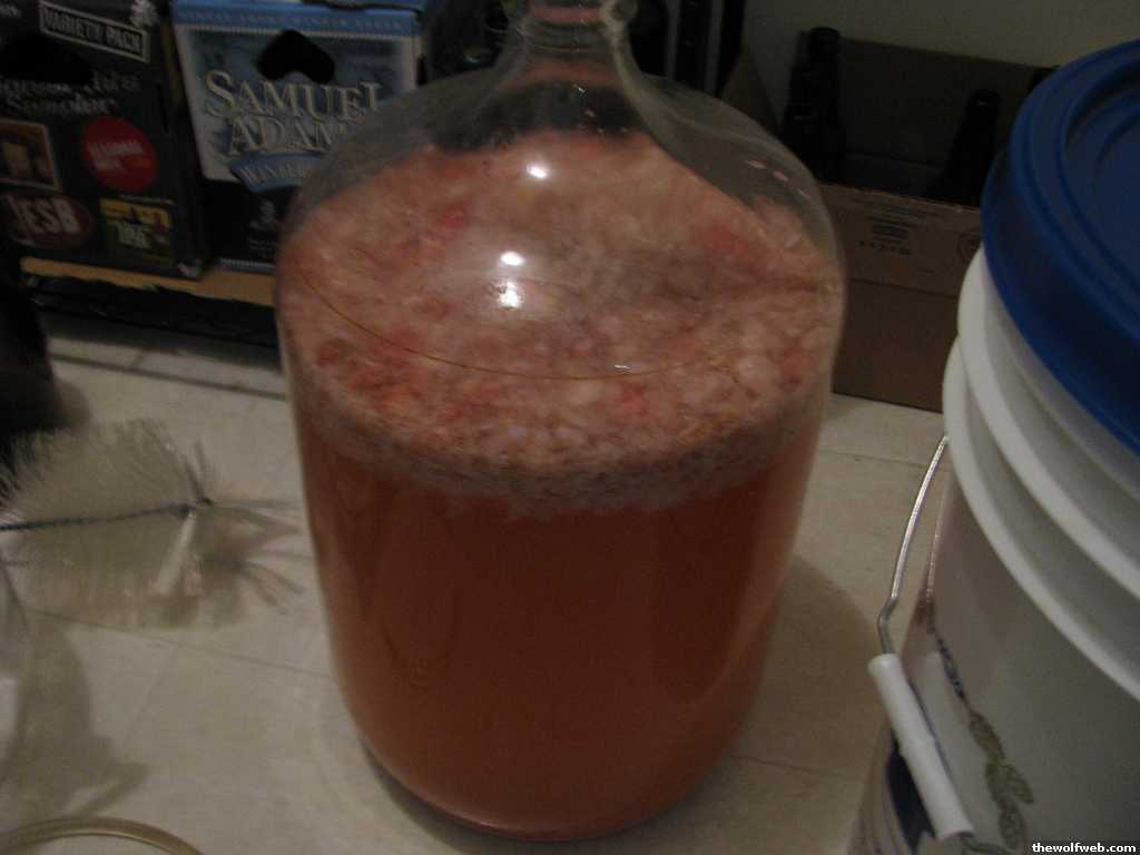

I also put a strawberry cider into primary the day before yesterday:
6lbs fresh cut strawberries
Some yeast nutrient
1lb of Corn Sugar
In secondary I will be adding a pound of Honey and 1 15 oz can of Black Berry Puree.
I used White Wine yeast.
Pics:
[Edited on April 5, 2009 at 12:40 PM. Reason : s]
