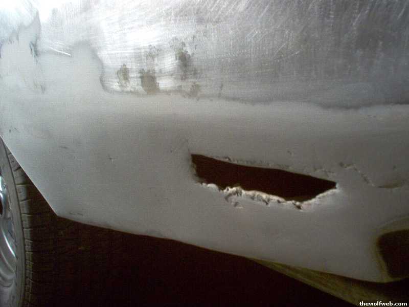

OK made some progress again today even out in the wind. I need some input though on a couple things, Ill get to that in a minute.
Doors are ready to go, all glass is masked off, trunk weather stripping is taped off and rear bumper is off car. Must buy 2 new bumper bracket to frame bolts.
This is the quarter panel as if about 8pm. I just slapped some more bondo on there to fill in those pits and to even out the sidemarker hole. Overall it is looking pretty good. I still have to finish the other quarter and thats pretty much all the bondo I need to put on the car. I could go back and work on 3 or 4 more spots, and about 5 little dents and dings, but I dont have the patience or the time at this point. Finishing that sidemarker hole will be enough. Also I found some rust in one of the front fenders that is worse than I had thought. WARNING: POR 15 isnt worth a shit.

OK quarterpanel is finished. Here it is step by step, a pretty good repair, it is as solid and sturdy as the rest of the body and from 20 feet you probably wouldnt notice any difference. Good enough to last me until I can afford to weld on a whole new quarter.

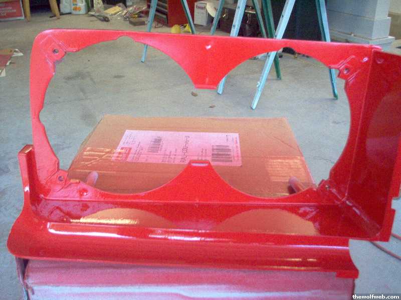

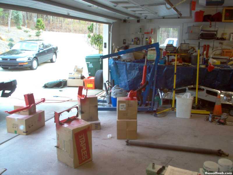

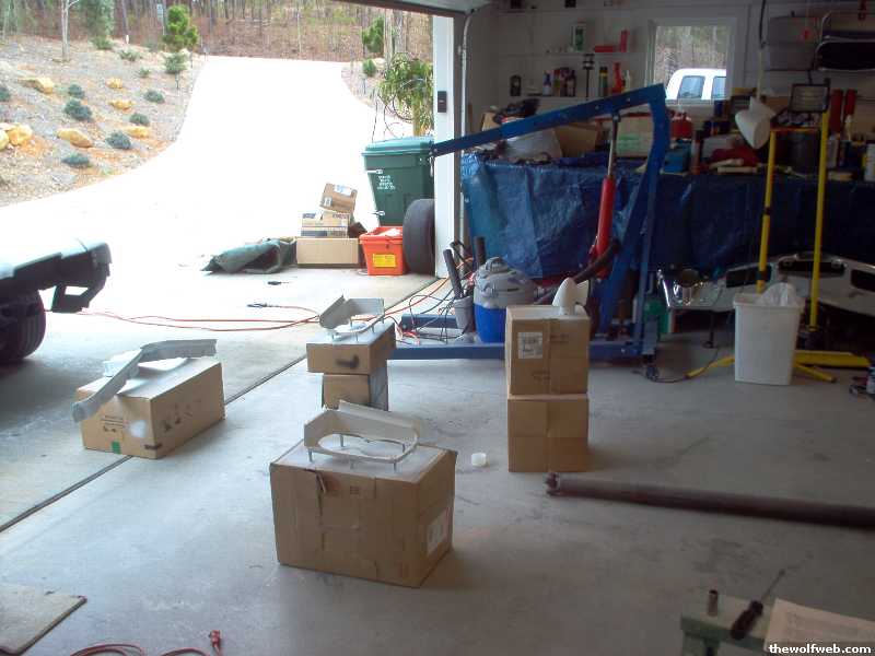

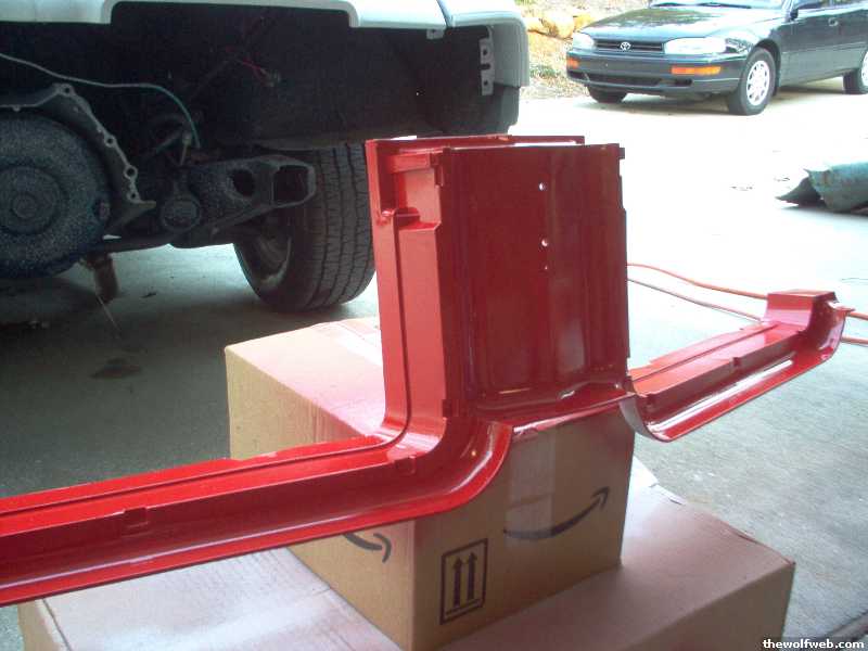

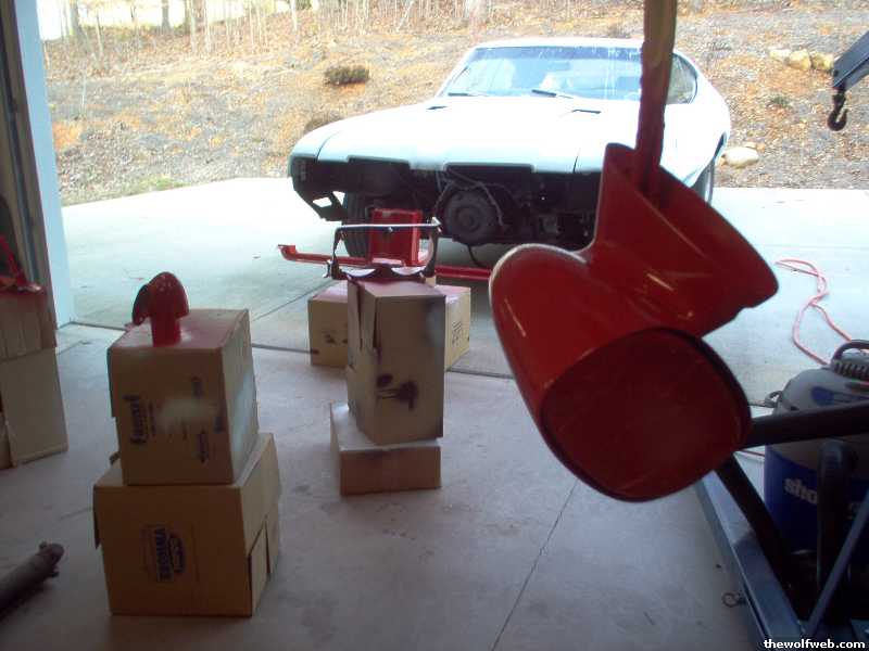

optmusprimer
30318 Posts
small parts primed (same primer as on the car, only from a spray can)
small parts get first coat of red (same paint I will use on car, only from a spray can)
close ups after second coat, dont look to bad (my camera kinda sucks)
