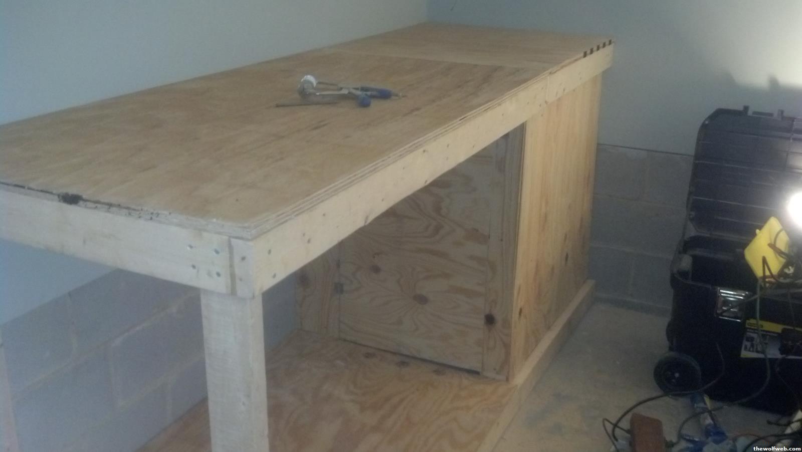

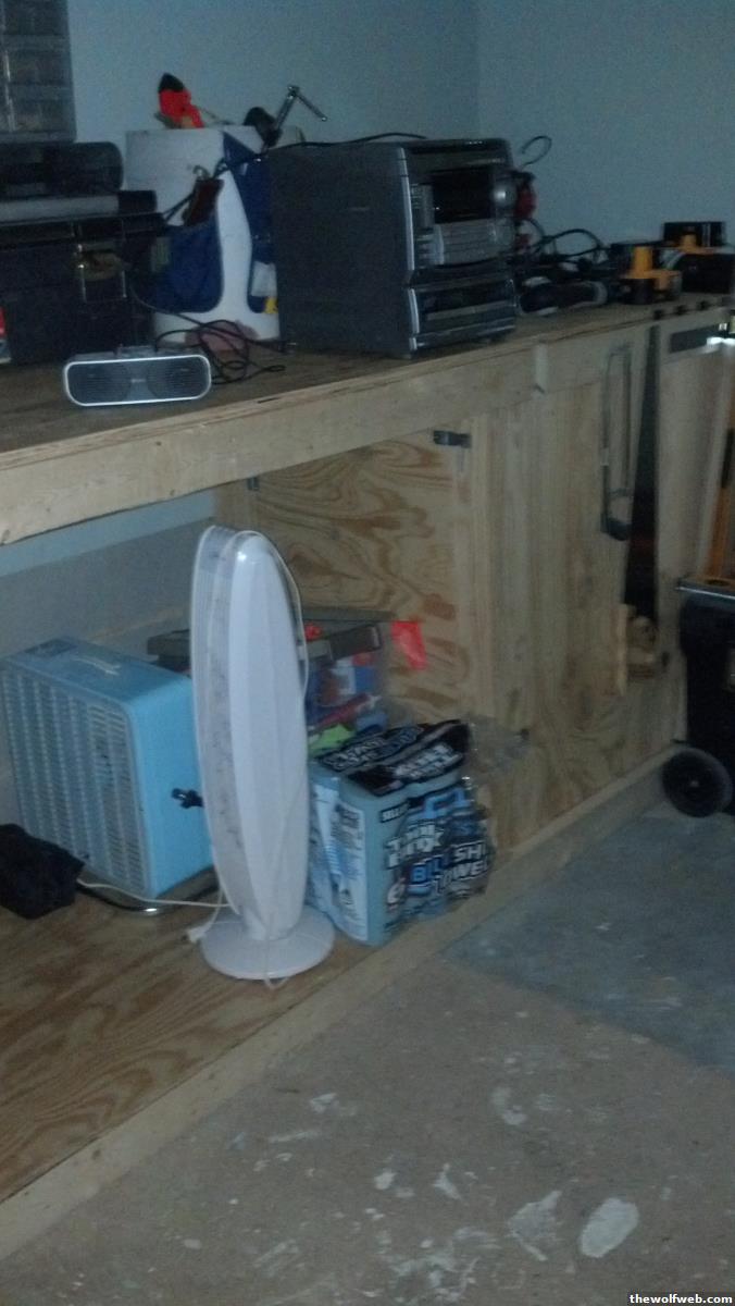

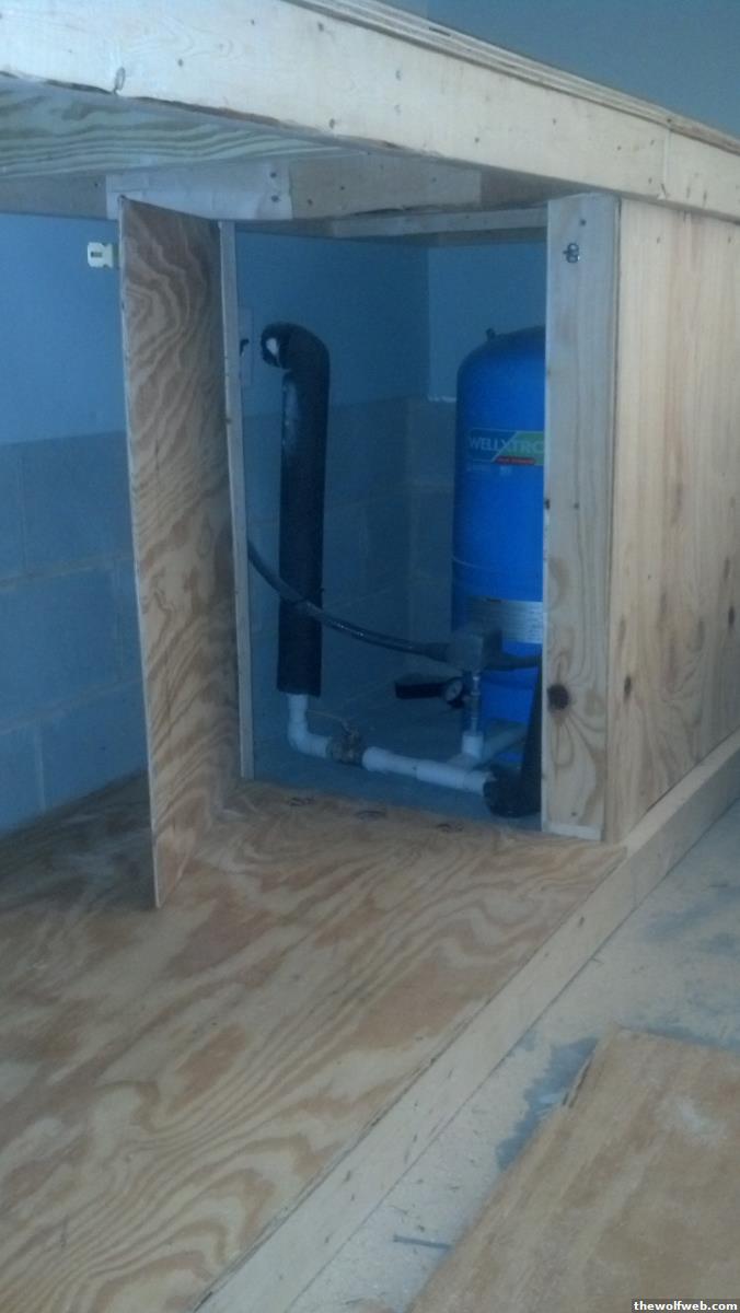

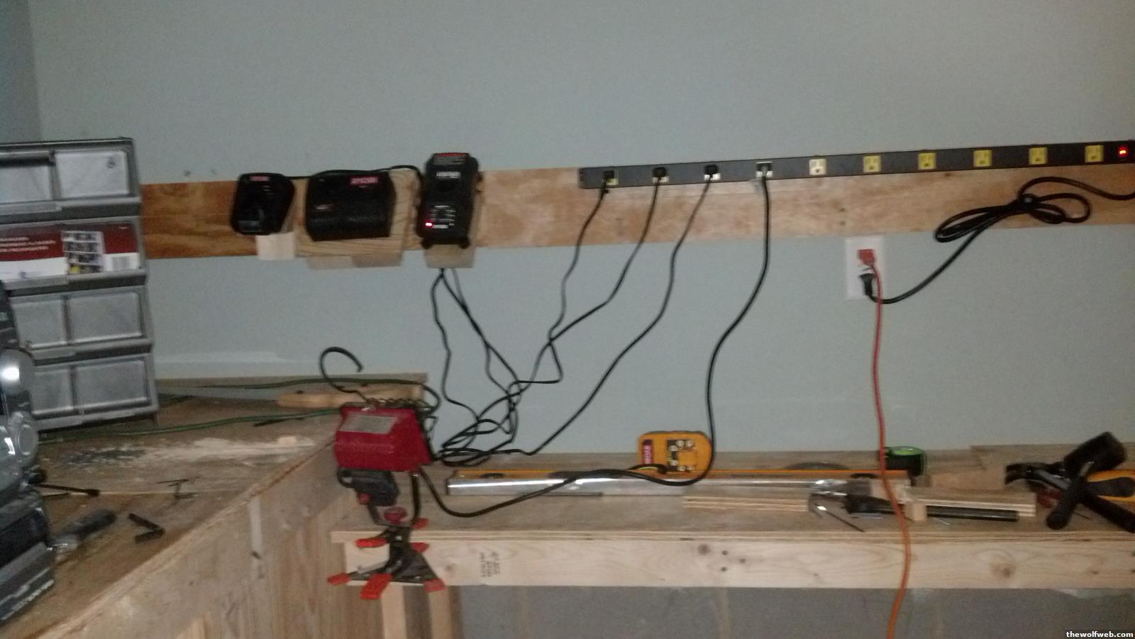

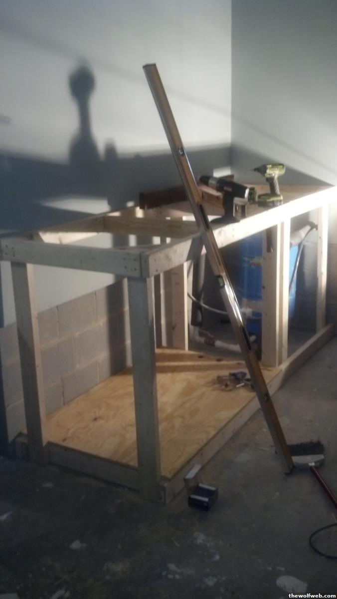

not nearly as impressive as most of you guys, but I've started on my garage workbench/storage project.
Phase 1 was a work bench with storage and to frame in my water tank to keep stuff out of the area/protect it. Shelving underneath it and on the walls to come. If you're wondering why it looks like 2 benches beside each other, the idea was to have completely independent benches in case the water tank has to be repaired/replaced - either portion can be easily removed, depending on the needs.
Not sure what I want to do along the wall that's at the right end of the bench. Need more bench area and storage, but that little wall for my water tank may come in handy for hanging things. What's there now is just temporary (I was bored and playing with my auto hammer that I never use)

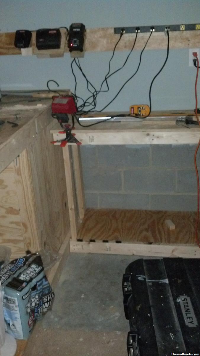

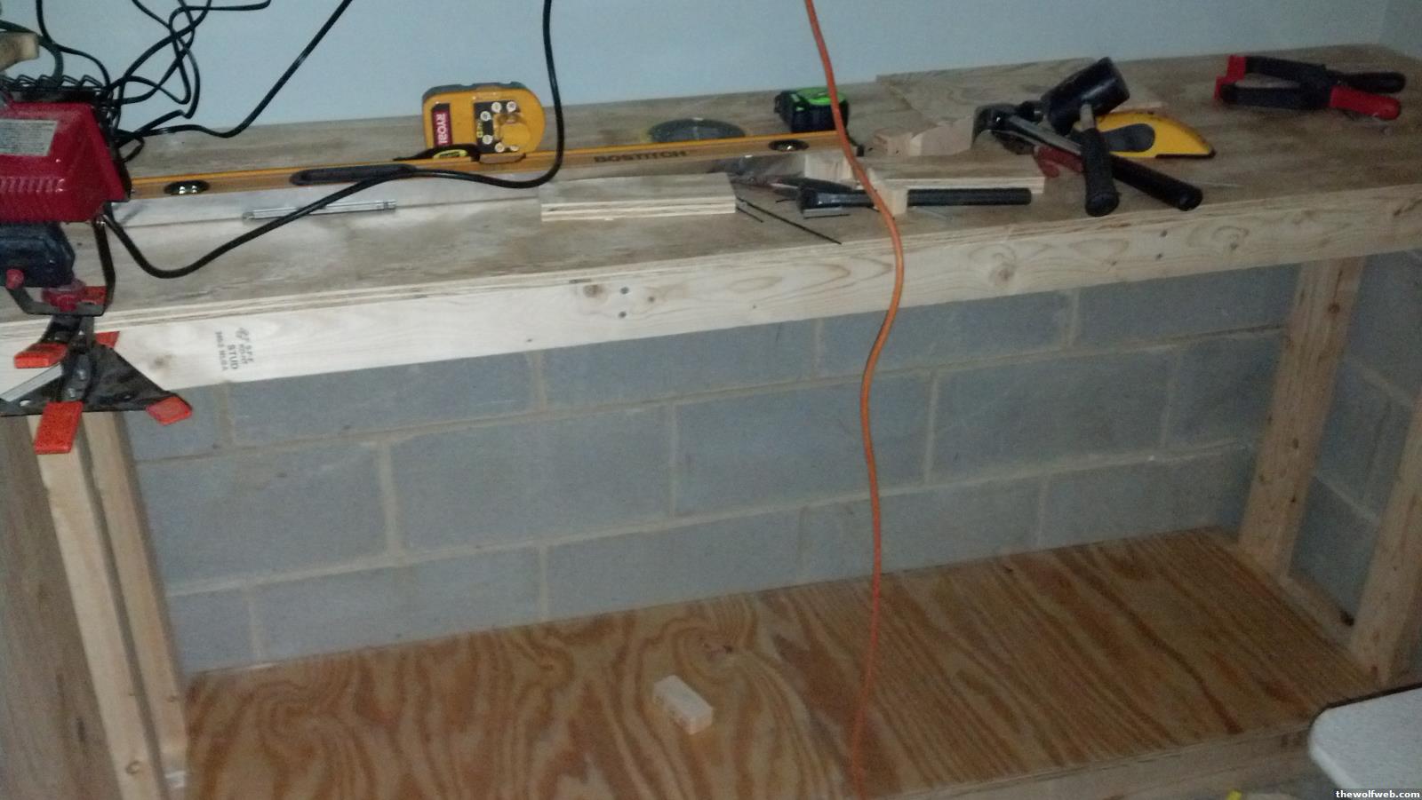

Guess I'm the only one left or my work is that bad
Phase 2 complete (lower/small workbench). Phase 3 beginning (french cleat). It doesn't seem as sturdy as I was thinking (the upper part seems a lot looser/wants to roll out easier than I had thought). I cut roughly 3" high cleats (from bottom edge to top of bias) at a 45; 2x3" screws in each stud. Guess I just need more verticals that cross the upper/lower assembly seam?

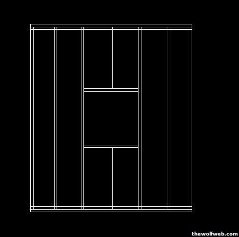

Design/structural questions:
I am looking at building a storage loft in my garage. It will be within a roughly 8x8, 3-sided nook.
Normal construction plans:
(2) girders on 2 side walls
(1) rim joist on the back wall
(front is open)
(6) internal joists + joist hangers for attaching to girders @16" OC from center of structure
(2) 2x4s turned on face for ledgers (attached to bottom of girders)
1/2" plywood sheeting
Since this will be about 8.5' overhead (bottom of structure), I don't plan on putting anything all heavy up here (so no large point loads, but the overall load could be quite a bit). So my questions:
- 2x6 or 2x8s all around?
- The front edge will be somewhat blocked by my garage door. I plan on leaving enough room to allow a ladder + person to get up on the loft from the front edge. But should I also include a scuttle in the middle for better access to the entire loft? I can imagine this thing being full of stuff, and if you can only access it from 1 side, then it's pain to get to stuff in the back. A scuttle in the middle would provide easier access to the entire area. This would obviously cut down on storage space, but I'm not all that concerned about it. My friend did something very similar and he is quite happy with a central access point.
- If I go with a scuttle, do I need to double up the joists or cross-members?
[Edited on December 5, 2013 at 9:47 AM. Reason : thanks]

MaximaDrvr
10412 Posts
I would double joist the scuttle myself. May not be entirely necessary depending on what you are putting in the surrounding area, but it would definitely be peace of mind.

^^^do you think you'd need a ledger if you were using hangers? maybe i'm just misreading what you're saying, especially the 2x4 turned on face part
and I think you'd be fine to not double joist at the scuttle. you'd only be spanning 8 feet. plus any load on either side of the scuttle would be sufficiently carried by the 'cut' joists on either side, which will presumably bear on hangers between the girder and header (and the header bearing on hangers to each joist). but the cost and difficulty of doubling the joists are both pretty low, so I say go for it. I think if you were cutting existing load bearing joists elsewhere (i.e. associated with a floor or roof trusses etc), I would without a doubt double them up.
and I would think 2x6 would do just fine. IMO the most important thing is finding where to anchor the girders

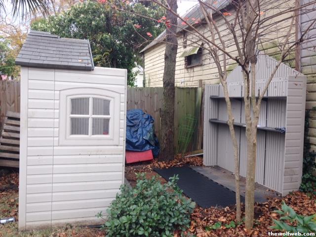

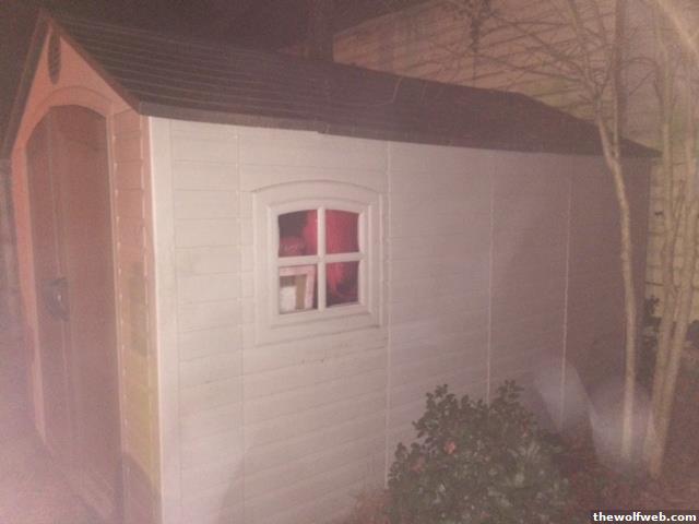

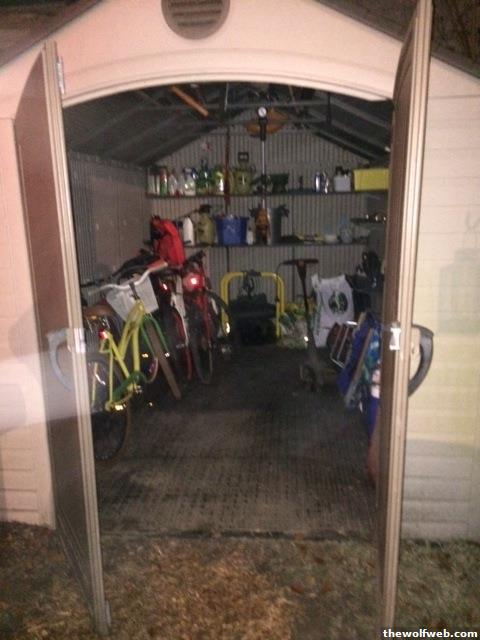

Nothing too impressive, but I added two 2.5' extensions to my 8' x 7' Lifetime shed...making it an 8' x 12' shed. Basically had to separate my shed in the middle, pull it apart, and then build in the extensions. Wife was impressed because it took two guys (a friend and I) to build the shed the first time...and it was difficult because we had no solid base and my buddy who was in charge of the directions kept fucking shit up. It took us all friggin day. The extension part was done by my lonesome and mostly in the pouring rain...and I somehow finished it in 4 hours...just in time to shower and go to a friend's dinner party.
Now we actually have an "aisle" in our shed and don't have tip toe around objects like its a mine field in order to get anything. My grown up Erector Set project :
(last two pictures were taken at night when it was foggy...apologies for shitty quality)

^^thanks. I kinda fubar'd my thinking/description there. I really meant 2x4 ledgers or joist hangers. I'm leaning towards hangars, as a personal preference.
I'll anchor the girders (and the rim joist) into the existing wall studs. (3)x3"/stud wood screws good enough or do I need to step up to lag screws (or 4" wood screws or so called structural screws)? The studs are behind drywall, but I've got a stud finder that's about 75% accurate it's always easy to tell when you miss a stud.
My gut feeling was to double the joists and cross-members for the scuttle. Probably overkill, but it seems that 3/3 of us so far say go for it.

yeah I'd go 3" minimum on the screws - you'll lose at least 2" on the 2x and drywall
and you wouldn''t hurt anything by sinking more than 3 screws on each side, just in case you don't get enough grab on one or two

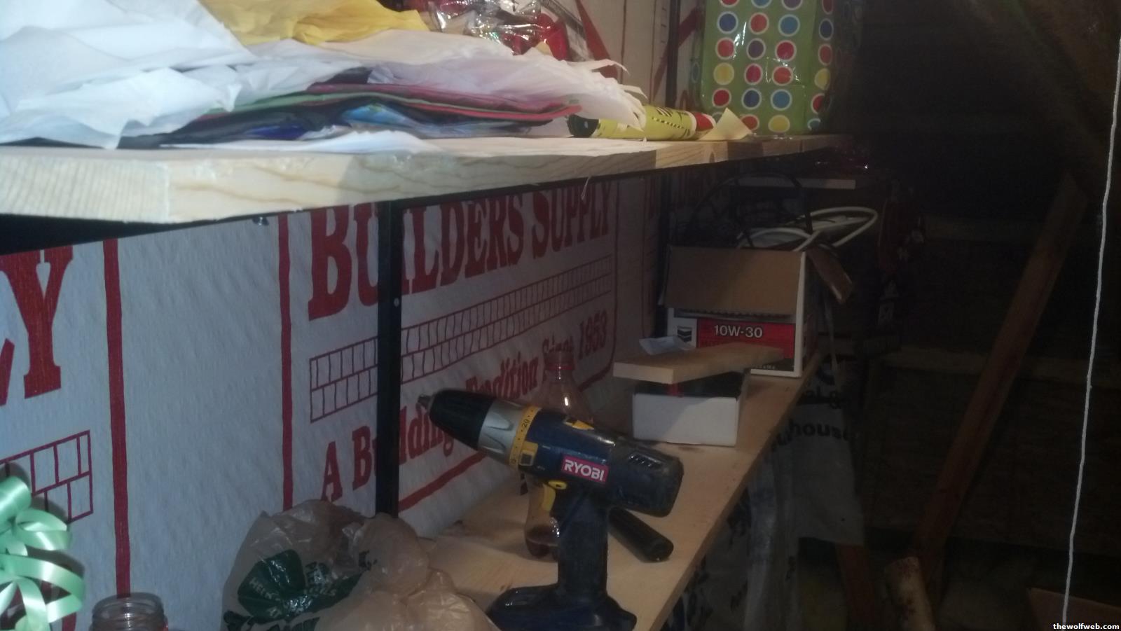

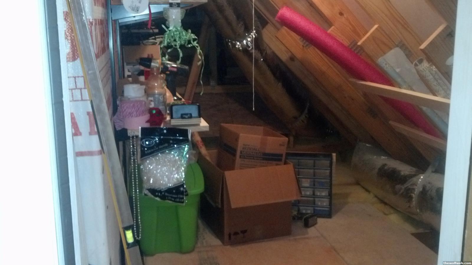

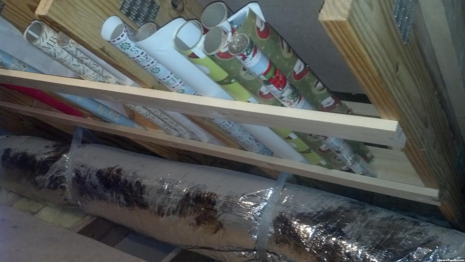

put some shelves in one of my attics. also used some wasted space between the roof rafters for wrapping paper storage.
Just used those prefab adjustable shelf units. A bit expensive, but quick and easy.

^^ I always use lag screws on my projects. Mostly because I like the bolt head and ease that creates. I always throw a washer on, and then tighten down with a socket wrench.

put together some stalls for composting and a rough screening system. chickenwire sucks.
