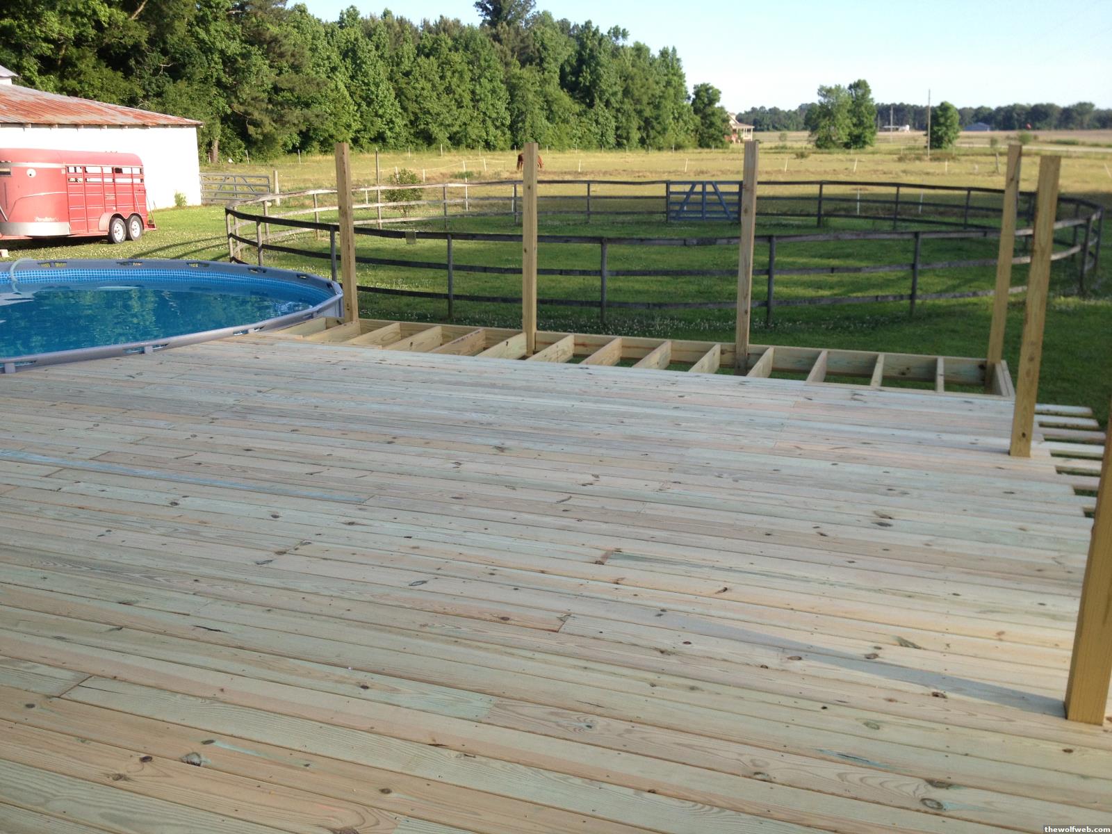

NutGrass
3695 Posts
As an update, here is where I am with my pool deck project:
5/29/2013 3:58:57 PM
^ NICE! I am jealous
Even though you have a post out of level, not sure if it's the one in the middle or the one closest to the pool.
[Edited on May 29, 2013 at 5:05 PM. Reason : a]
5/29/2013 5:03:46 PM
NutGrass
3695 Posts
It's the one in the middle. That post is straight at the bottom and warps near the middle. I probably shouldn't have used it, but I wasn't about to stop for one post. I should be able to hide it in the rail.
Nice job on your deck too, btw. I have a few things around here that need some rehab cleaning and probably treated.
5/29/2013 7:32:27 PM

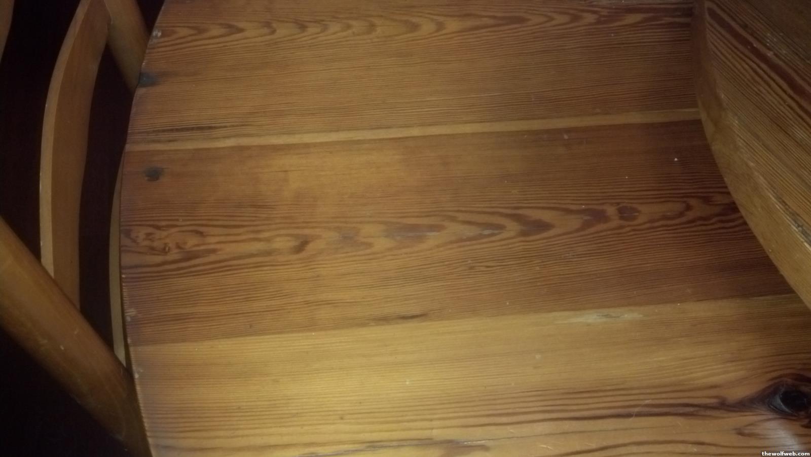

Any advice/resources/etc. for refinishing a table? I have a 5' diameter solid wood kitchen table with a lazy susan. The finish color is dated (IMO) and damaged. I've never done any type of finishing. Not sure on the wood species either. I need to get some pictures and compare/ask.
7/8/2013 1:40:40 PM
I haven't done one myself, but search the /r/diy subreddit. There's a bunch of examples with people having pictures of each step.
7/8/2013 4:53:45 PM
^thanks.
This is Oak, right?
7/11/2013 9:12:37 AM
