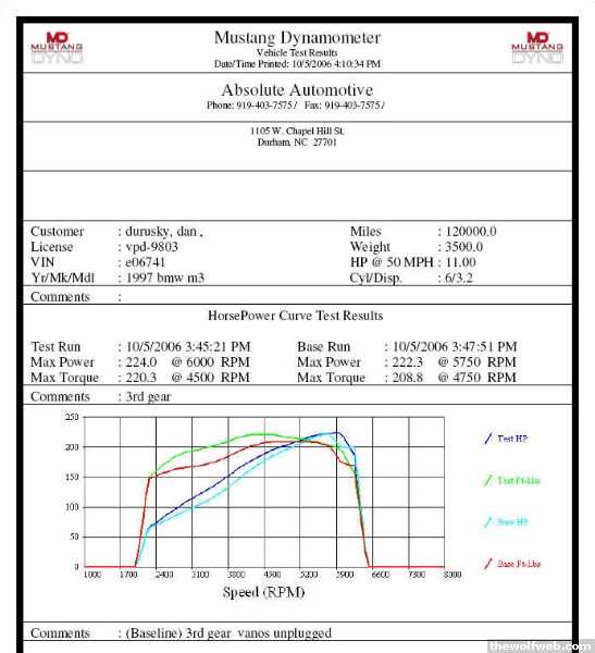

Here's what VANOS does:
10/9/2006 11:45:09 AM
Scottyc
1956 Posts
if that is what vanos does, why is the graph different when the vanos is not engaged?
10/9/2006 12:10:08 PM
