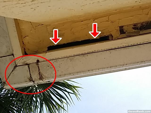

Re-hash from last page:
NW corner to front bedroom soffit missing small strip of soffit board recommend repair to prevent pest intrusion.

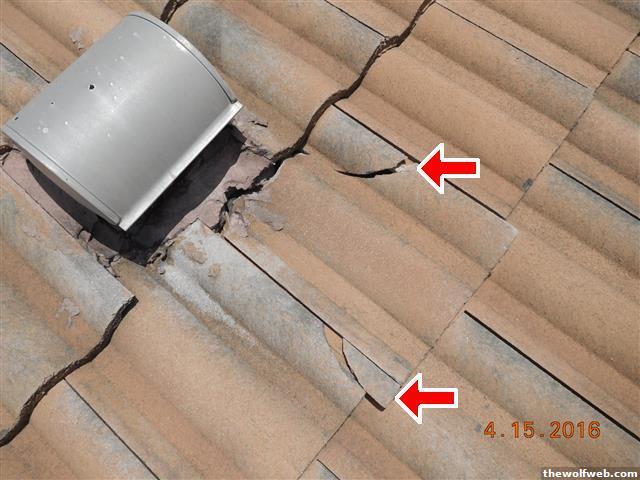

See attached roof report that was performed by South Florida construction which states the following, roof is from leaks at time of inspection. There are three cracked tiles in the field.

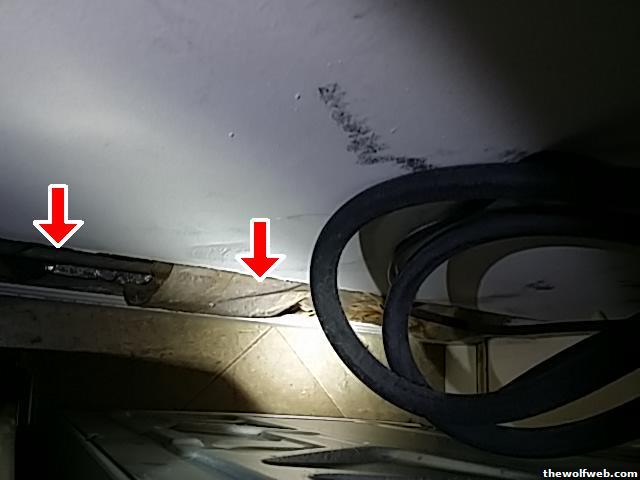

There is a small wall opening behind the washer and dryer that appears to be created to make some kind of plumbing repairs. There is no visible signs of leaks, recommend repairs to the area to prevent energy loss to the open wall cavity.

^^^ seems like fixing the roof should be an obvious thing for the seller to pay for
None of those issues seem too big to me, less than 1k to fix everything probably.
Can you see what is under the washer/dryer? Any water damage there? Does the wall still seem firm surrounding the opening (is it water damaged)?

unfortunately, I'm in KS and the house is in Miami. The tile in the house is relatively new, as is all of the furnishings (save the kitchen appliances). It's odd that the wall was never completed, but I don't know why.

Conversation with inspector just now:
Me:
"I don’t know if you had a chance to look at the inspection report. I have a question about section 8.1 (Walls). The photo shows a gap in the drywall on the floor of the laundry room behind the washer and dryer. Is there a reason why the wall wasn’t finished? Was there water damage done to the wall and the wall had to be replaced?"
Inspector:
"The picture would be a lot clearer if I could pull the washer or dryer out the wall was cut out about 18" high and 2 ft long to make repairs to the plumbing pipes or drain pipe I am not sure which one. A small piece of drywall and plaster should be all that’s needed for the repairs. As for water damage possible as something cause the wall to be cut out and plumbing pipes is the only thing in that wall."
