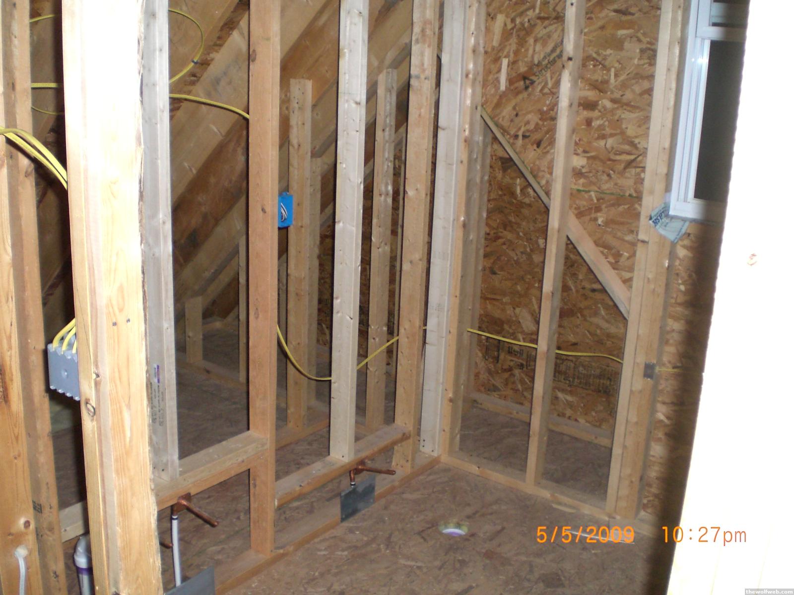

The plumbing was roughed in meaning that all of the pipes were already ran from under the house to upstairs. My boss at the time helped me install the toilet, sweat the water lines, and finish the drain pipes above and below the house. I got a quote from some contractor and I think it was $500.
Here are some pics of the bathroom beforehand.

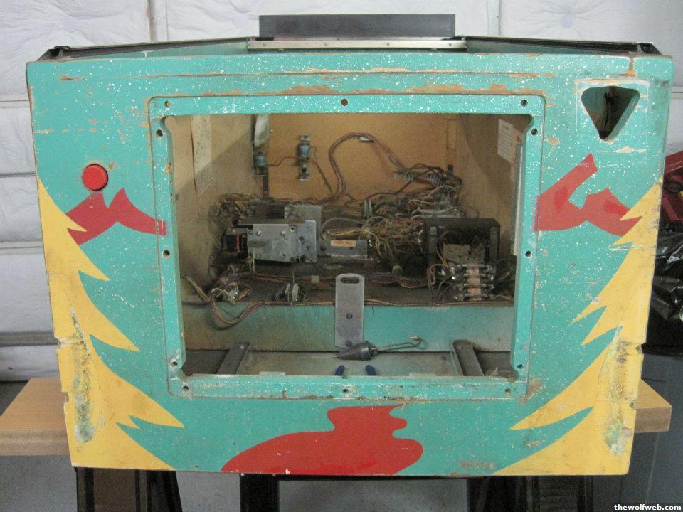

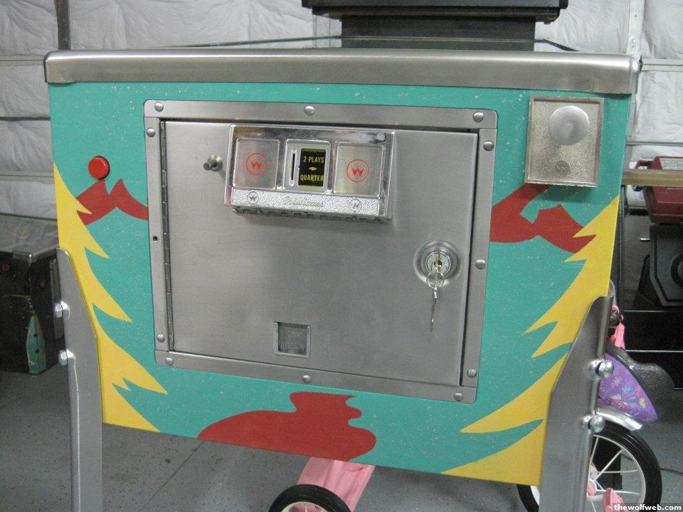

I restore and collect pinball machines as a hobby and this weekend finished restoring a 1971 Williams Yukon Special. I found it in someones barn, it hadn't been plugged in for over a decade the guy said. His brother had owned it and it got some water damage that they tried to repair in the late 90s and when they couldnt figure it out they gave up and shoved it in the barn.
It is an electromechanical machine, which means it has no transistors or solid state electronics in it. It is just a huge mass of relays and switches and wiring. It has a central score motor that has a stack of cog wheels on it, with a stack of switches on each cogwheel. This is pretty much the "program" it runs. Think of it like a music box. As the score reel rotates, the different cogs push different switches at different times.
At any rate, here is a pic of the front of the machine before I restored it, and after. The coin door and all the hardware is the original hardware that was on the machine, I had just already removed it before I took pictures. It was all rusted and beat up. This one had 3 different break-in's on the coin door. I had to pound all of it out.

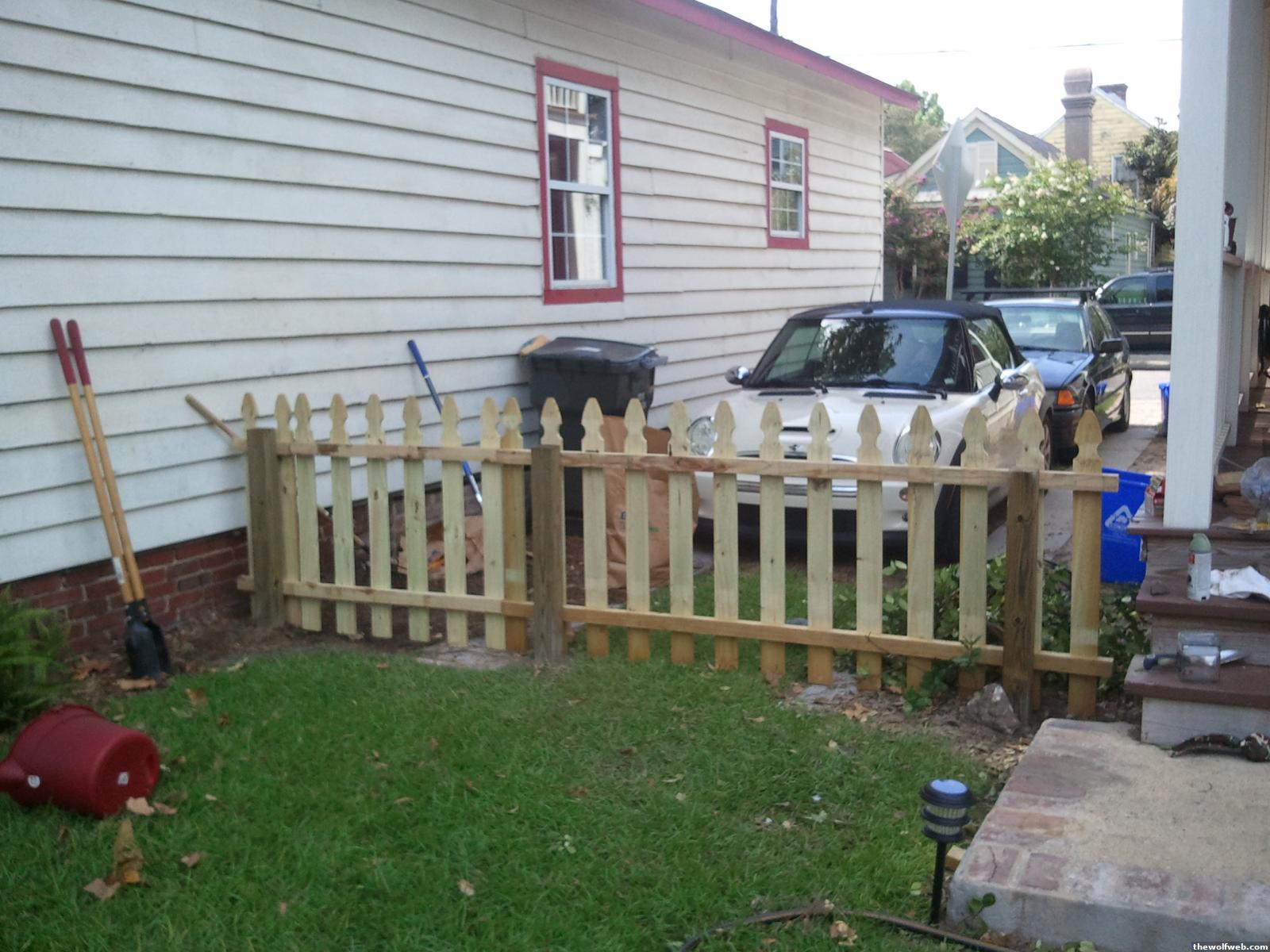

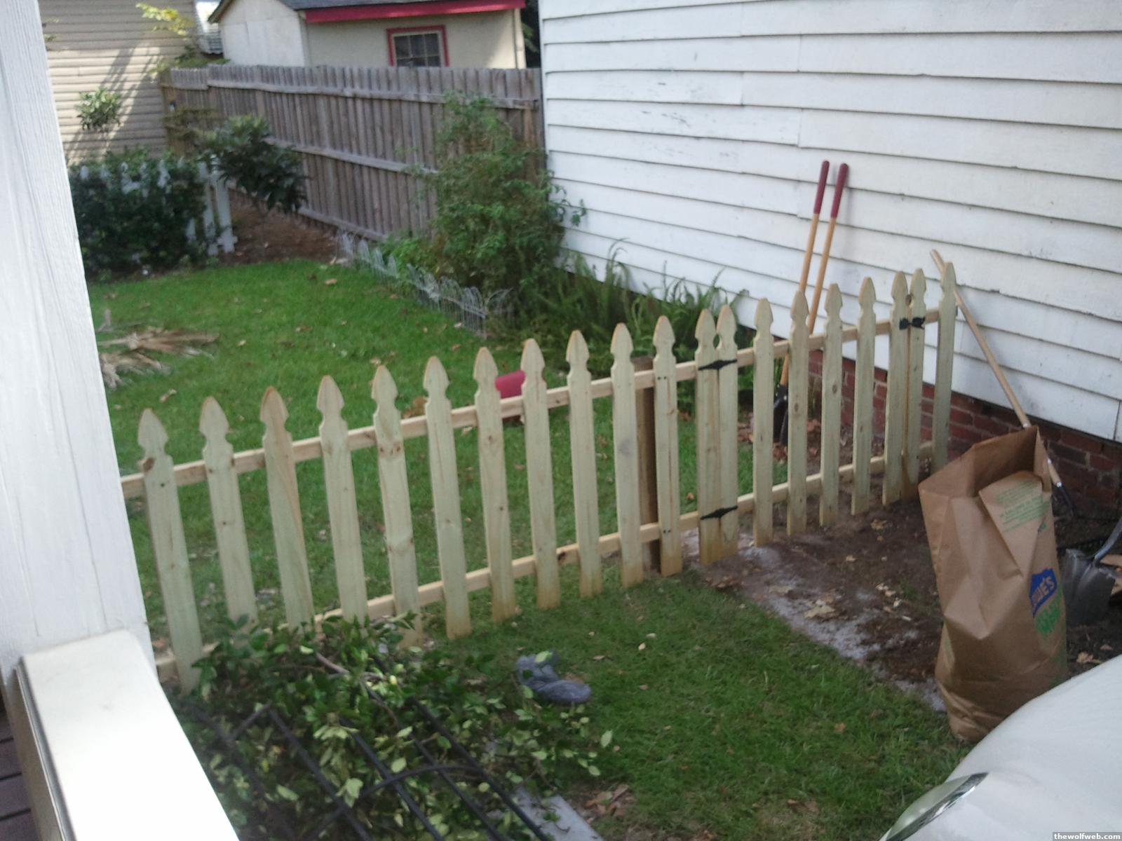

Built a small picket fence yesterday (13 feet long). Pales in comparison to a lot of stuff posted in here, but probably the biggest project I've done at my house so far. Had to do a decent amount of board cutting because Lowe's wouldn't cut shit. Had two 8-foot pieces that we had to size down and make a swinging gate/door out of. Had to dig three 2-ft holes for the posts and fill with quick-krete. Covered with primer after taking these pictures and will finish painting today.
We did this so that our yard is fully closed off now and we can let the dog roam without keeping an eye on him 100% of the time.
Very satisfying.

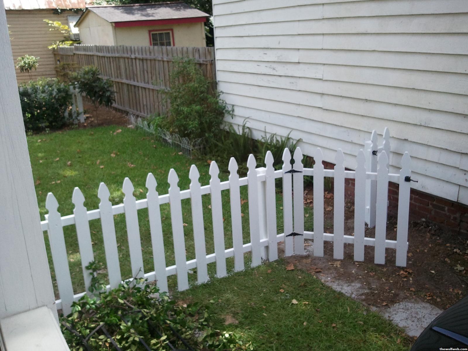

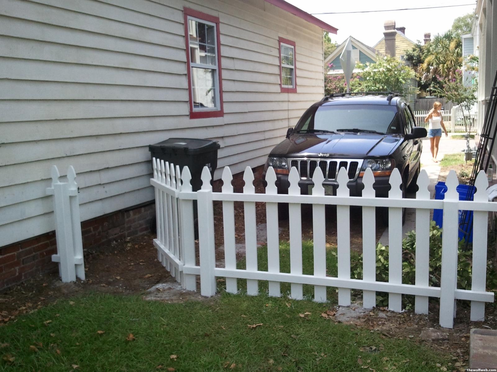

Finished painting the fence today:

I like the fence, but that'll be a pain to edge around.
7/25/2012 6:50:29 AM
^ Was a concern of mine...but I took a weed-eater to it yesterday and it looked fine. I'm anal about my yard, so something may change in the future, but it will do for now.

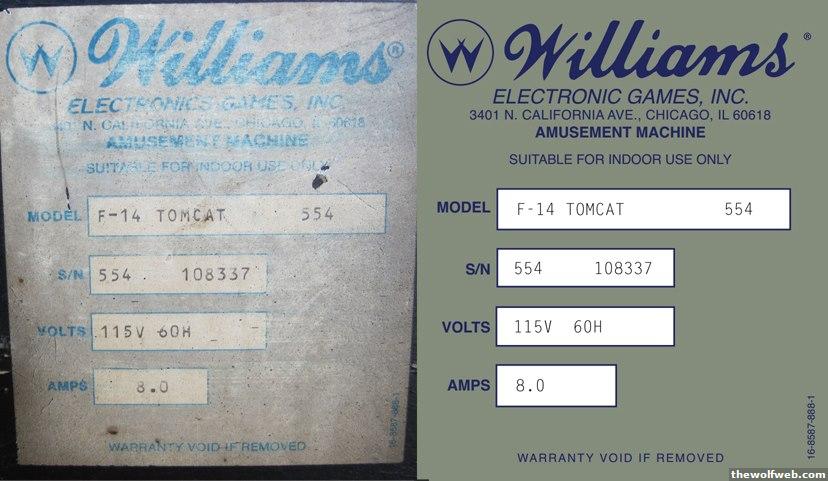

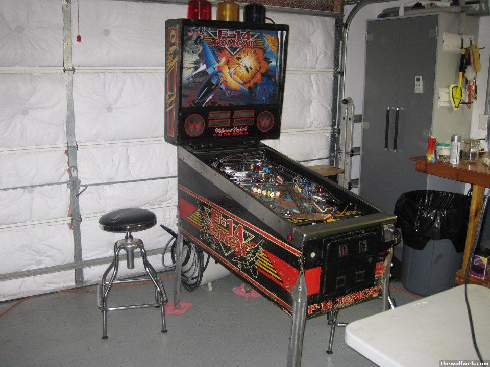

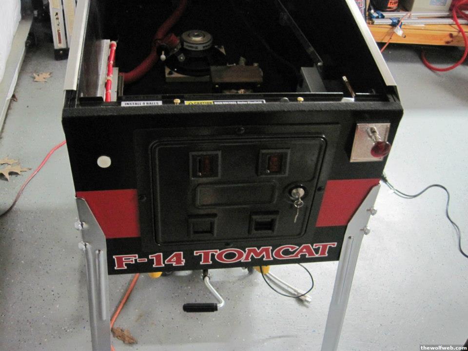

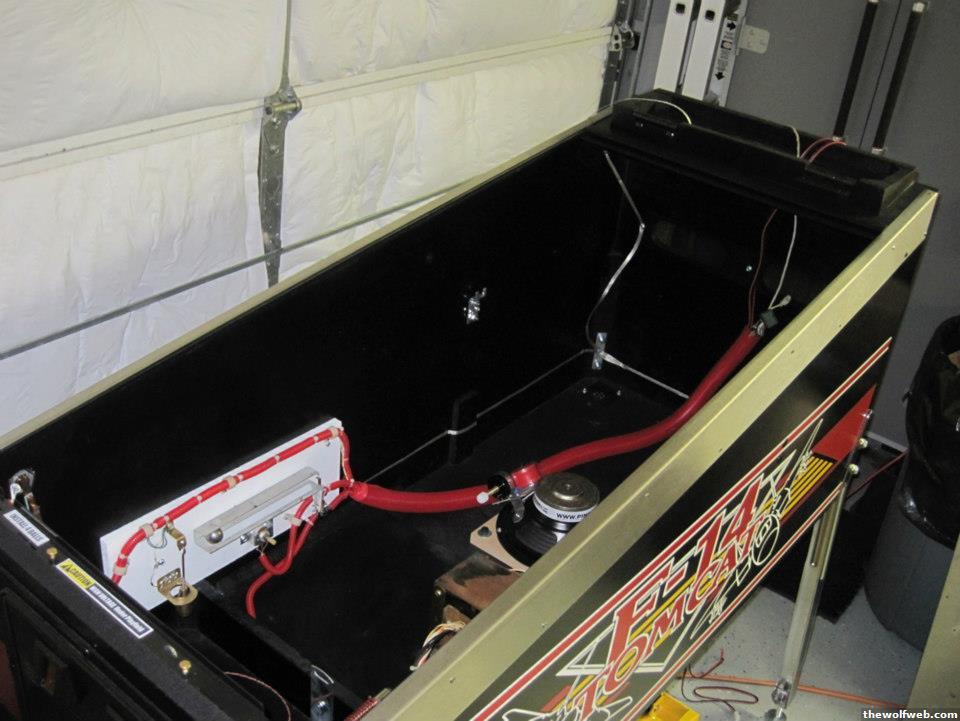

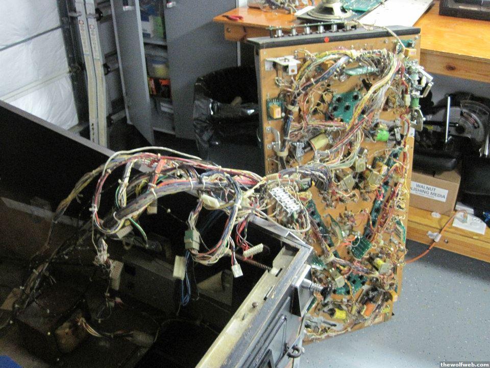

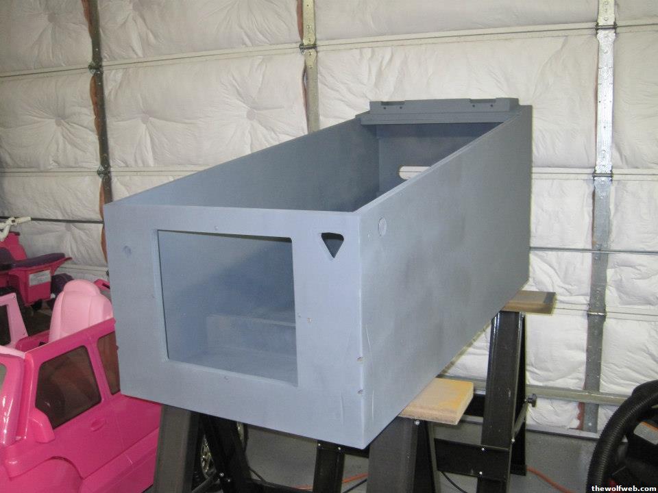

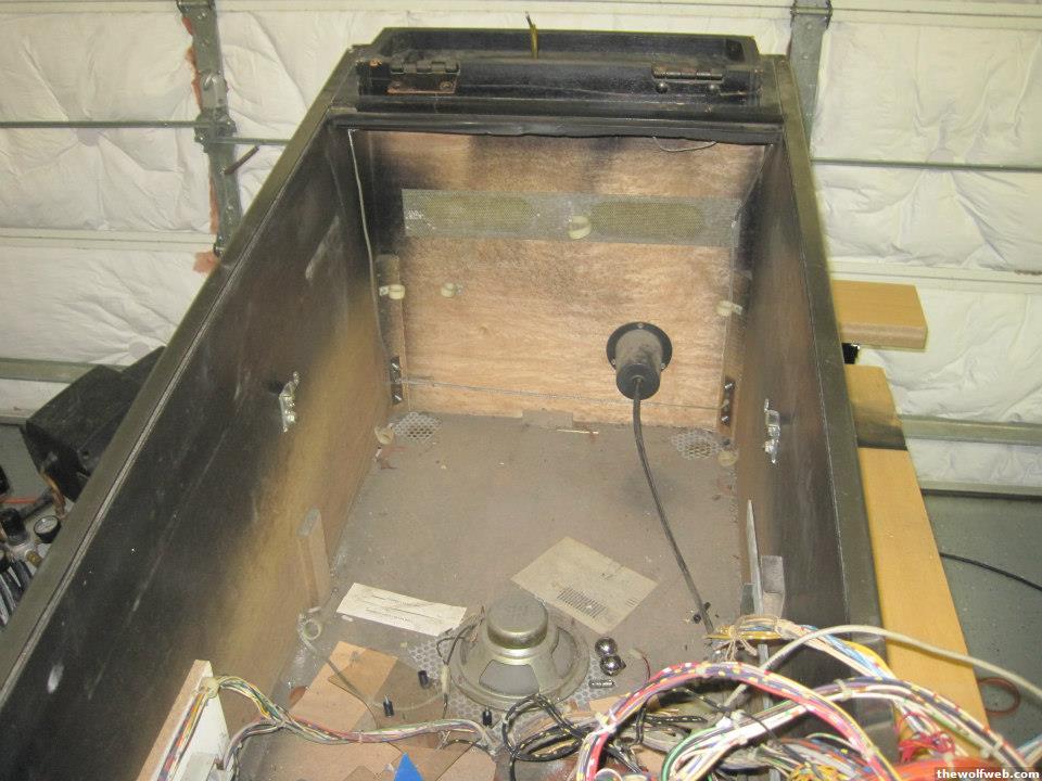

I've been working on another pinball restoration. This one was pretty bad off.
Here it is before I started restoring it, its really screwed up.
The inside of the cabinet:
The playfield pulled out:
An example of all of the labels I have to remake in photoshop:

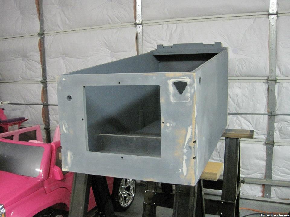

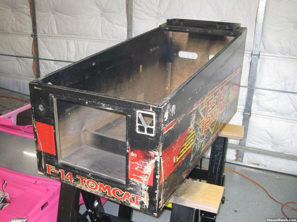

The cabinet with all the parts off:

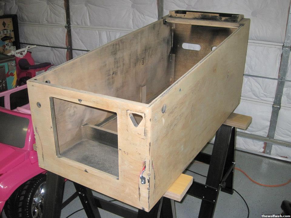

Sanded to bare wood:
Primed:
Filled/sanded:

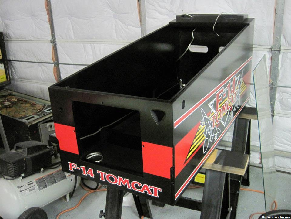

Painted, graphics on, and starting to put the ground strap back in:

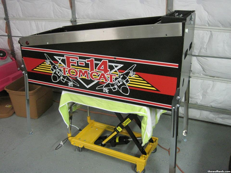

New siderails and legs are on:
Coin door, plunger, start button, and a bunch of the guts back in:
More of the guts back in, including upgraded subwoofer:

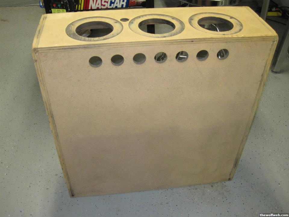

The backbox sanded to bare wood:
I have a lot more work to go, and will post some more stuff as I make progress on the playfield, etc.. It's been stripped, all the artwork has been repainted by hand, and then clearcoated. Working on putting the thousands of components back on it now, as well as painting/fixing the backbox/motherboards.
